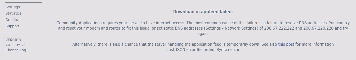

Hi my unraid server 6.11.5 losses DNS after a few minutes.
If i stop docker and vm Manager, then change dns IP in Network settings,
DNS works again,. But after a few minutes DNS getting lost again.

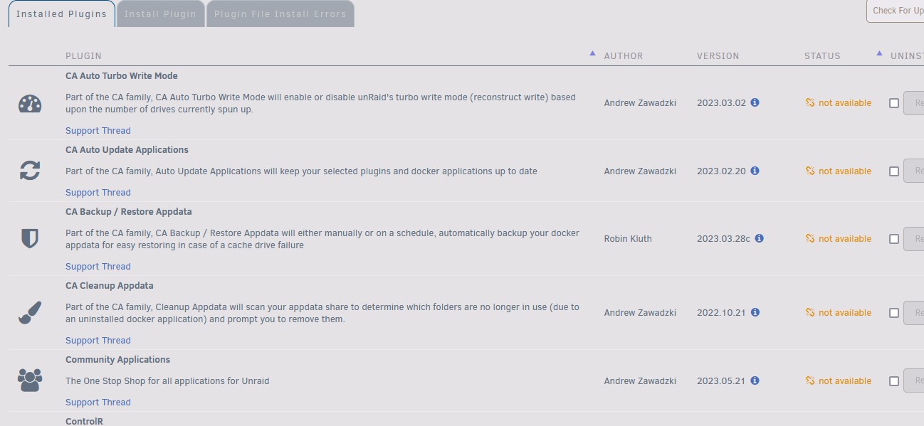

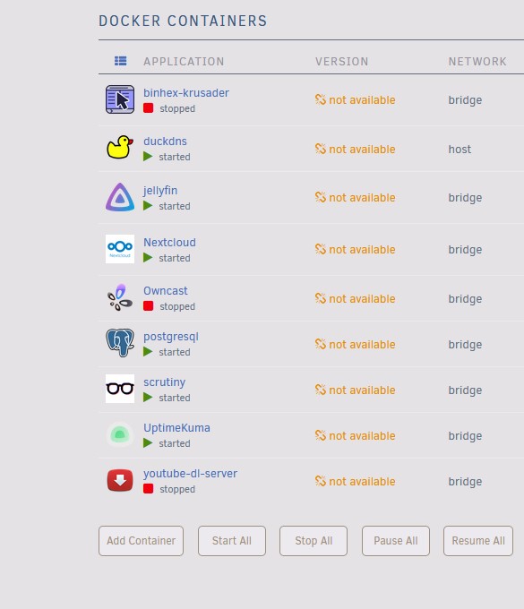

I'm having the exact same problems as you, I have tried Versions: 6.11.2, 6.11.5 and Version: 6.12.0-rc8.   I have noticed via other posts that people with HP Microservers are complaining about this, I have an HP Gen 8 Microserver.

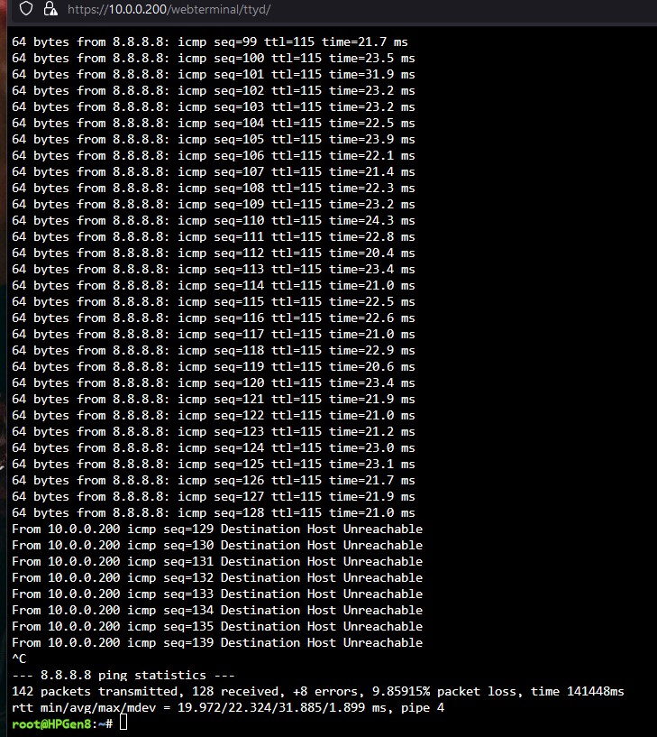

Also tried the following DNS, access is availble but I cannot update anything, ping works for a couple of minutes then "Destination Host Unreachable" :-
194.168.4.100, 194.168.8.100 which are Virgin Media.
1.1.1.1 and 1.0.0.1 Cloudflare
8.8.8.8 and 8.8.4.4 Google
As well as the suggested opendns  in DNS post on the forum.
Works and then stops working.  Syslog seems to be full of  bootstrapDNS("derp5d.tailscale.com", "43.245.48.250") for "log.tailscale.io" error: Get "https://derp5d.tailscale.com/bootstrap-dns?q=log.tailscale.io": context deadline exceeded and others, might not be related, I have removed tailscale.
Lastly, I can ping the server from any device and the server can ping the gateway.
64 bytes from 10.0.0.1: icmp_seq=24 ttl=64 time=2.03 ms
64 bytes from 10.0.0.1: icmp_seq=25 ttl=64 time=4.37 ms
64 bytes from 10.0.0.1: icmp_seq=26 ttl=64 time=2.70 ms
^C
--- 10.0.0.1 ping statistics ---
26 packets transmitted, 26 received, 0% packet loss, time 25029ms
rtt min/avg/max/mdev = 2.033/3.492/6.210/1.207 ms
root@HPGen8:~# dig @8.8.8.8 google.com
;; communications error to 8.8.8.8#53: timed out
; <<>> DiG 9.18.12 <<>> @8.8.8.8 google.com
; (1 server found)
;; global options: +cmd
;; no servers could be reached
I have tried everything suggested by the developer in this post:-
I'm baffled.
