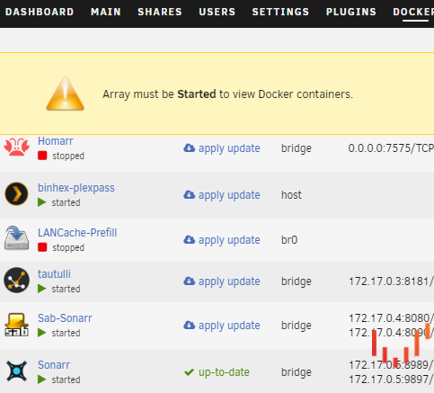

*The "Docker" tab always shows the "Array must be started" warning, but the containers all start and function.

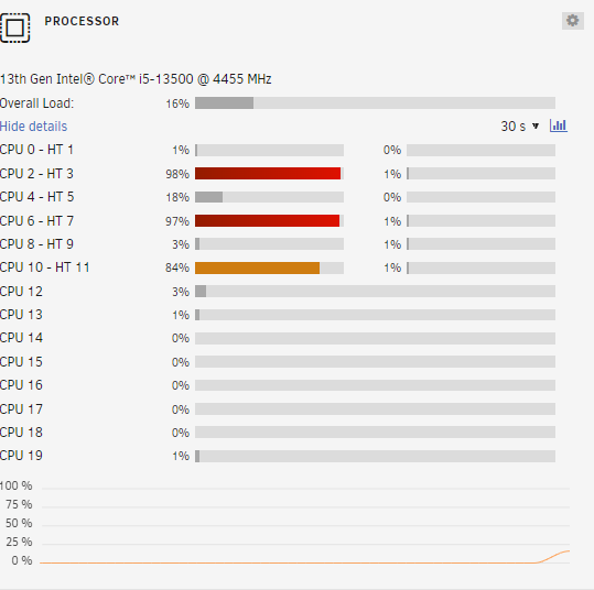

*The GUI loads with a few seconds of system stats, like the CPU usage, but then freezes and never updates again until reboot where the problem repeats itself.
