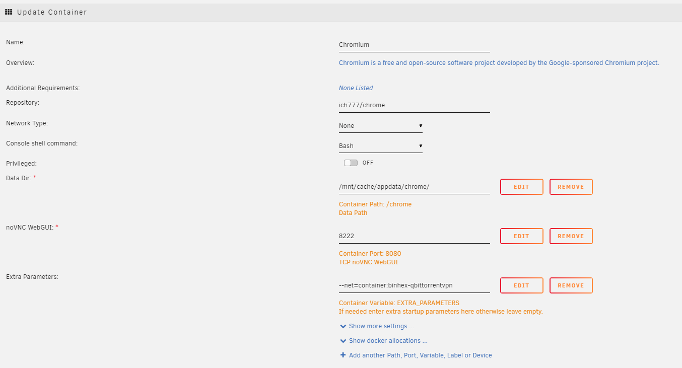

September 13, 20233 yr Community Expert Set the speedtest container to networktype = none and add this to the extra parameter --net=container:binhex-delugevpn (replace "binhex-delugevpn" with any container you want, i.e. "binhexvpn")
September 13, 20233 yr Author That's what I tried but none of the speedtest dockers or chrome docker will connect when I do that.

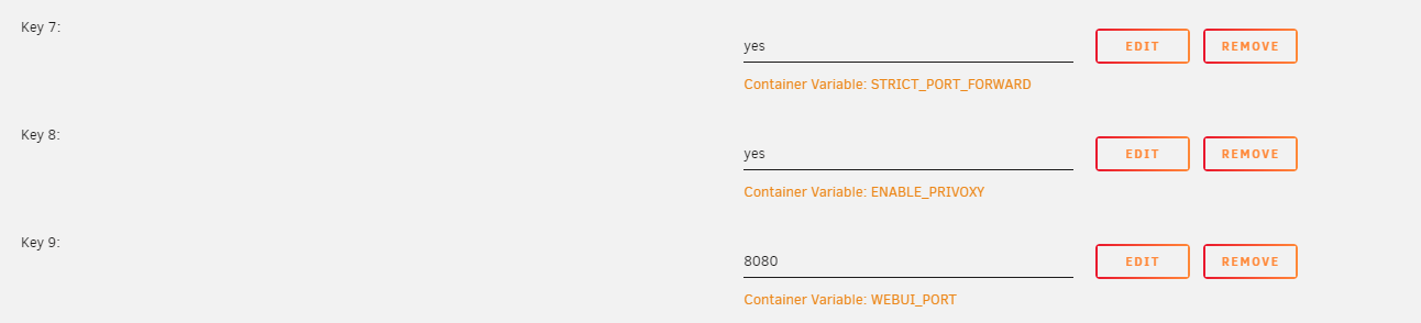

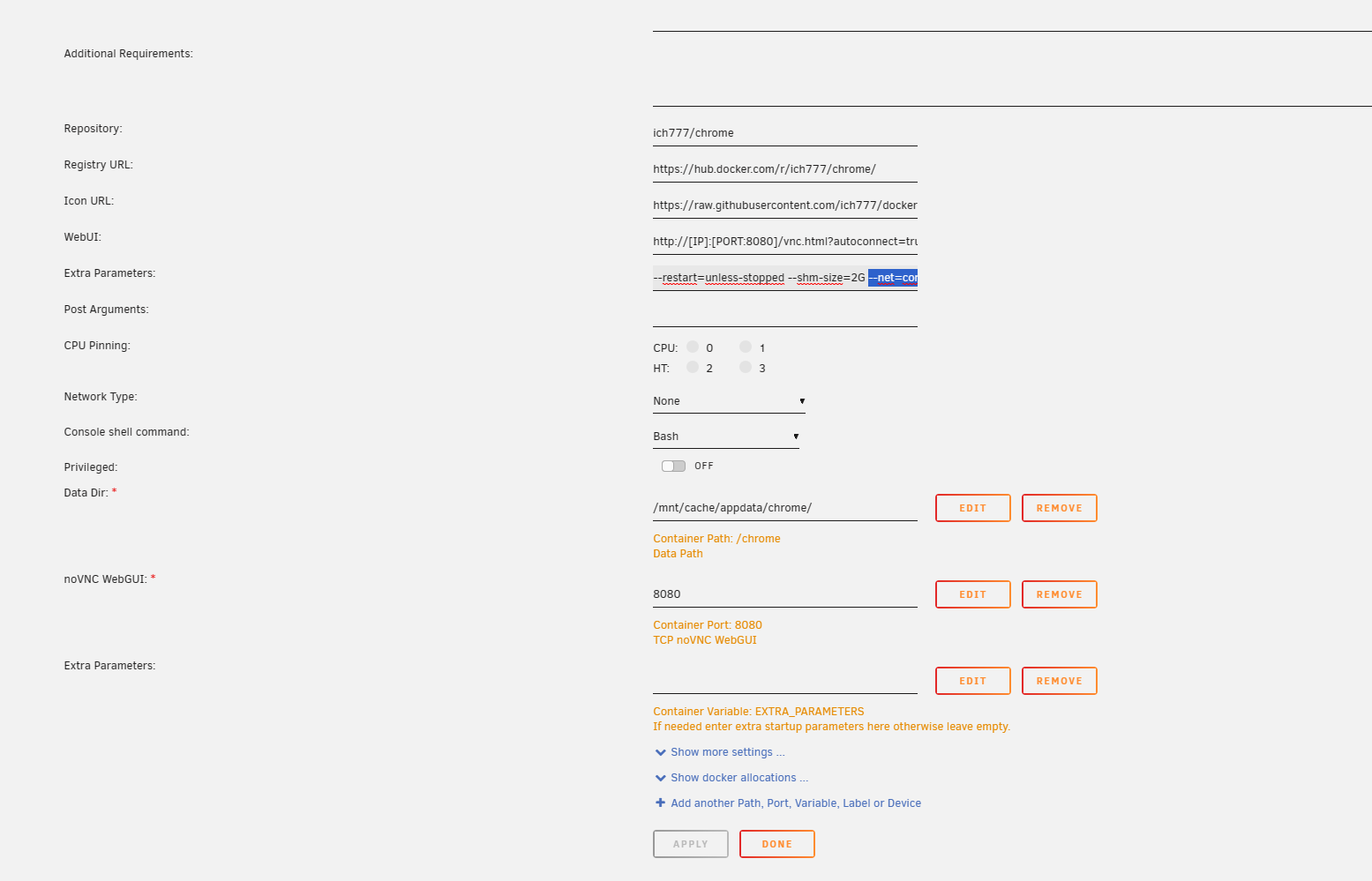

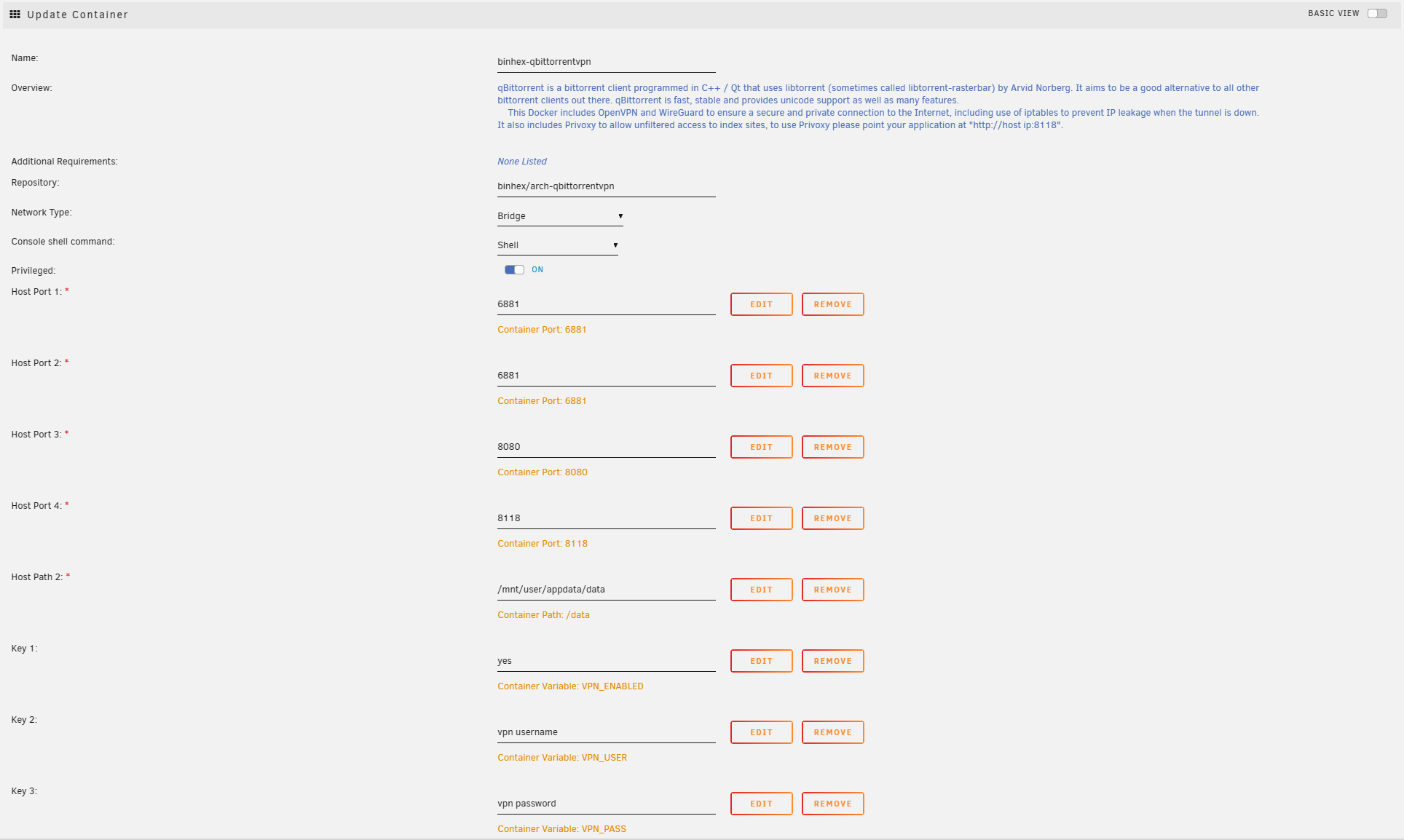

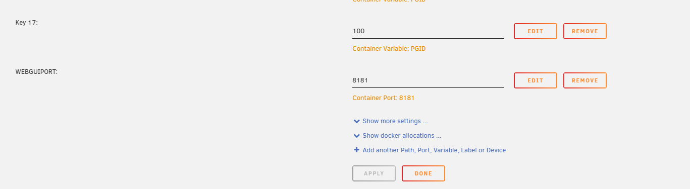

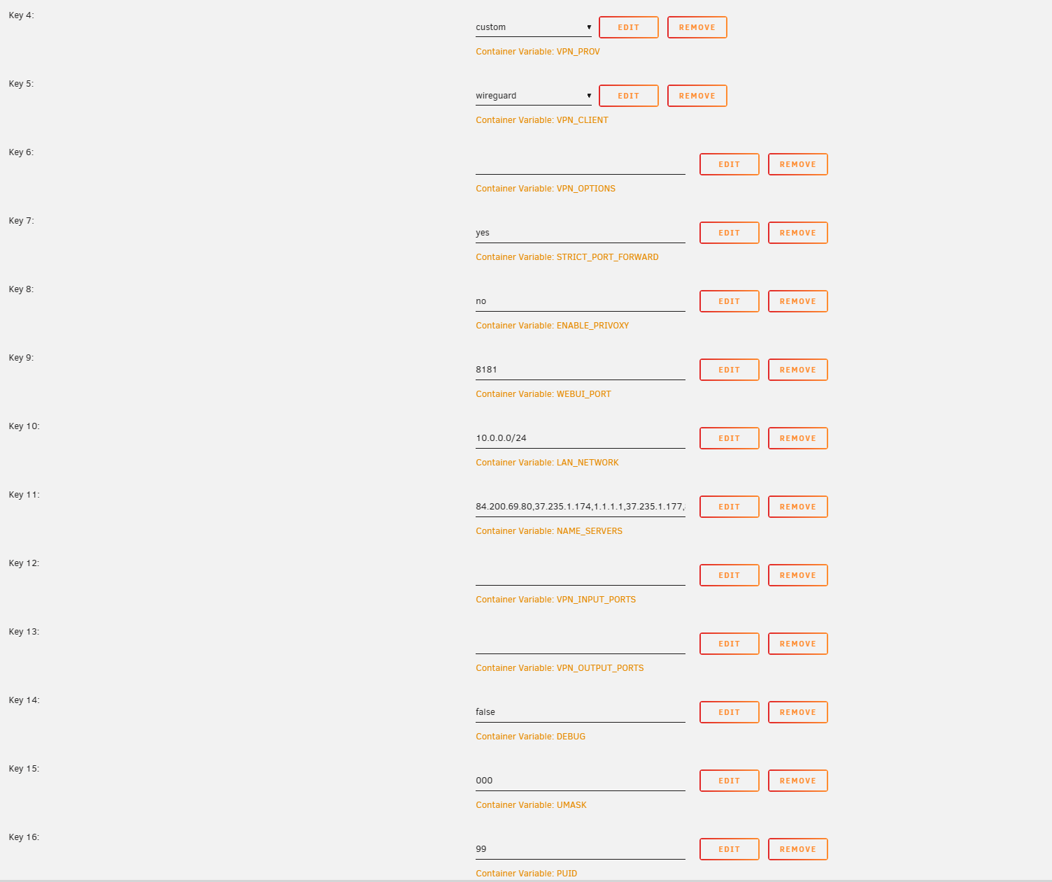

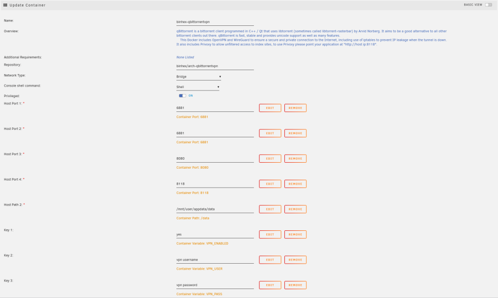

September 13, 20233 yr Community Expert Solution So, ive set it up on my end for visual guidance. Binhex Chrome: What you need to enter into the binhex console iptables -A OUTPUT -s 172.17.0.0/16 -d 10.0.0.0/24 -o eth0 -p tcp -m tcp --sport 8080 -j ACCEPT && iptables -A INPUT -s 10.0.0.0/24 -d 172.17.0.0/16 -i eth0 -p tcp -m tcp --dport 8080 -j ACCEPT Change the 10.0.0.0/24 to whatever your network is. 192.168.0.0/24 for example. Now you can access your Binhex Interface on UNRAID-IP:8181 and your chrome docker is UNRAID-IP:8080 From the chrome docker you can just access the rest from the 172.17.0.X:PORT As mentioned before, if you go the privoxy route, which i highly recommend, it looks like this: You change in binhex the Key 8: (ENABLE_PRIVOXY) to "yes" you open your firefox, chrome, edge, whatever. Go to setting and search for "Proxy" You set the http proxy to your unraidip:8118 now your browser gets routed through the vpn container and can access 172.17.0.X natively and you dont need to use the iptables command on every binhex-container start. Edited September 13, 20233 yr by Mainfrezzer

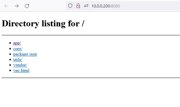

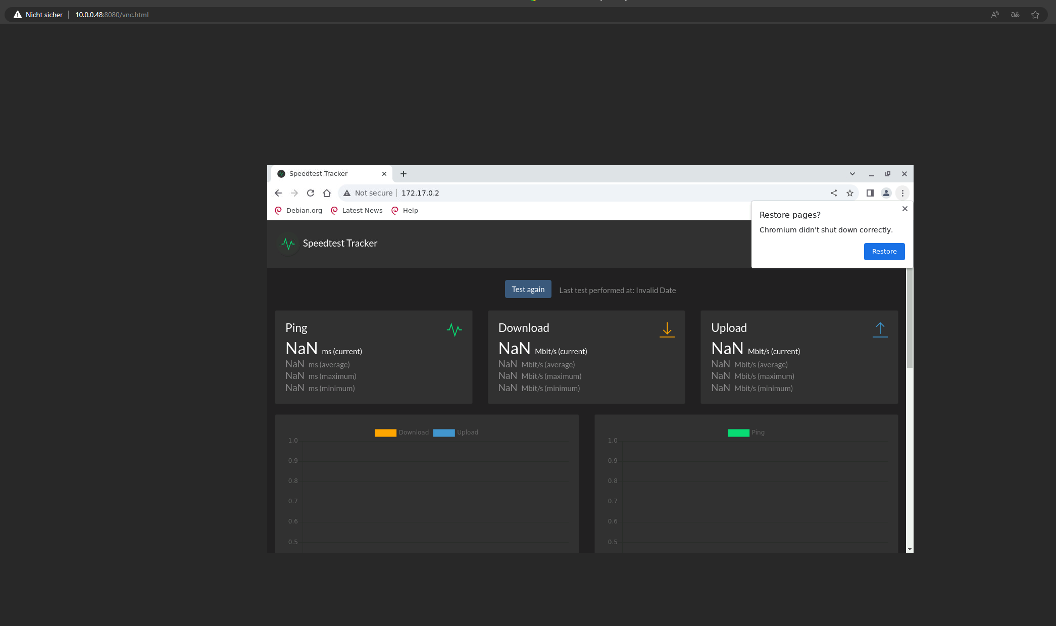

September 13, 20233 yr Author got everything cloned like yours. qbit runs in :8181 chrome opens with :8080 but give me this...
September 13, 20233 yr Author got it, had to type in 10.0.*.*:8080/vnc.html. just doing 8080 didn't work
