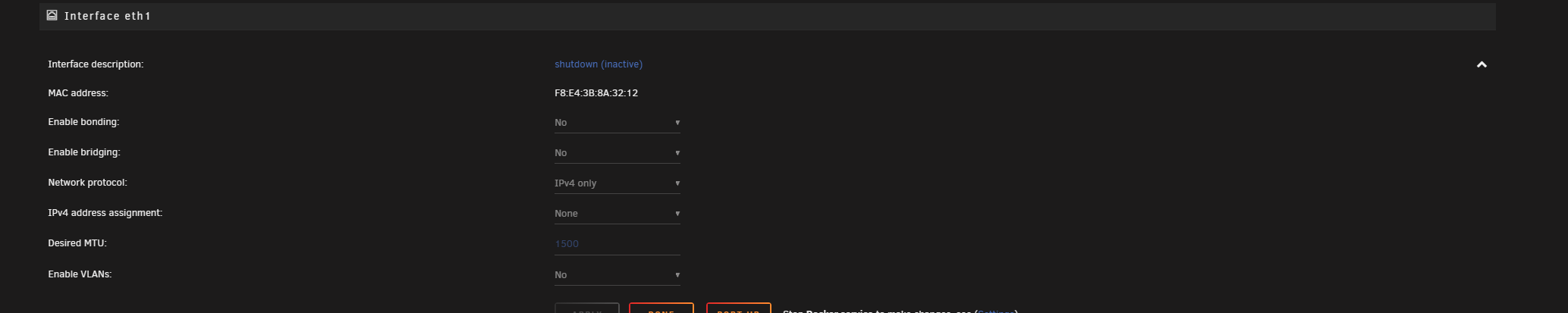

your nic, which i assume is in this case eth1 should show up there and then youll have this option there
that turns eth1 into br1
this is how its looking for me right now
Edited by Mainfrezzer
Oh Geez....That was an easy fix, didnt realize that function created the br. It appeared when i looked in that, that it just linked existing interfaces. Thank you alot for the assistance.

you can link multiple nics together so that a vm on eth0 can talk to a container on eth1 but you can also just run 1 nic as bridge so they, docker and vms, can talk with each other.
