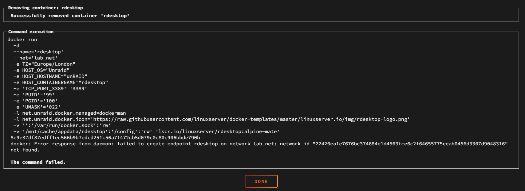

October 14, 20233 yr I have a custom docker network created with; docker network create -d ipvlan \ --subnet=192.168.100.0/24 \ --gateway=192.168.100.1 \ -o ipvlan_mode=l2 \ -o parent=virbr1 \ --opt com.docker.network.bridge.enable_icc=false \ lab_net virbr1 is a libvirt network used for my VM's. Everything works if it all comes up in the correct order but when I reboot unraid the docker network is created (I have "Preserve user defined networks" enabled) but it doesn't function and the containers using it wont start. I have to remove the network and recreate it again manually (along with the containers using it) before the containers will start. I'm assuming this is because virbr1 probably doesn't exist when unraid starts docker. How can I fix this so it survives a reboot? Edited October 14, 20233 yr by L0k1

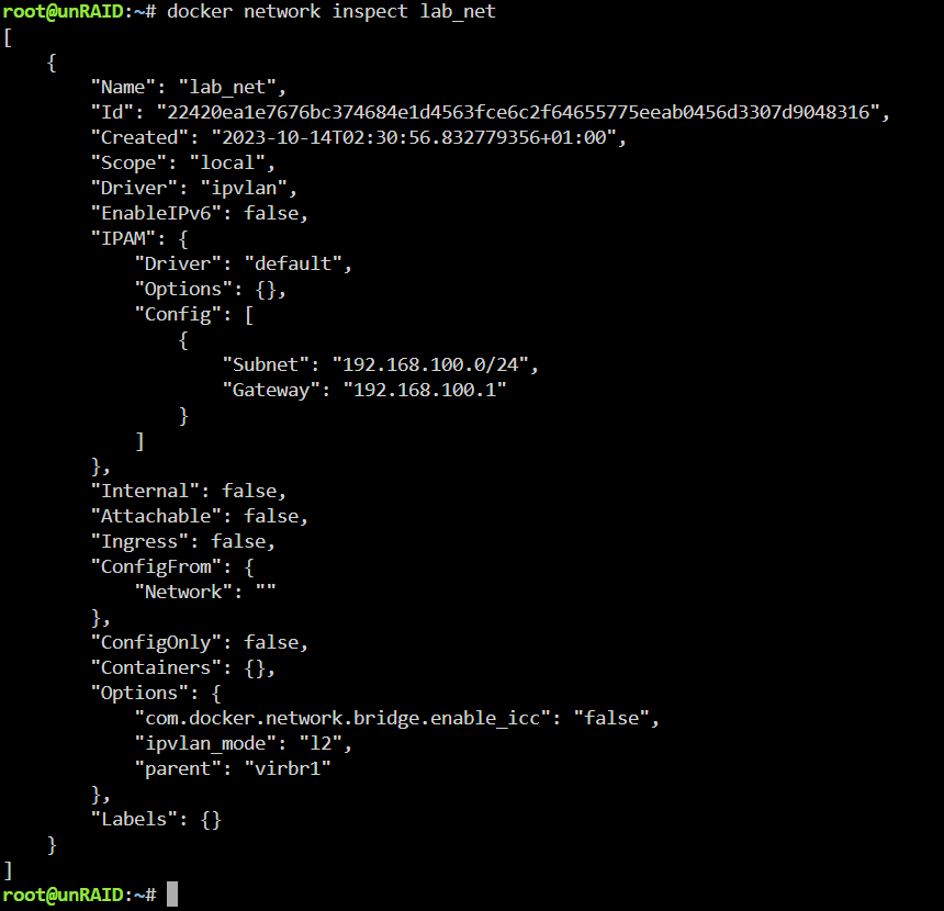

October 14, 20233 yr Author 21 hours ago, L0k1 said: I'm assuming this is because virbr1 probably doesn't exist when unraid starts docker. How can I fix this so it survives a reboot? I think I was wrong about this being the problem, if it was then restarting docker when libvirt is already running would solve it, it doesn't. After restarting docker (or rebooting) when I try to start the container it says "server error"; Trying to recreate the container gives me "network id not found"; The network does exist; I have to recreate both the network and container to get it working again.
