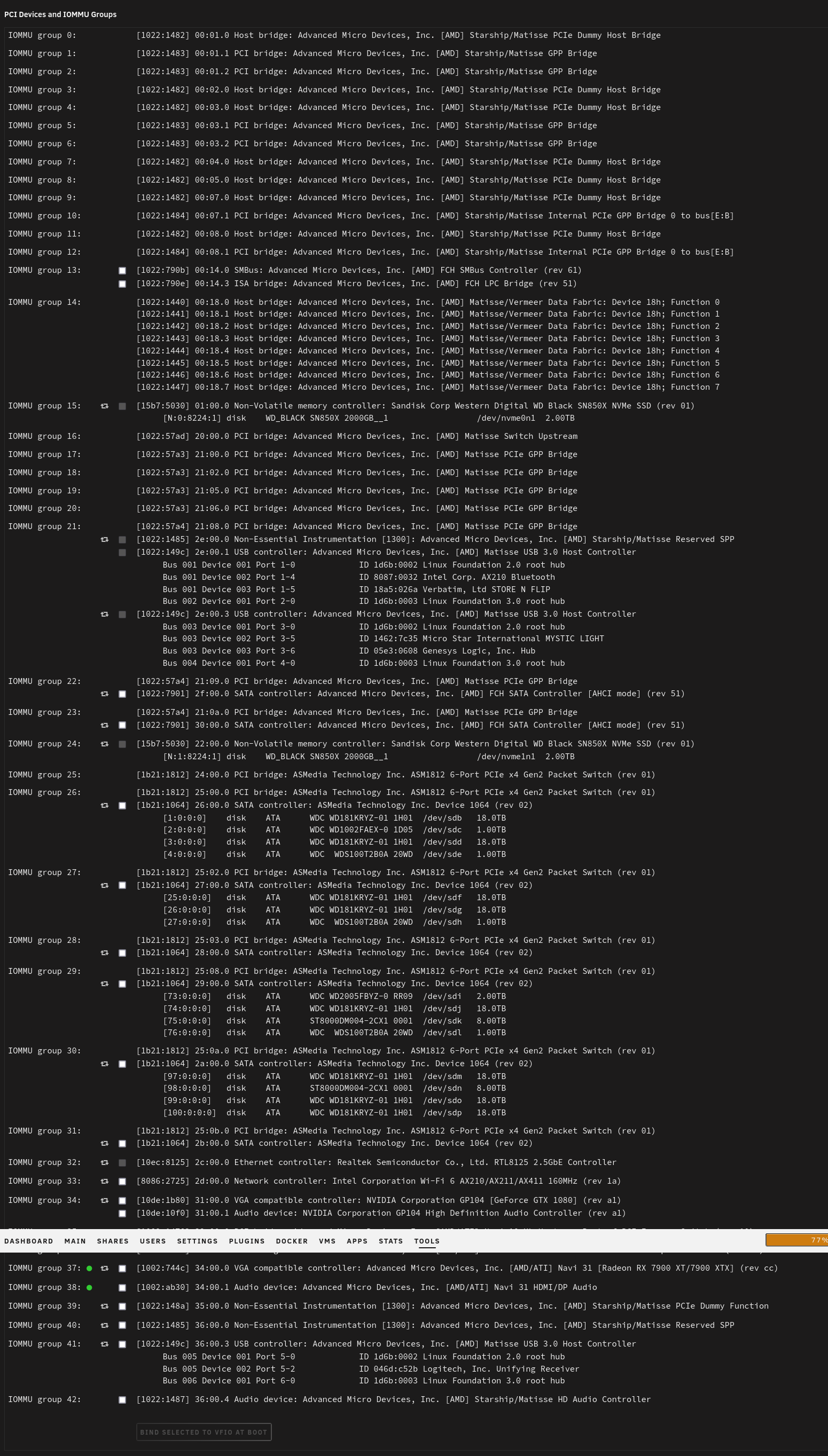

Below are my IOMMU groups. From what I remember in all the vids I have watched, these should be fine. I have both gpus seperate enough to not be an issue. please let me know if I have that incorrect. IOMMU info also here in text IOMMUsince screen cap didnt get all relevant info.

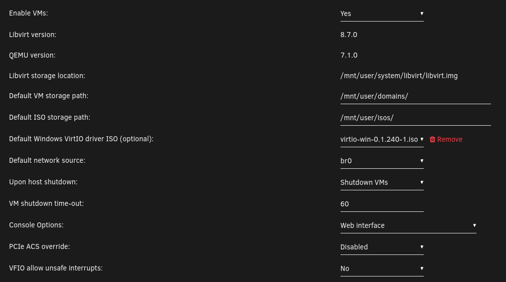

I have had several different configs in vm manager settings for acs override. as i said above, i dont think my iommu are a problem, so I currently have acs override disabled.

I'm no expert but from your IOMM groupings it looks like you dont have the Radeon GPU binded to the VFIO. Select the two boxes next to the Green dots and reboot your server. Select the GPU in your Linux Mint template and attempt to boot.
I too have two GPUs in my setup, one 3080 and one 1080. I have the 3080 not binded to the VFIO i use it with the steam headless docker I have the NVidia plugin installed so it sees only the 3080 to use with docker. I have the other GPU 1080 binded to the VFIO to use with VM's, this does not show in the nvidia plugin.
