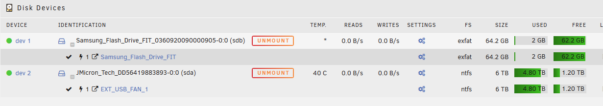

You should be able to address a Unassigned Devices mounted USB drive as /mnt/disks/DRIVE_MOUNT_POINT as in:
/mnt/disks/EXT_USB_FAN_1
