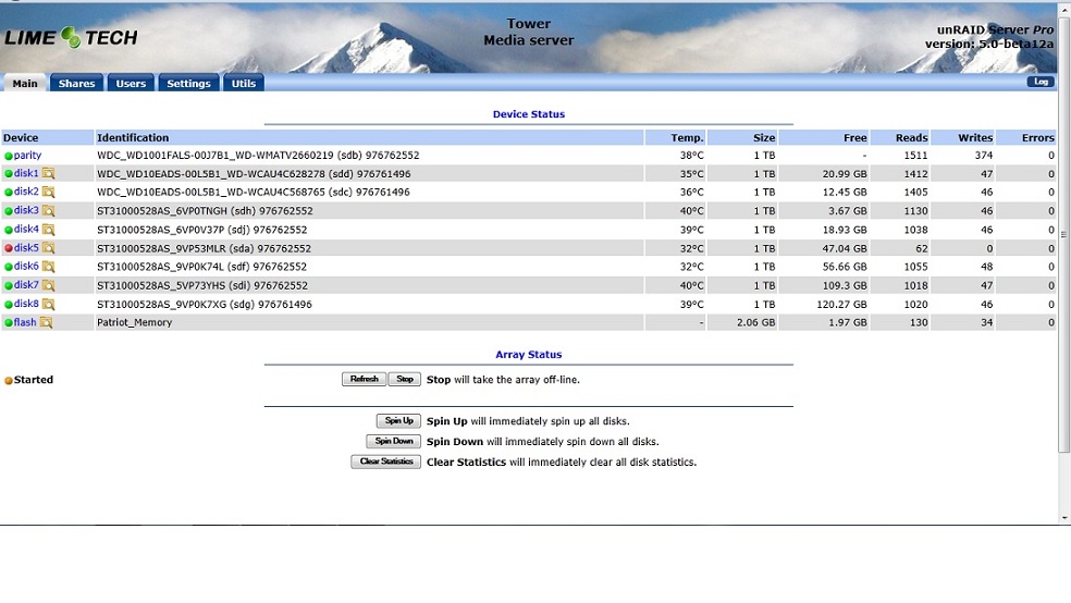

So i just did some upgrades to give more expansion of my Unraid. I just installed 2 x BR10i controllers. I moved about 5 disks to the new controllers.
Boot up the system, didnt see any errors (tho i'm not sure, i did make a post in Hard Drive section but no1 replies :( ).
Unraid found all the disks fine, so i started the array. All disks are green. So i started parity check. After 20 mins or so, i checked back the web gui and it didnt seem to respond. Plug a monitor in and i can still type command fine on the console. I went back and loaded the web gui again (opened a new browser), i found disk5 got a RED. No longer see parity check or sync.
I turned off the server and went to check cable etc...  Everything seems connected fine. Interestingly, disk5 is not on the new controllers. I started the array again. I checked the data (not all just random files) thro Windows Explorer on my laptop. I can access data on disk5 fine. Open some files and all looks fine.
Now i'm scared of whats happening? Did i mess something up?
Please check my syslog. It seems longer than normal.
Syslog attached.

I found this msg from the syslog
Sep 28 00:58:37 Tower kernel: ata1: softreset failed (device not ready)
Sep 28 00:58:37 Tower kernel: ata1: applying SB600 PMP SRST workaround and retrying
Sep 28 00:58:37 Tower kernel: Probing IDE interface ide1...
Sep 28 00:58:37 Tower kernel: ata2: softreset failed (device not ready)
Sep 28 00:58:37 Tower kernel: ata2: applying SB600 PMP SRST workaround and retrying
Sep 28 00:58:37 Tower kernel: ide2 at 0x1f0-0x1f7,0x3f6 on irq 14
Sep 28 00:58:37 Tower kernel: e1000 0000:05:00.1: eth1: (PCI:33MHz:32-bit) 00:11:0a:61:b7:c9
Sep 28 00:58:37 Tower kernel: e1000 0000:05:00.1: eth1: Intel(R) PRO/1000 Network Connection
Sep 28 00:58:37 Tower kernel: ata3: softreset failed (device not ready)
Sep 28 00:58:37 Tower kernel: ata3: applying SB600 PMP SRST workaround and retrying
Sep 28 00:58:37 Tower kernel: ata4: softreset failed (device not ready)
Sep 28 00:58:37 Tower kernel: ata4: applying SB600 PMP SRST workaround and retrying
From the syslog, i believe ata1 - ata4 are the onboard Sata ports supported by the southbridge, SB600. The disk5 is connected to port 1 of the onboard Sata ports. Its recognized as sda in Unraid
Current storage specs of the server:
+ 4 onboard SATA from SB600
+ 2 onboard SATA from JMB 363
+ 2 x BR10i controllers with 8ports each. i connect only 4 disks to one controller and 1 disk to the other one
