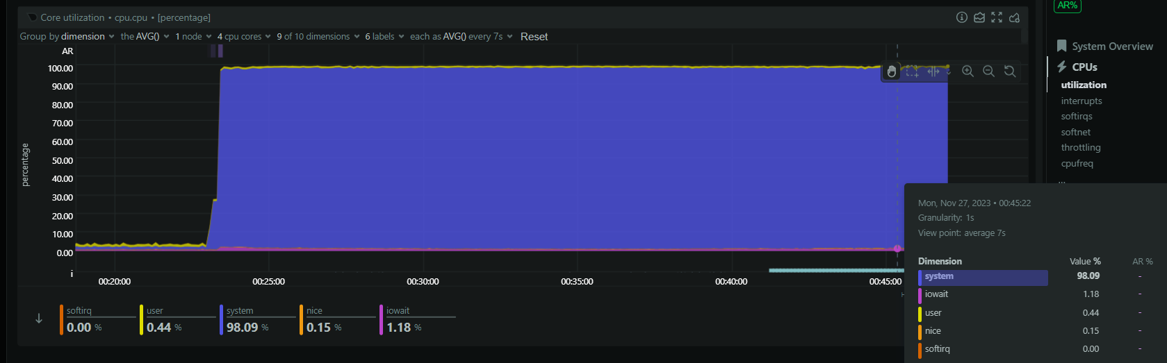

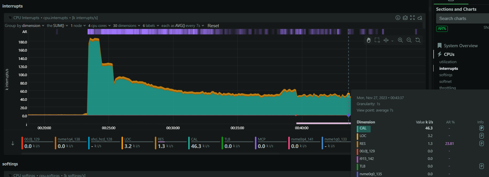

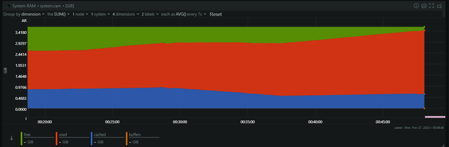

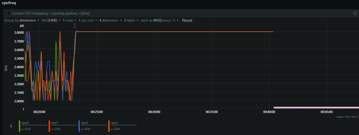

In Netdata, I can see that CPU and Memory utilization both climb and sustain right before each crash. Per netdata, it is NOT from any dockers utilization.  In order to minimize variables, I have also disabled all dockers except for netdata and plex. (All the arr's, downloaders, etc turned off)
Once the problem starts, if I happen to notice it in time, the Webui remains responsive, and sometimes even whatever dockers are on. But then eventually it crashes.  If I catch it early enough, I can do a reboot from the gui. If I don't catch it early enough, I have to power cycle the NAS.

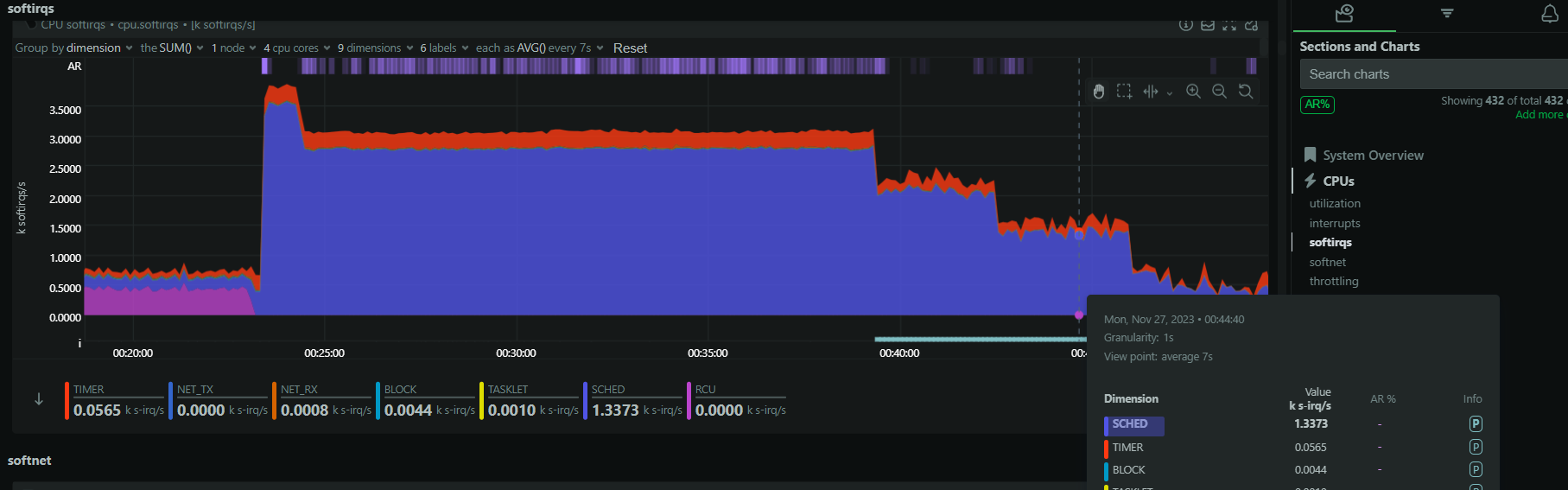

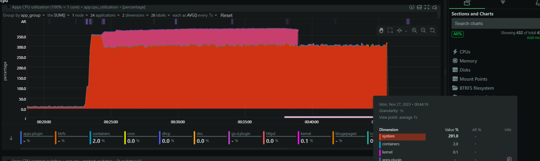

The "system" seems to be spawning processes and taking up CPU before the crash, but I don't know what the actual process is.

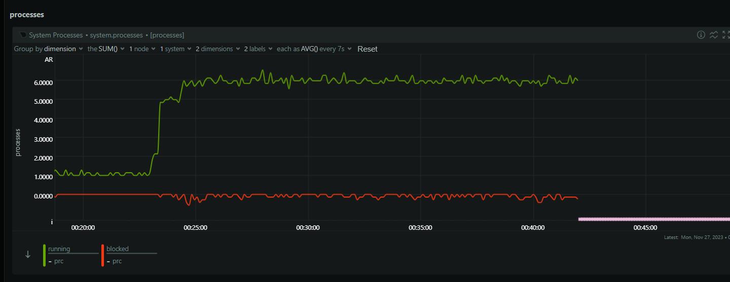

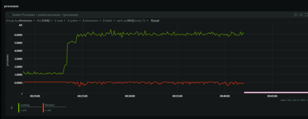

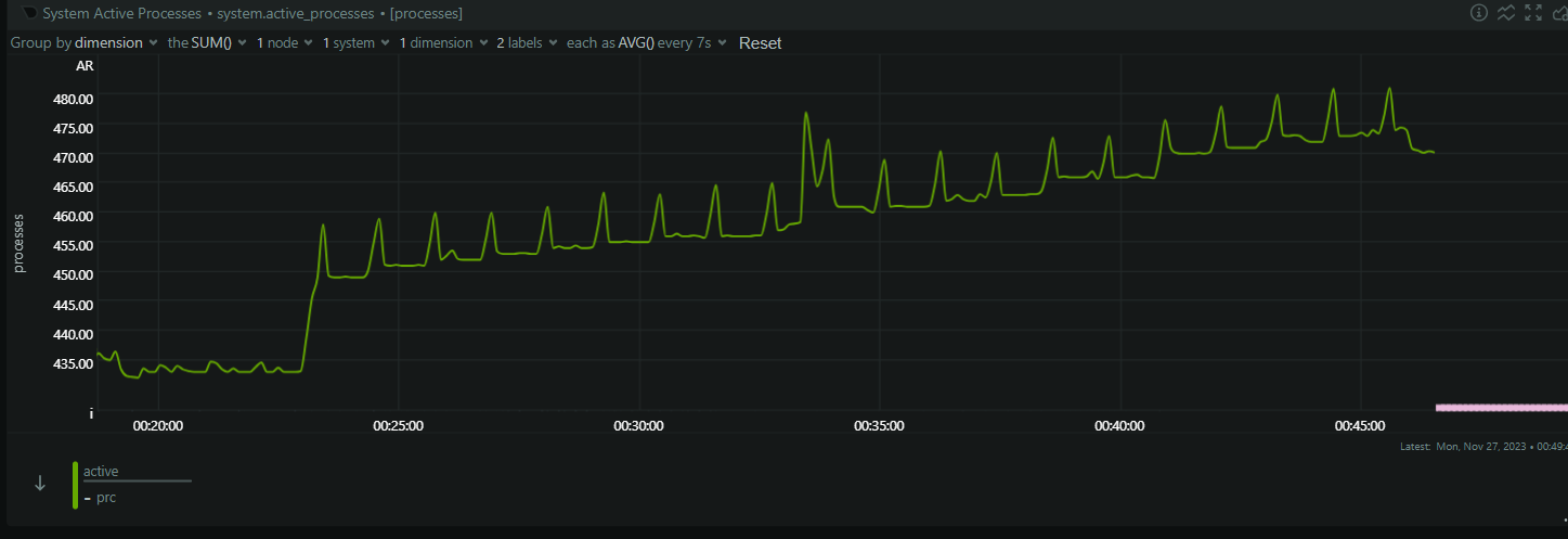

Something is spawning a lot of processes

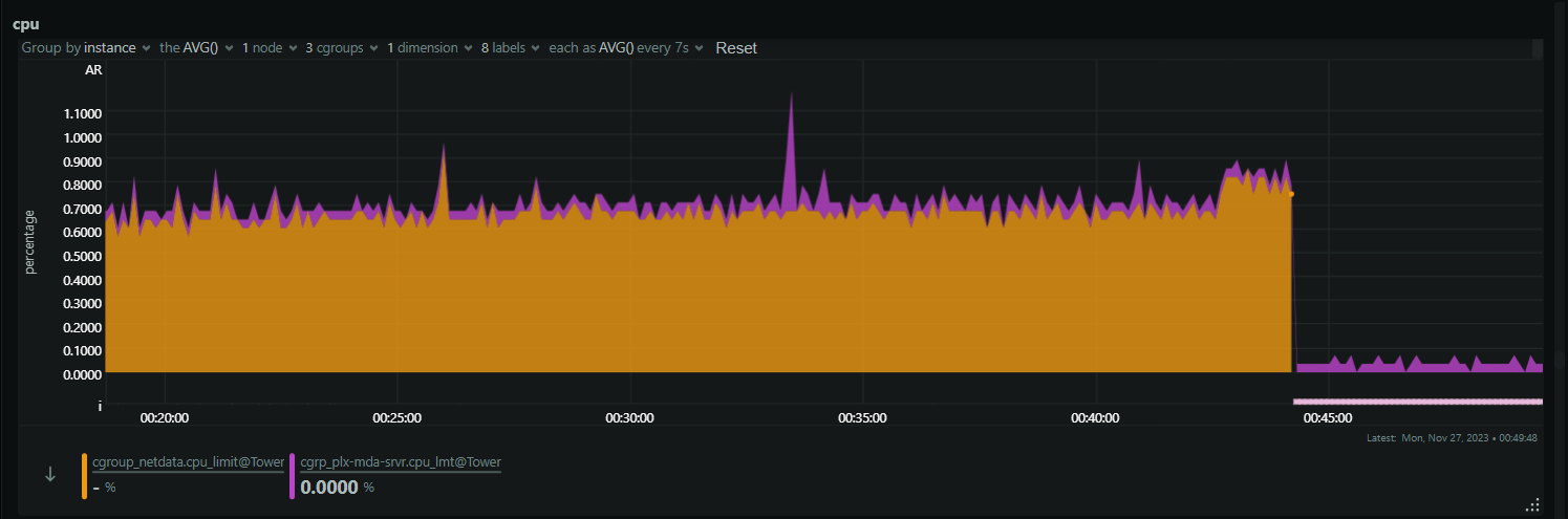

Notably plex and netdata had low cpu utilization during the window. image.thumb.png.99daf17942c30419d4500a24ecb4b7da.png
