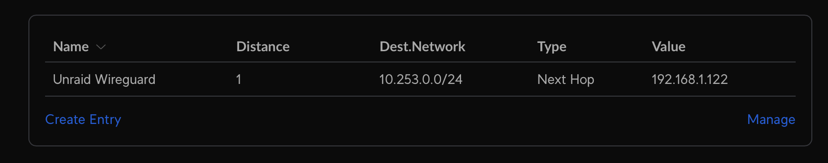

I have the following static route setup on my unifi router:
