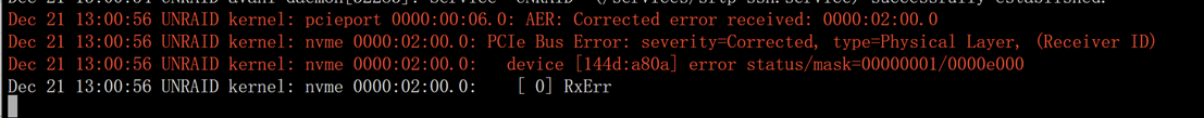

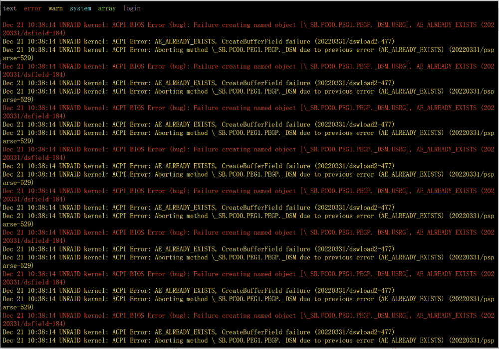

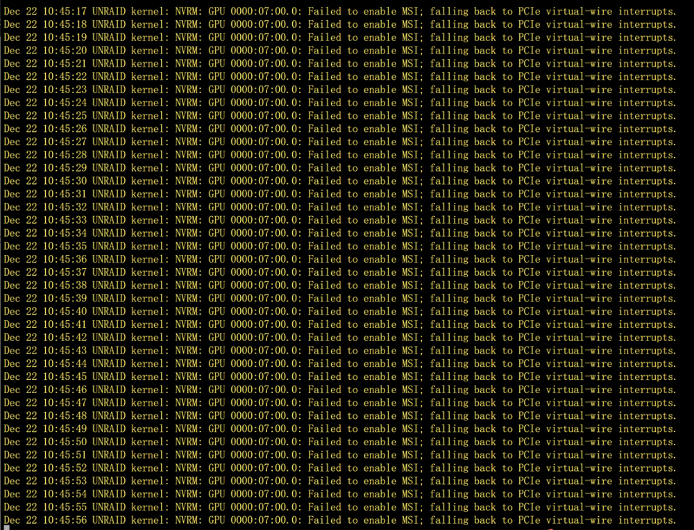

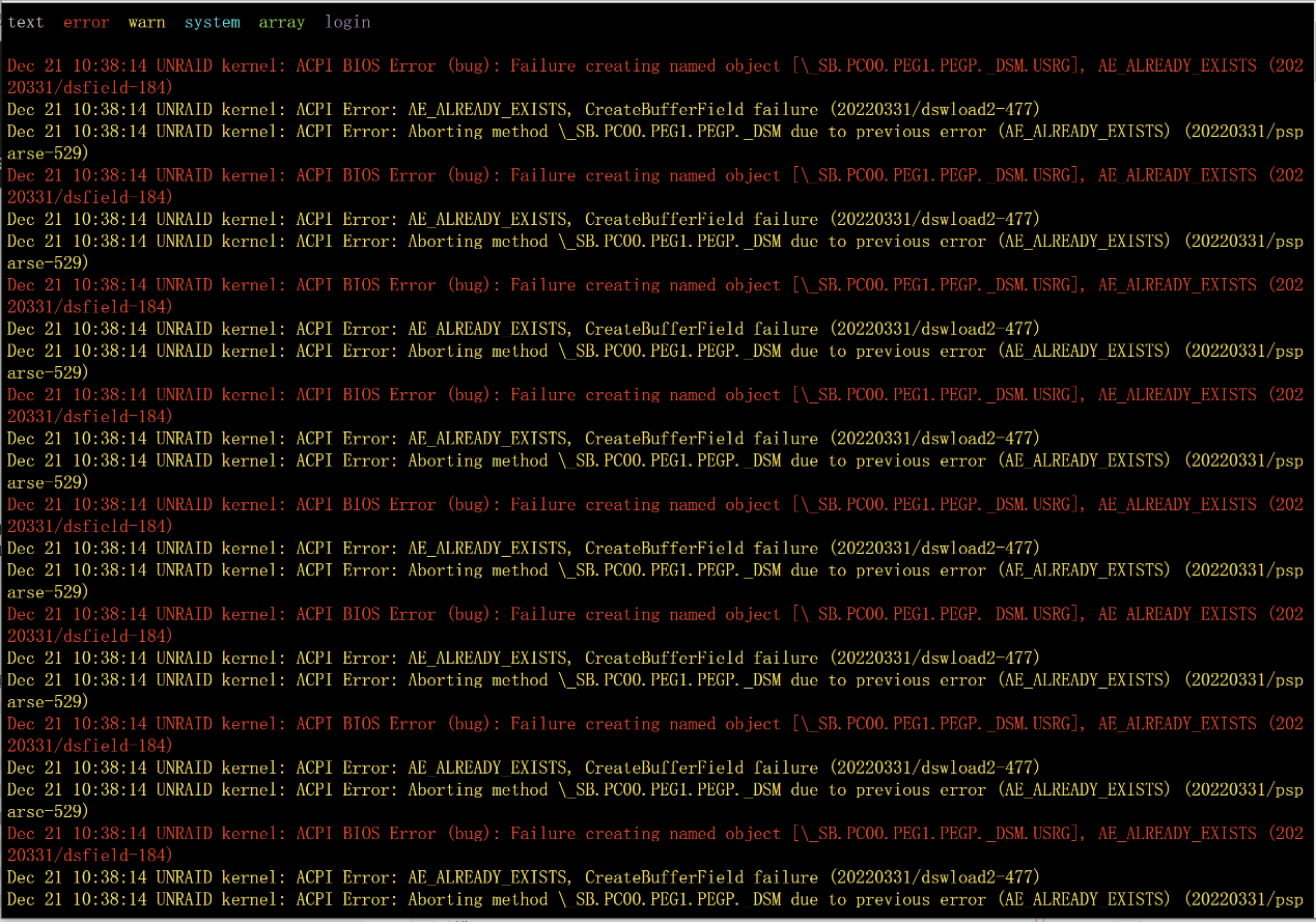

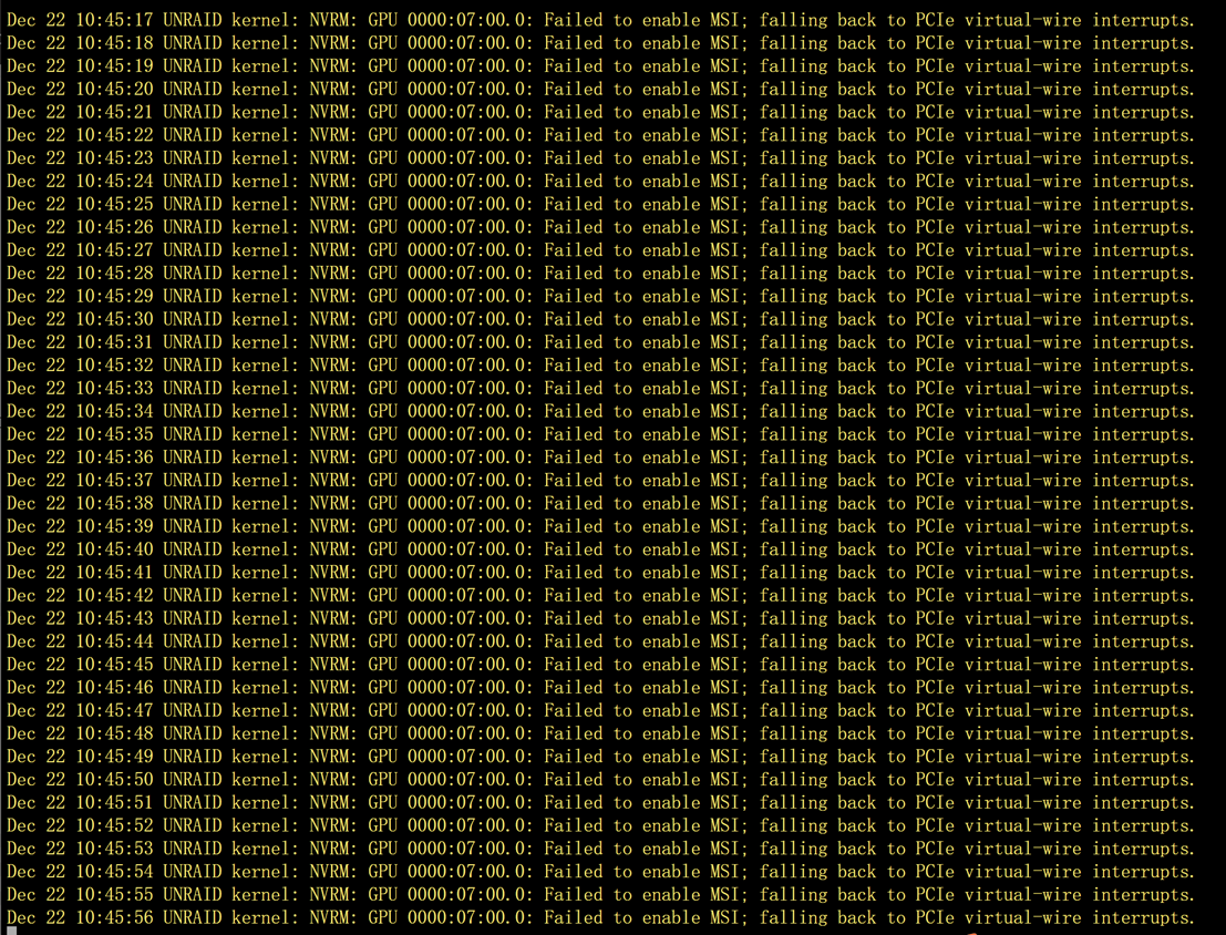

The first error should be the x16 slot of the graphics card. When it was switched to x4, there was no such prompt, but it was replaced with another yellow error
The same issue applies to switching to a new graphics card, NVIDIA 1060.
The red error at the end is unknown, and it is possible that the P4 graphics card was not installed and turned on.
