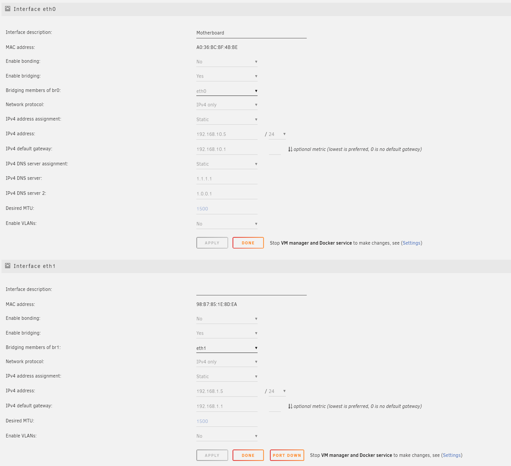

I have two active NICs192.168.10.0/24 - Main DMZ subnet
ETH0
Bridging enabled
Unraid IP: 192.168.10.5
All dockers except Omada use "bridge" and get assigned 192.168.10.5
192.168.1.0/24 - LAN subnet which "contains" the Omada switch and AP
ETH1
Bridging enabled
Unraid IP: 192.168.1.5

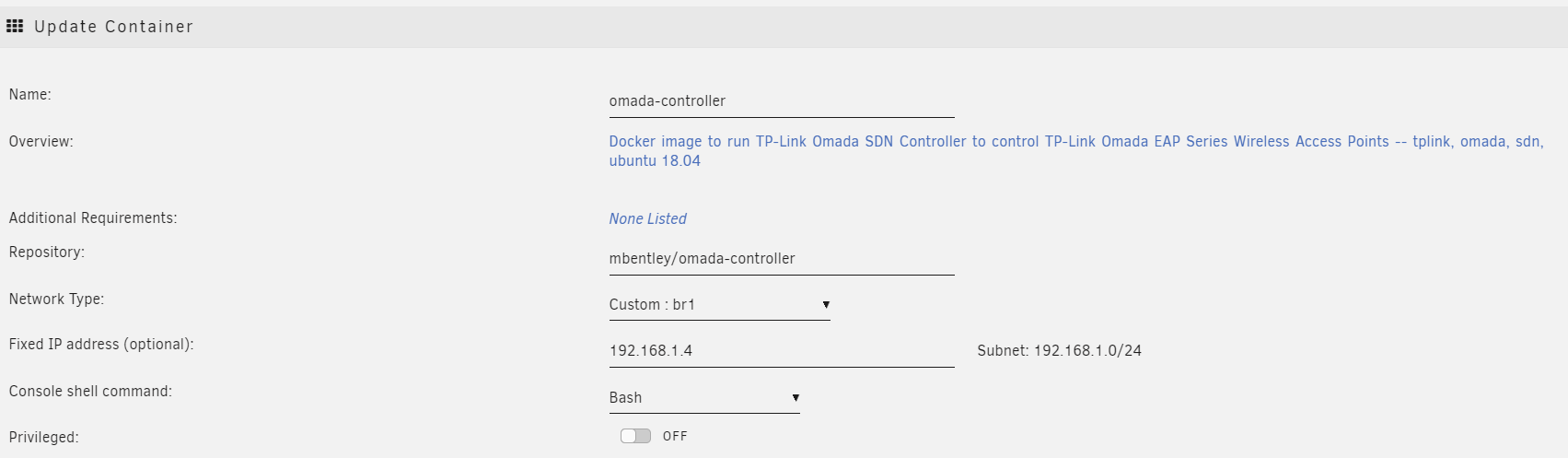

Omada configured as "BR1" with static IP 192.168.1.4

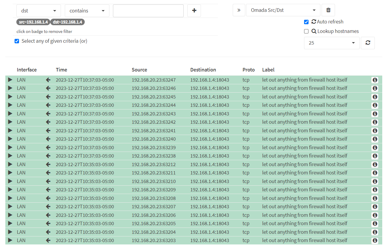

My desktop of the USER subnet can ping and access the Omada controller just fine
The Omada controller controls the switch and AP fine

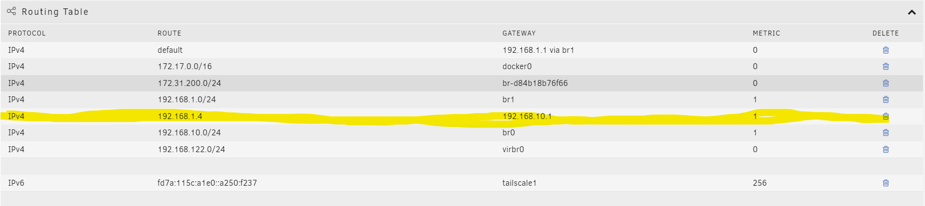

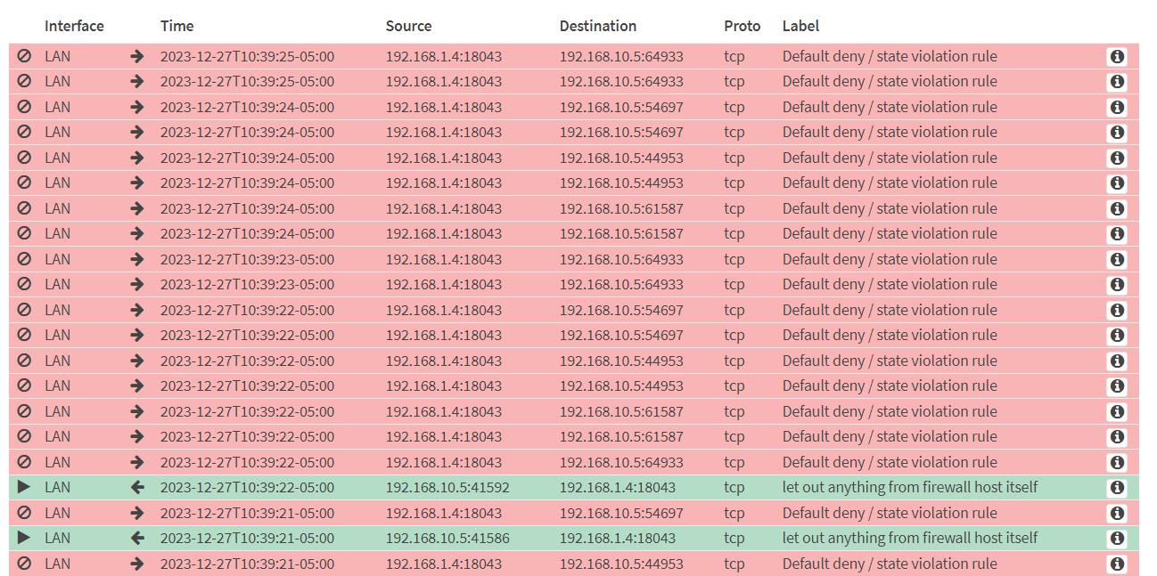

Unraid and all dockers couldn't ping the controller and other dockers couldn't talk to the Omada controller. I added a static route (yellow in the attached route screen capture) in the Network configuration to access 192.168.1.4/32 via the 192.168.10.1 gateway which fixed the ping issue but created a weird behavior in the firewall (see attached screen capture) and still doesn't allow any connection between dockers and Omada.
