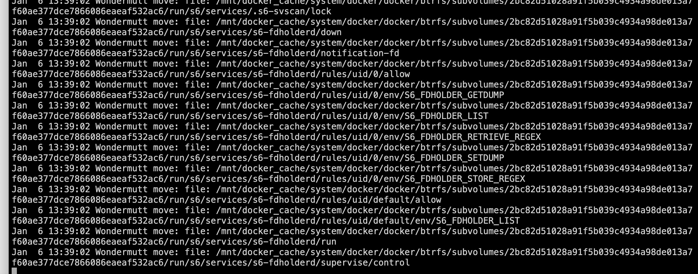

However, after a long time, when I return to the machine, mover is still running. I turned on mover logging before the operation, and I can see that hours before I returned to the server, mover's last log entry was an unknown btrfs file in the cache drive.Untitled.thumb.jpg.330f79fee5b203e0675b76a86ef208a1.jpg

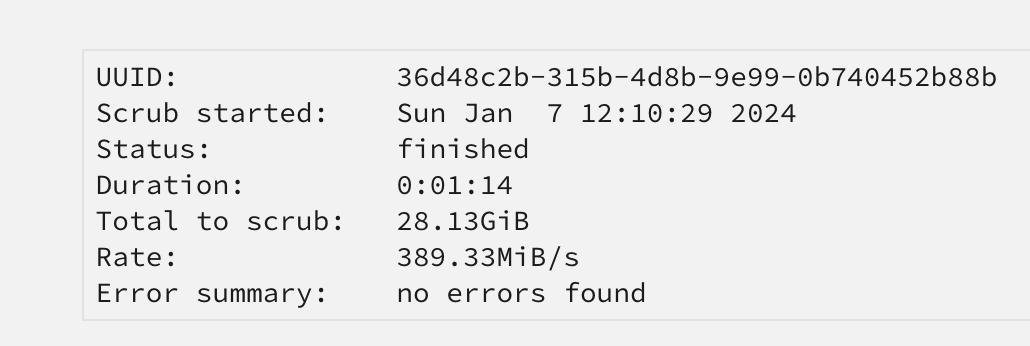

After a night of parity check (no errors), I did a btrfs scrub on the 2 cache drives I have (no errors.) image.thumb.png.cd6ea152def41fd0b8874e78761b055c.png
