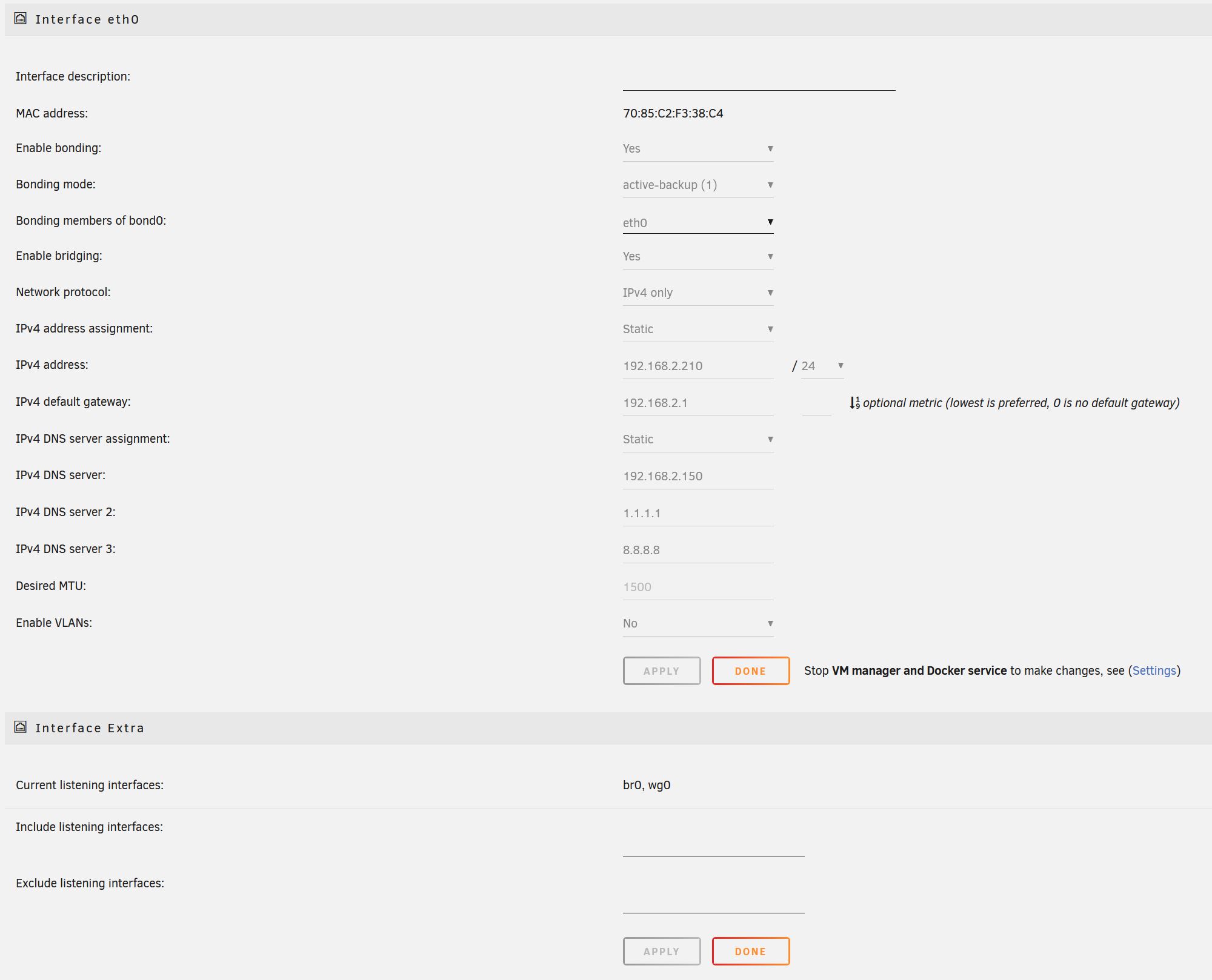

for about a week now my server has very weird connectivity errors.
I frist noticed it while being connected via wireguard to the unraid server, working via RDP connection on a PC in the network. The connecion dropped about once a minute and after about 20s i could reconnect.
Same issue when trying to go to the webgui.
Thoght mabye it could be a wireguard problem so i setup a PIVPN on a RaspberryPi in the same network and it worked like a charm fpr the RDP connection but same issues with the webgui. So something seems so be wrong with unraid itself.
A printer which puts scans in s SMB share failes every second scan because of "connection error".
I can't see anything in the logs.
Now the weird part:
from my Windows PC i have absolutely zero problems with my SMB shares and i can connect to a VM on the unraid server without any problems. The PC is on the same network switch as all other devices and the server itself.
The unraid connect addon dahboard shows the server as unavailabale most of the time too.
Attached are the unraid network settings, 192.168.2.150 is my pihole as the DNS server.
Anybody has an idea what could be wrong?
