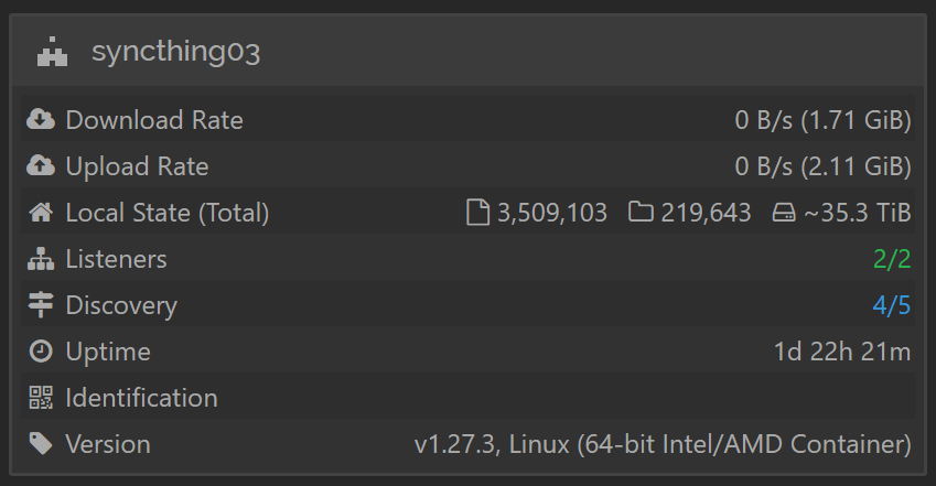

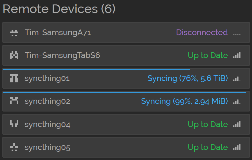

I use syncthing to sync data across four of my servers at different locations.  No problems in general but I have noticed that large files (8GB+) tend to take a while to sync.  For example, 1 8GB file will take much longer than 100 files totalling 8GB.
