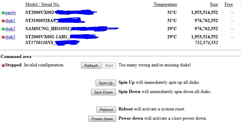

I have just gotten a HDD failure - when I start up the array it takes a very long time to boot and finally shows the HDD as missing. I have checkd the HDD on othr machines but it simply cannot be detected. Reading up on thre wikki it says that I should power down the server, replace the faiulty disk with a same / bigger sized disk and start the array. I have done so, but there is a red dot next to one of the exsisting HDD's and also next to the replaced HDD not allowing me to stary the array.
Any suggestions?
Screenshot and syslog attached.

No the 750 is the one with that doesn't even detect. I have checked all conections and all is ok.
I moved the 750 replacement (2tb) and the 1tb HDD's around, but it still doesn't look right. The ST3100 still has the red light next to it and I am concerned I might loose the data.
Any suggestions on how to bringing the array online, successfully replacing the failed 750 and hopefully not loosing any data?

Well, you do seem to be stuck and it might be a real problem to recover either disk.
I hope you have unMENU installed. If so, then first unassign disk1 from the array and try to mount it and share it using unMENU. If you are successful then you should be able to access the data over the network and check that it is OK.
Once you have verified disk1 is OK then the next step is to attempt to recover disk3. This is what I would try.
#1 - Assign the disk3 as the only array disk, you can disconnect the others if you want to be extra safe.
#2 - type "initconfig" on the command line and answer "Yes"
#3 - Start the array, format the disk and then stop the array.
#4 - now, install all the disks and make sure they are all properly assigned like your screenshot.
#5 - type "initconfig" at the command prompt and answer "Yes"
#6 - refresh your unRAID browser window and confirm all disks have blue dots.
#7 - type "mdcmd set invalidslot 3" at the command line. You should get "cmdOper=set" and "cmdResult=ok" returned.
#8 - press the start button and start refreshing the browser to see if the disk3 is being written and the others read.
What the above does;
Steps #1 to #3 will create a proper unRAID partition on the new disk.
Steps #4 to #6 will set-up the array like it was a new array and tell unRAID to build the parity.
Step #7 will modify the unRAID startup to rebuild disk3 instead of building parity.
Step #8 will put it in motion and start the rebuild.
Once the rebuild is complete, I believe you will have the origional data back without any other work. Let us know if you have any problems.
