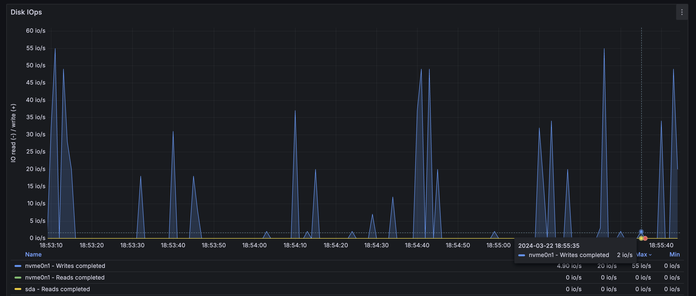

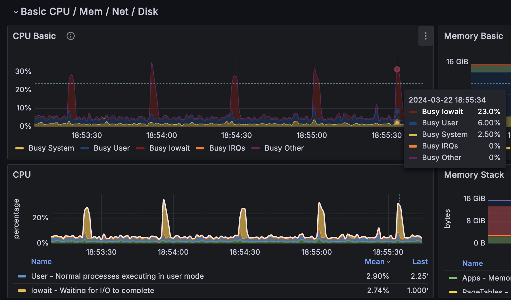

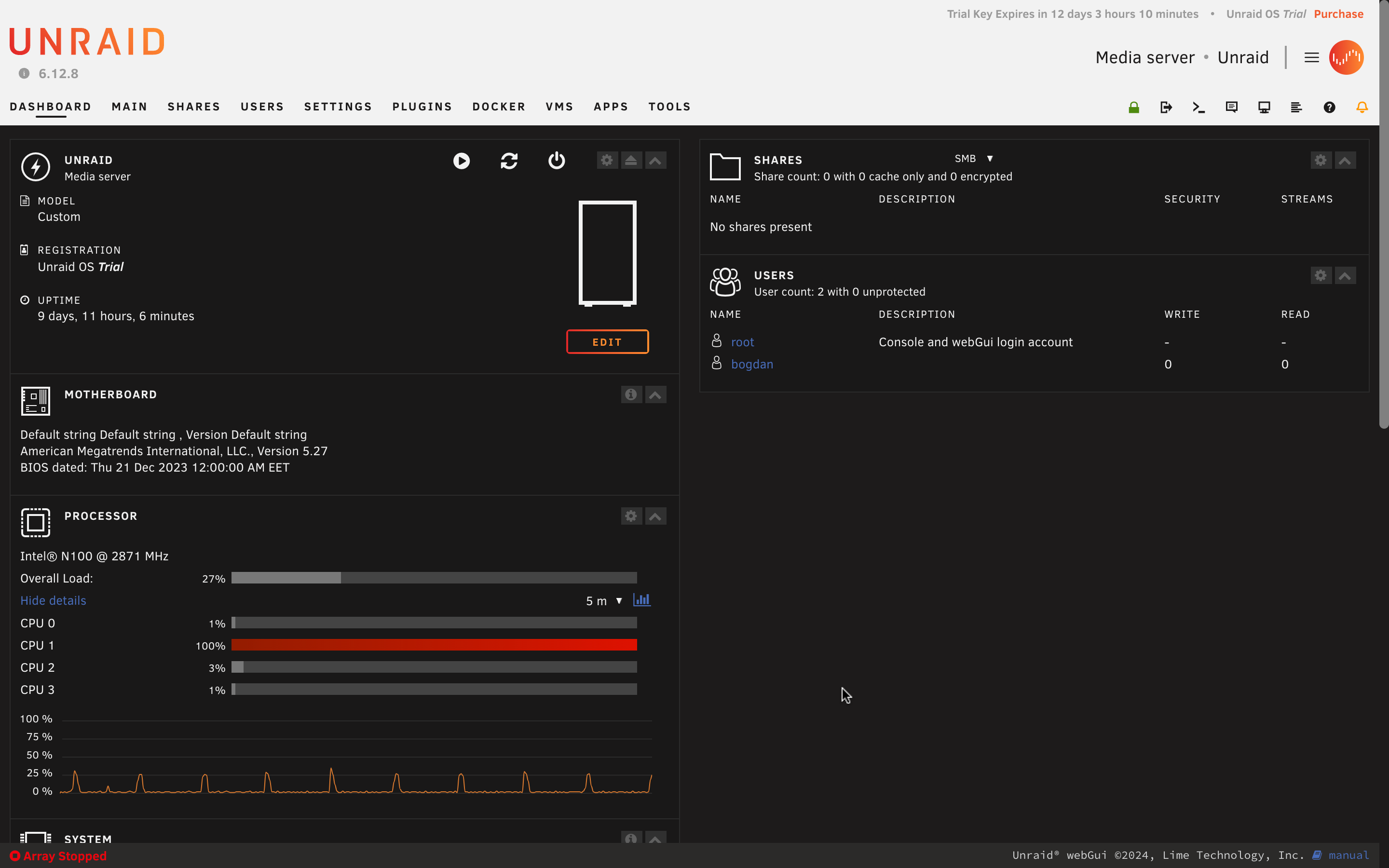

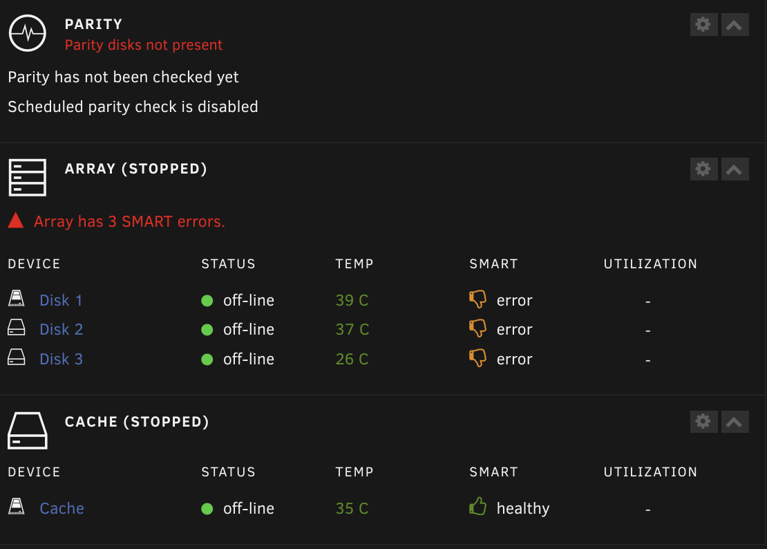

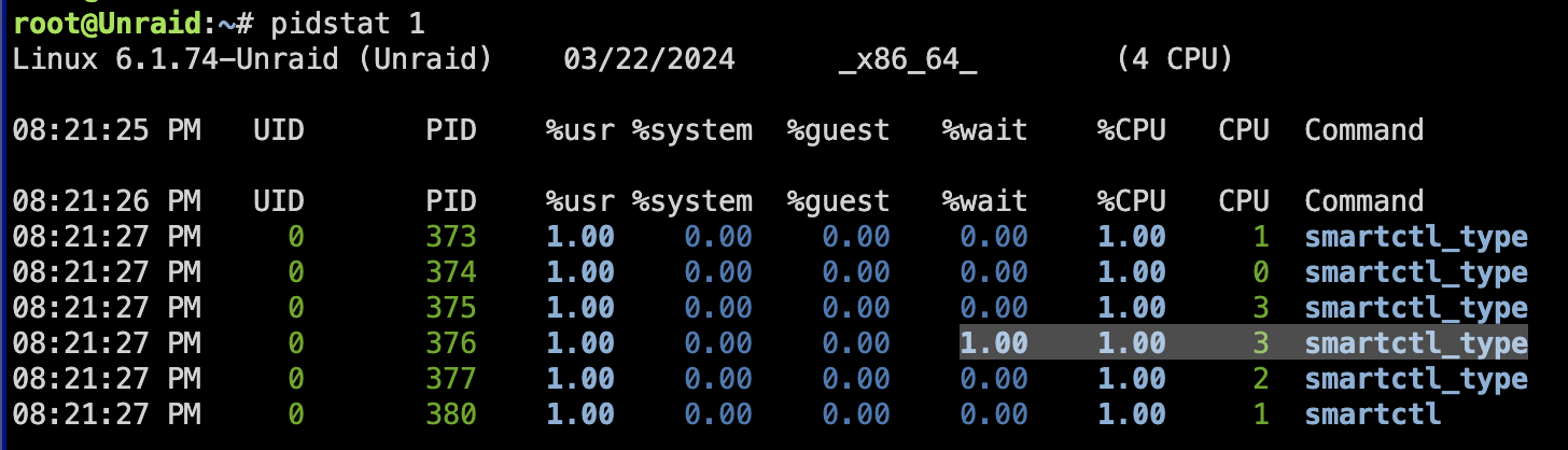

I have an annoyance / issue where each ~30s I get a CPU spike.
Looks to be from the smartctl_type processes (which I understand they are related to SMART).

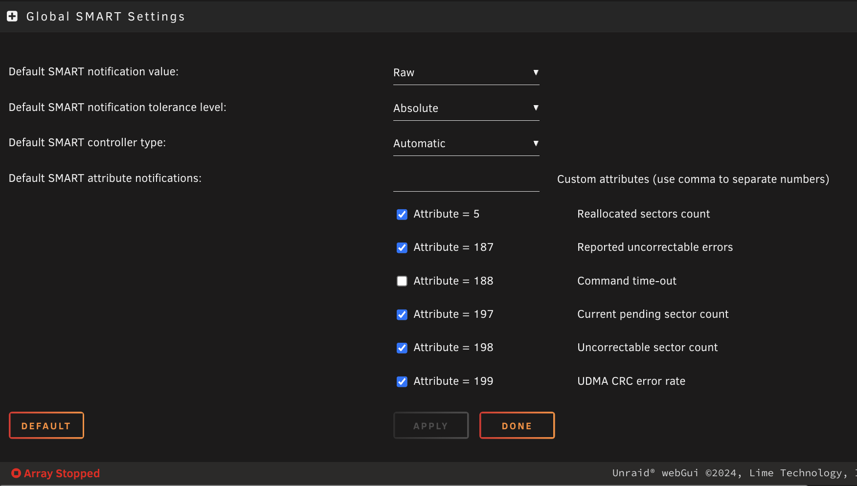

Any idea what exactly makes smartctl_type cause the spikes and how to stop it? (or at least, have the processes run once 30m not 30s)
This has been ongoing since the day I installed unraid. I have only 2 apps, Community Applications and Compose.Manager.

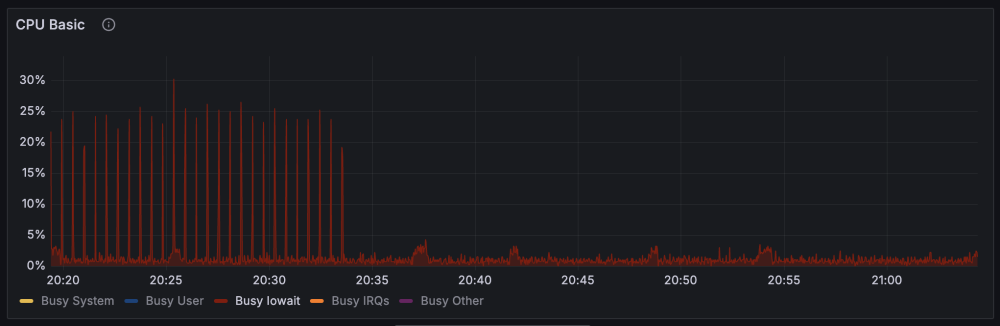

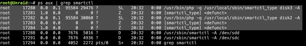

UPDATE:
looks like php smartctl_type process does not properly shut down, we see some zombie processes.
1511670793_Screenshot2024-03-24at21_12_47.thumb.png.31b59e15b96edf29988c86e8b766d8a5.png
The short-medium term fix I found was to simply rename the smartctl_type script to something else so it wouldn't get triggered anymore
Still no idea what triggers it thought
This is the before and after:
1852030049_Screenshot2024-03-24at21_06_16.thumb.png.0ae14aeb987133625578e34bcd84b3fe.png
