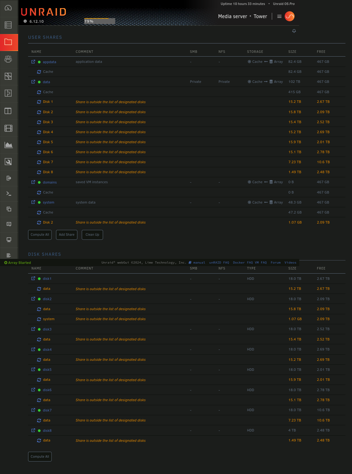

PROBLEM: Navigating to /mnt/user/data/(Any folder) I see a tiny portion of directories that I would be expecting to see. Navigating to specific disks (/mnt/disk#/data/...) all the directories and all the files that I would expect to see are there. Permissions seem to be correct all the way down from /mnt/disk#/data to whichever directory I navigate to (drwxrwxrwx+  2 nobody users).

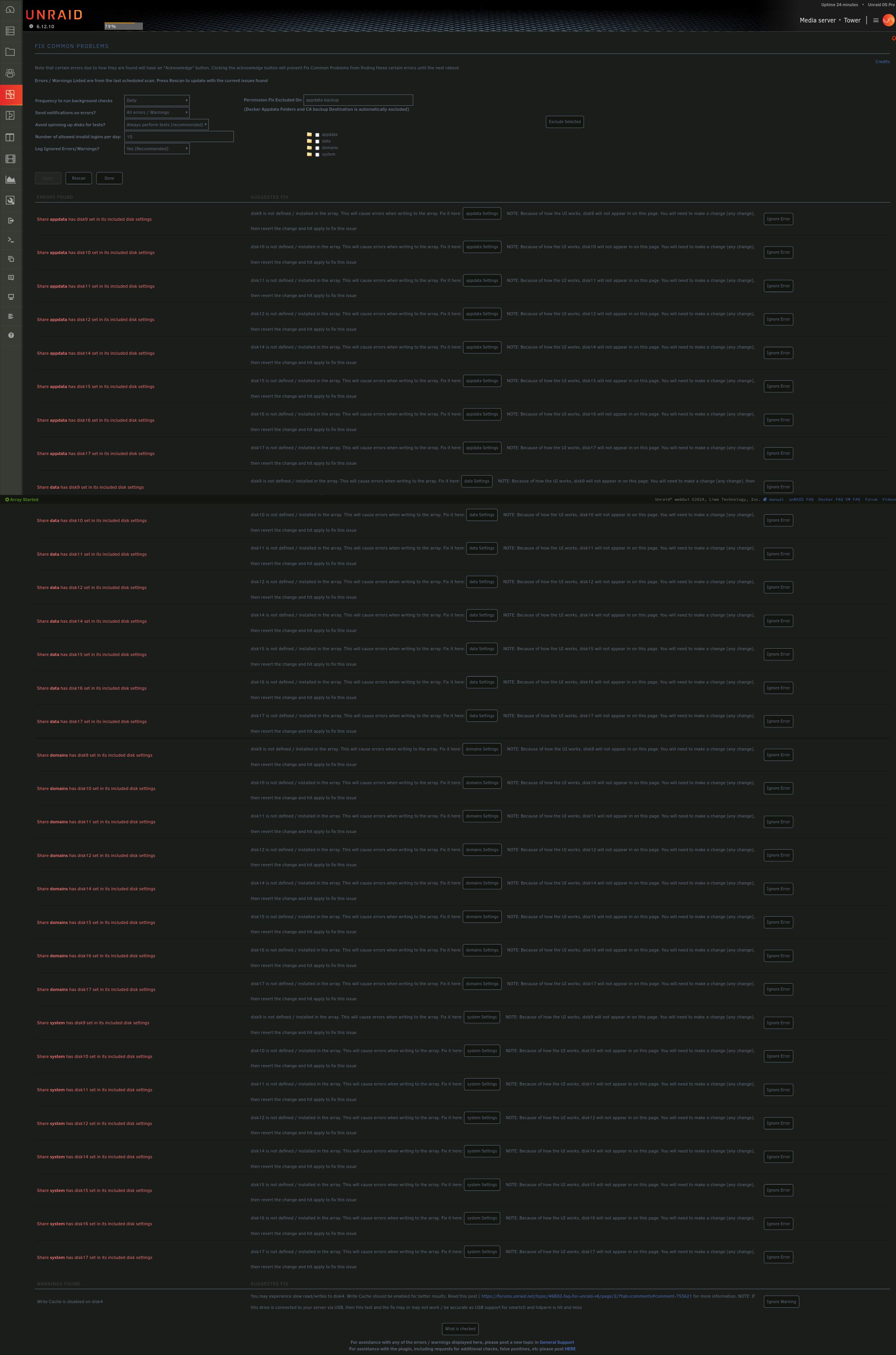

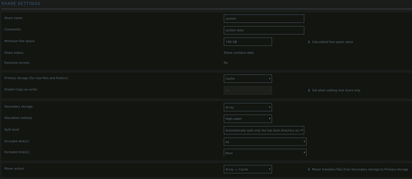

Fix Common Problems has a bunch of errors, but I am not sure what to do with them, as the shares appear to be showing correctly instead of what I changed when starting the shrink array guide steps. Although one thing that I do see is that when selecting the inclusion drop down list, there are no drives listed to select.

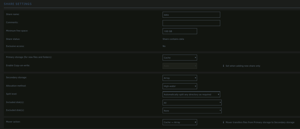

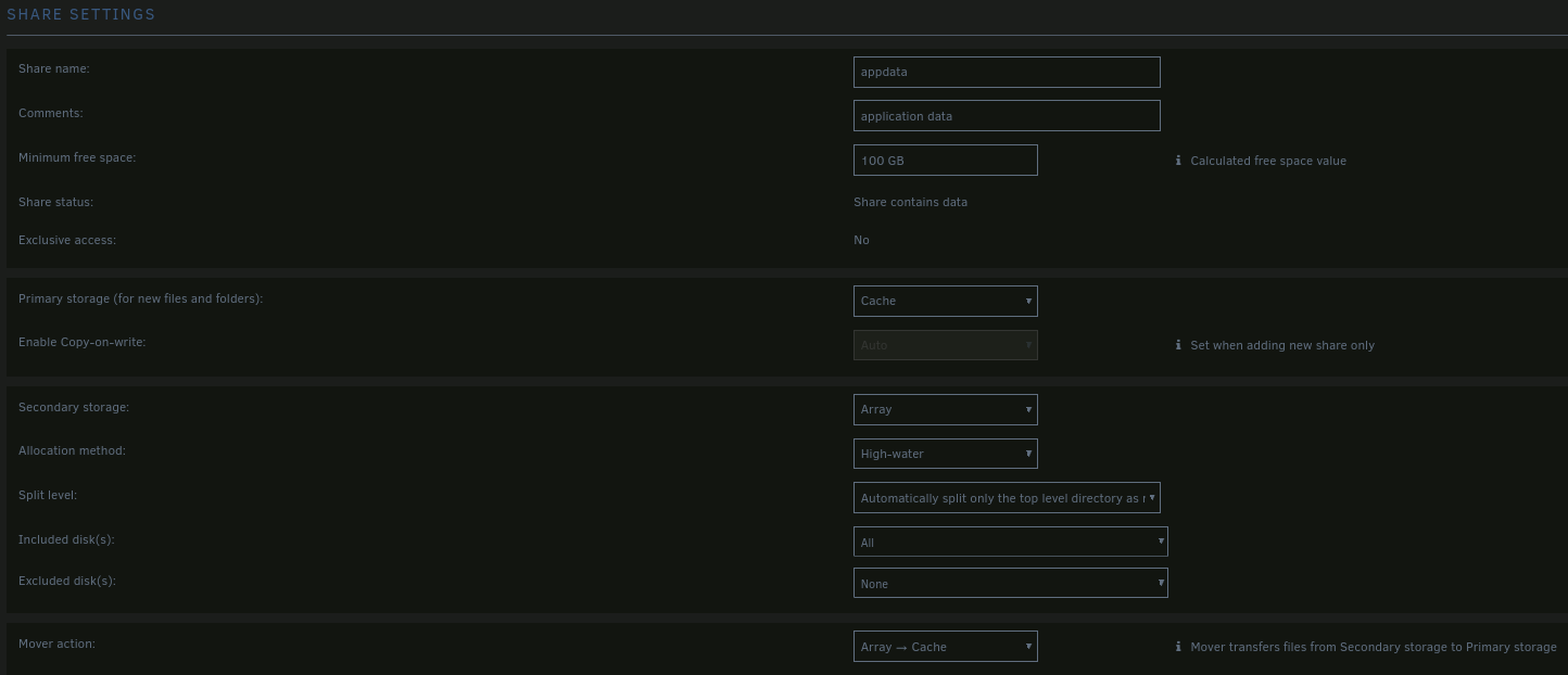

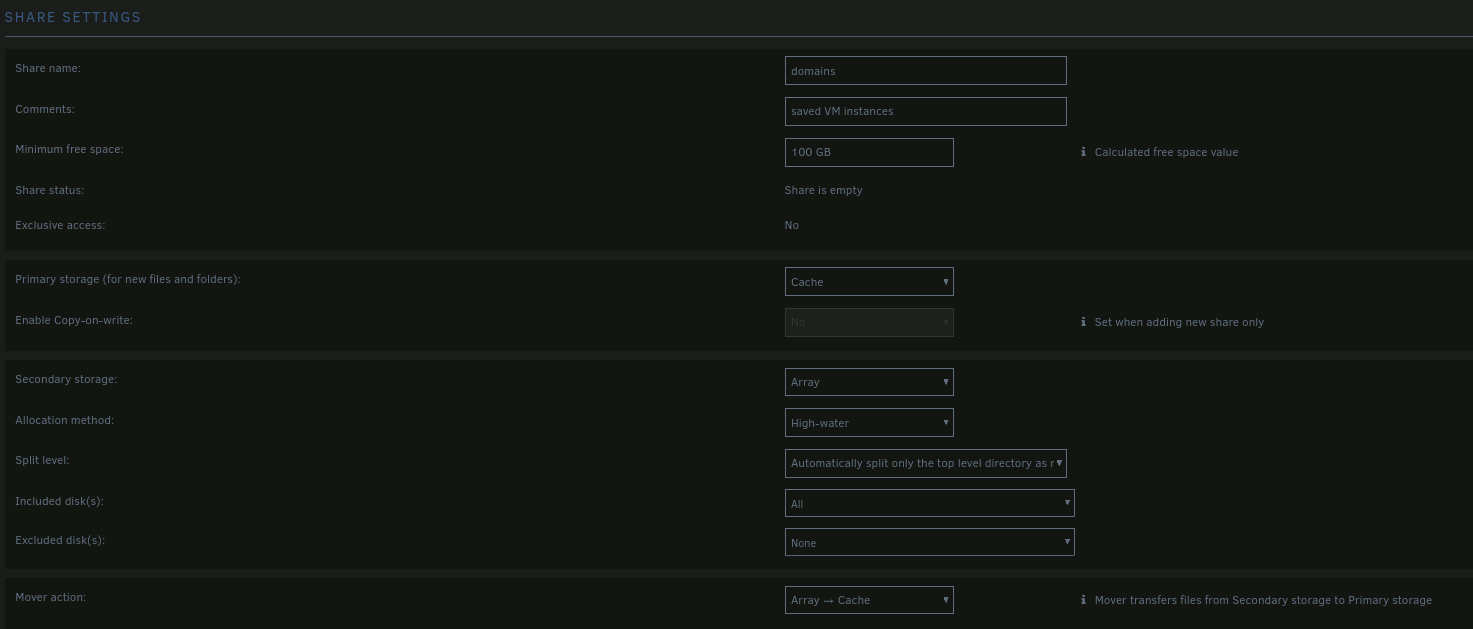

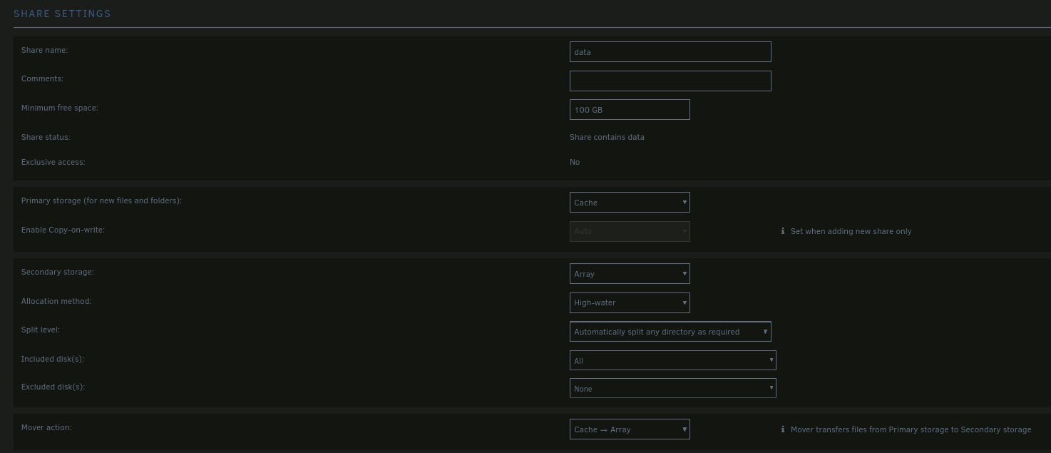

Screenshots of Fix Common Problems and each of the share settings are attached. Last screenshot is of the global share settings.

1) As per Fix Common Problems, I went into each share, deleted the last number for "Minimum free space" put that number back and applied the change.

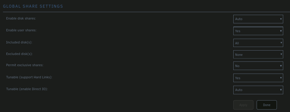

4) Navigating into Settings > Global Share Settings I was now able to see all the drives I am keeping listed in the drop-down menu for "Included disk(s)". I enabled them all and applied. Then I hit the Done button.
5) Started the array back up and I got one more notification from Fix Common Problems for the ISOS share. I repeated step 1 to correct that issue.
6) Confirmed that all the missing directories were now visible under /mnt/user/.
7) Stopped the array once again, went back into the Global Share Settings, deselected all the drives from the inclusion list so that it showed all. Applied the change and then hit the Done button.
8)) Started the array once more and going into every share settings I can finally see all of my array drives in the Inclusion and Exclusion drop-down menus.
