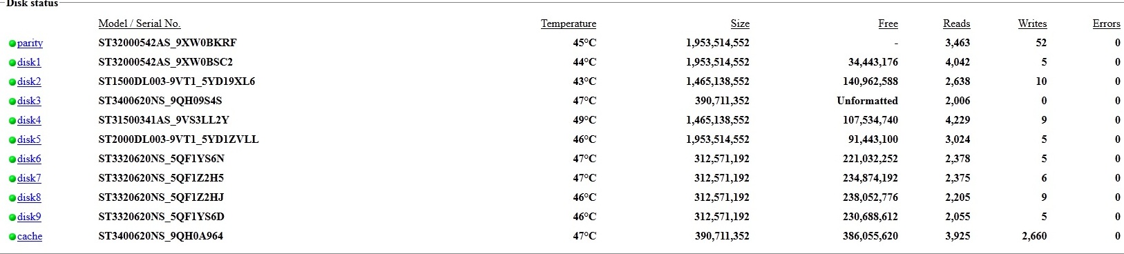

Shutdown the server today to add in another drive and upon restarting one of the drives has now appeared as unformatted.
Was working before the restart and should have 300GB+ of data on it.
I have attached a screenshot.
Any suggestions?
attach syslog, please.
first... DO NOT PRESS THE FORMAT BUTTON.
basically, the disk could not be mounted.  To unRAID, any disk it cannot mount, for whatever reason, is displayed as unformatted:
Dec 23 16:45:28 Storage logger: mount: wrong fs type, bad option, bad superblock on /dev/md3,

root@Storage:/# reiserfsck --check /dev/hda
reiserfsck 3.6.21 (2009 www.namesys.com)
** If you are using the latest reiserfsprogs and  it fails **
** please  email bug reports to [email protected], **
** providing  as  much  information  as  possible --  your **
** hardware,  kernel,  patches,  settings,  all reiserfsck **
** messages  (including version),  the reiserfsck logfile, **
** check  the  syslog file  for  any  related information. **
** If you would like advice on using this program, support **
** is available  for $25 at  www.namesys.com/support.html. **
Will read-only check consistency of the filesystem on /dev/hda
Will put log info to 'stdout'
Do you want to run this program?[N/Yes] (note need to type Yes if you do):Yes
reiserfs_open: the reiserfs superblock cannot be found on /dev/hda.
Failed to open the filesystem.
If the partition table has not been changed, and the partition is
valid  and  it really  contains  a reiserfs  partition,  then the
superblock  is corrupted and you need to run this utility with
--rebuild-sb.
root@Storage:/#
Is it likely that the file system is gone or more likely to be a hardware issue?
I would profer not to loose what is on the drive but have 80% of it backed up.
When will everyone learn.  The file system is on the FIRST partition, not the base drive.
To check it, you must use the name of the first partition, in this case
/dev/hda1
If you give it the wrong name, it will not find the superblock, since it is not there.
Joe L.
earlier in this thread you proved the superblock is not found where expected (the reiserfsck command also looks for the same string to know it sees a superblock..)
Somehow, that area of your disk has unexpected data.  We have no way to know how it got there.
If you know with reasonable certainty that the disk was partitioned to start on sector 63,  (you installed it on an older version of unRAID, prior to 4k alignment being possible)
Then, you might be able to rebuild your superblock and get back your data.  It will only have a chance of working if you re-create it on the FIRST partition, not the base drive.
I would expect the --check on /dev/hda1 to not find a superblock.
If you re-create it on /dev/hda1 it might get you back your data.  You might need to also use the -S option to scan the entire partition for your files.  Anything you do to the physical drive (/dev/hda1) will invalidate parity.    If at all possible, first attempt to perform the repair on the /dev/mdX device.  at least it will keep the parity in sync)  Assuming this is disk3, that device would be /dev/md3
Joe L.
My bad, have run it to check /dev/hda1 and it returns the same error message.
It was created at sector 63 as I have no 4K drives and has been left on the default MBR:"unaligned"
If I run the rebuild-sb command is it going to attempt to rebuild the file system or just create a huge amount of files in lost+found?
reiserfsck --rebuild-sb /dev/md3  ?
Ran reiserfsck --rebuild-sb and reiserfsck --rebuild-tree -S
File system is back with a hand full of files in lost+found.
Not sure what cause the issue but very glad for it to be all back....
