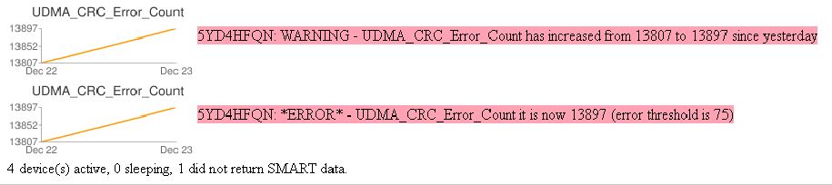

Thinking it was the new drive, I decided to run a preclear on JUST THAT DRIVE which is still running now. I will update on progress. As for now I did manage to get smart history installed and have noticed a log it seems to complain about on this new drive. Could this be a big clue as to the problem? I searched and this error below can indicate sometimes that there is  a bad sata cable or power connection to the drive?

Just to update this thread. I was correct with my first assesement in that it could be the cable. I was not aware of SATA cables being a particular SATA standard, like SATA1, SATA2 etc. I thought a SATA cable was a SATA cable. However, the one I was using was the thinnest and narrowist one I have ever personally come accross. I'm not sure how it can only partially work to be honest but it did. Something about that cable was not right. I swapped the cable out and kept everything the same - even the port on the mortherboard - and the first attempt at preclear passed in 24 hours with no errors.
Tags for future ref and searching: *ERROR* - UDMA_CRC_Error_Count it is now 13897 (error threshold is 75)
