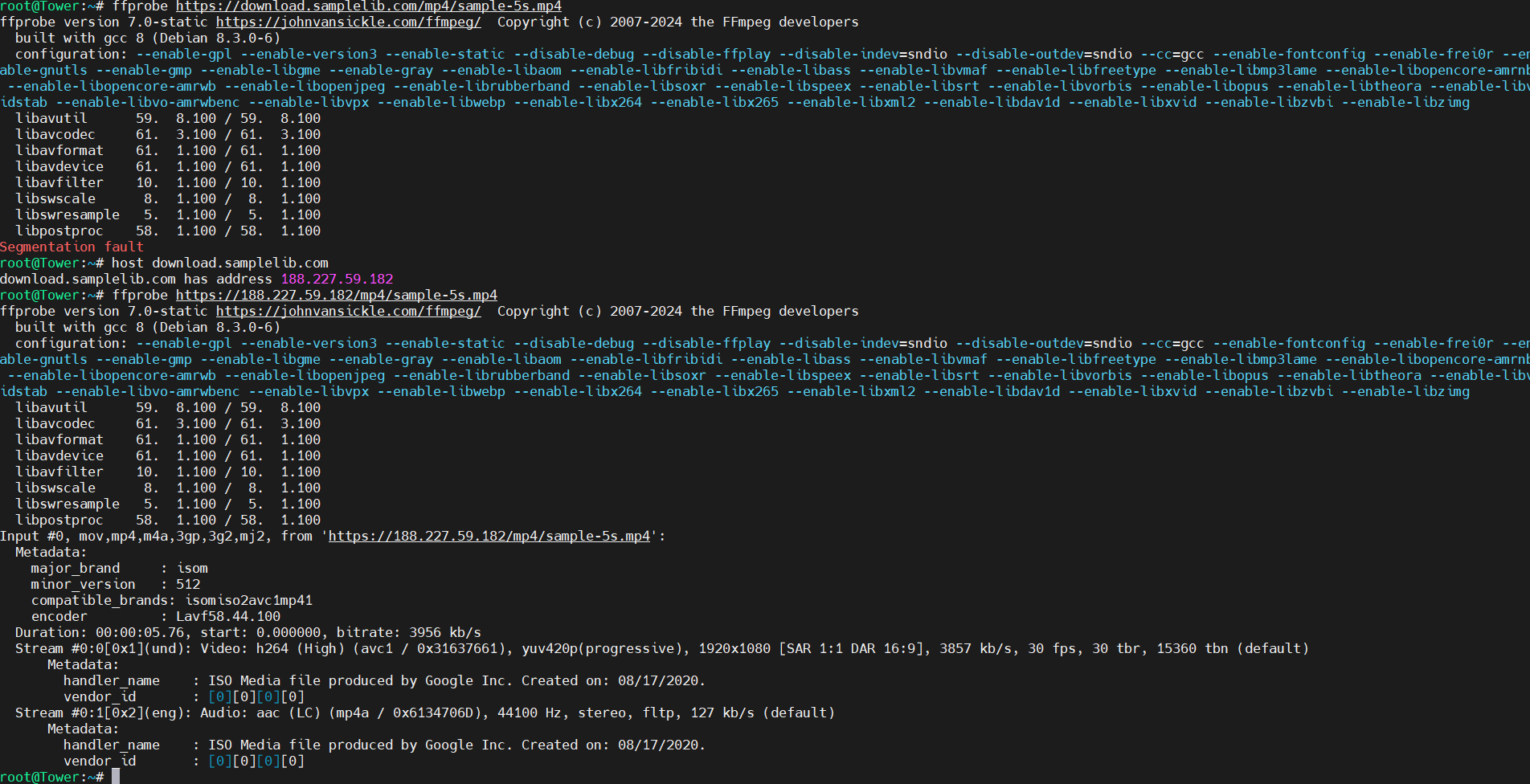

I'm trying to set up a script using ffprobe to scan a long list of web video urls and I find some pretty interesting ffprobe behavior.
Here is a screenshot demonstrating everything.
First run: ffprobe https://download.samplelib.com/mp4/sample-5s.mp4 -> segmentation fault
Then try to get the ip: host download.samplelib.com
Finally run with the IP: ffprobe https://188.227.59.182/mp4/sample-5s.mp4 -> success
Here is the syslog:
Jun  6 23:33:30 Tower kernel: ffprobe[17031]: segfault at 23550 ip 0000000000023550 sp 00007ffc6540eec8 error 14 in ffprobe[400000+1000] likely on CPU 0 (core 0, socket 0)
Jun  6 23:33:30 Tower kernel: Code: Unable to access opcode bytes at 0x23526.
I "installed" ffmpeg by downloading latest static build from John Van Sickle - FFmpeg Static Builds and unzip then make a symlink to /usr/bin
I tried different old versions and all ended with the same error.

I managed to solve this problem myself! Just leave some notes in case for someone google this issue again.
The reason for this error is because the office linux static builds are linking to glibc, so it will cause DNS issues. See the stack overflow post here:
FFMPEG "Segmentation fault" with network stream source - Stack Overflow
In my case, I downloaded the build from BtbN/FFmpeg-Builds (github.com). Just get the gpl variant and good to go.
