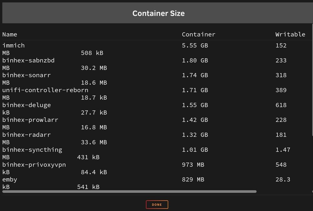

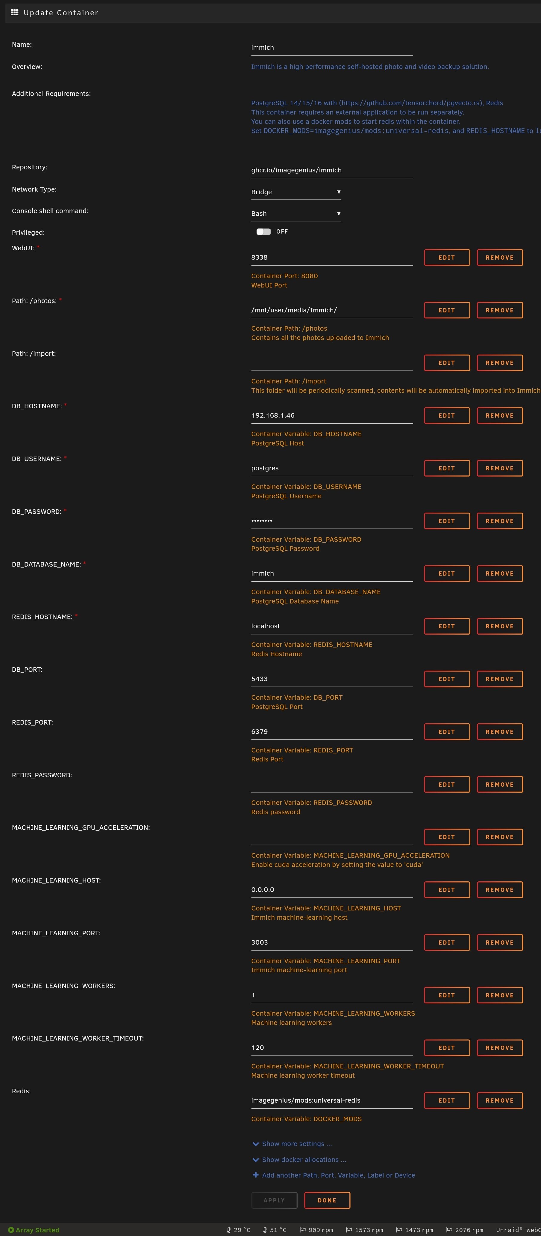

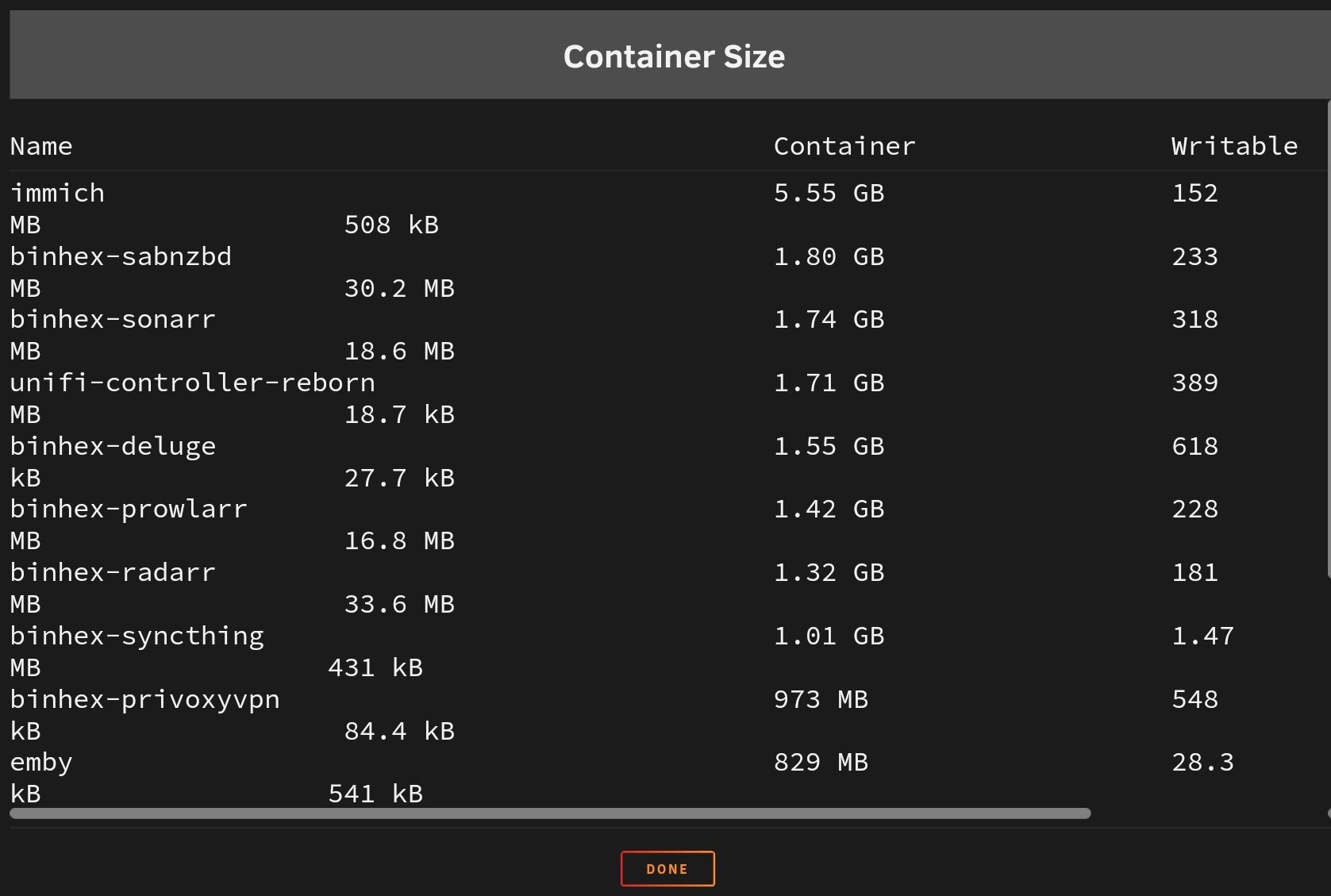

I recently discovered Immich via Spaceinvaders video, and have been enjoying using the app since. My only issue however is that the Immich docker image is steadily increasing in size.
I initially increased the overall HDD space available for all docker images, believing it just needed a little more room, however Immich still continues to increase in size. I've double checked my docker mappings, comparing them to Spaceinvaders, and I can't see any issue.

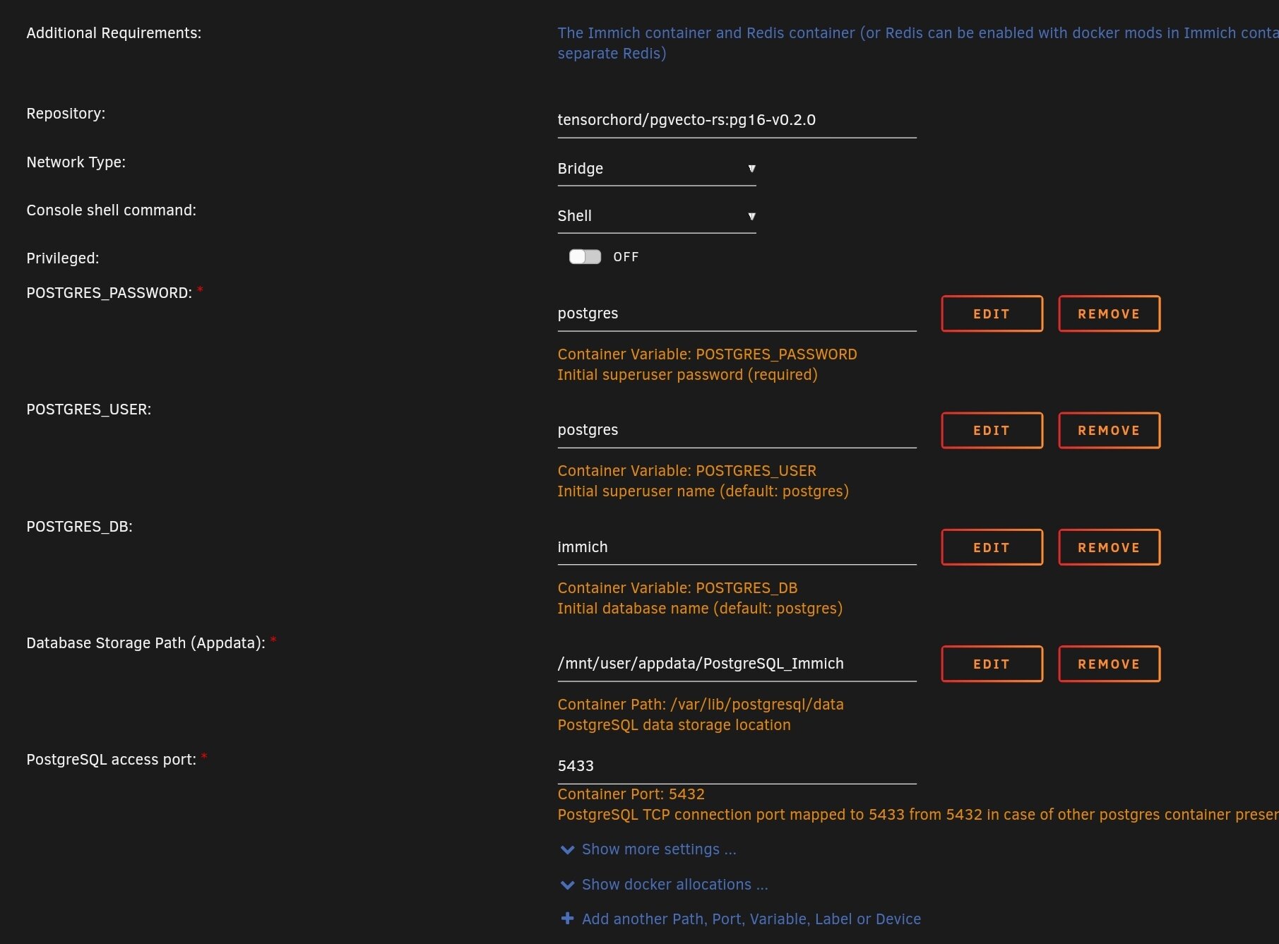

My images are successfully uploading to unRaid and being stored in the mapped photos folder, and I've deployed the PostgreSQL_Immich docker.
I'm sure it's something simple I'm overlooking, but I just can't see it.
Any advice would be greatly appreciated.

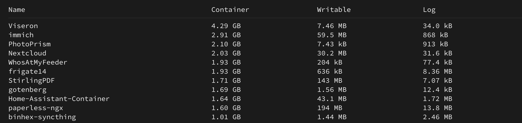

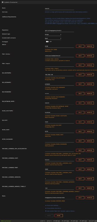

For Reference these are my sizes:

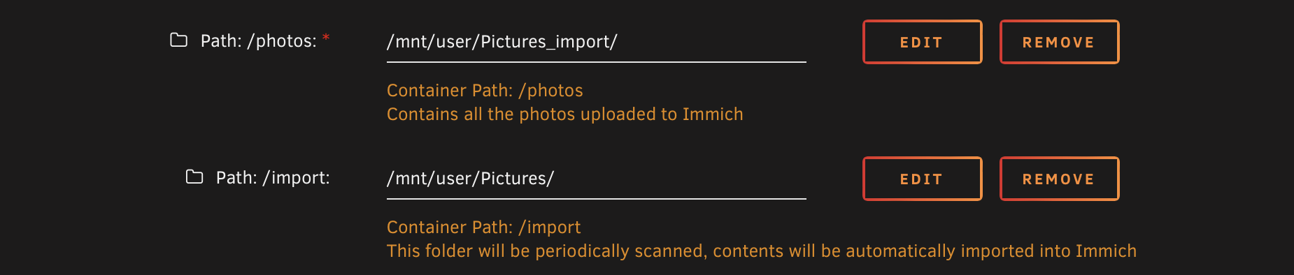

 I've got these paths mapped. The first one is pretty big.:

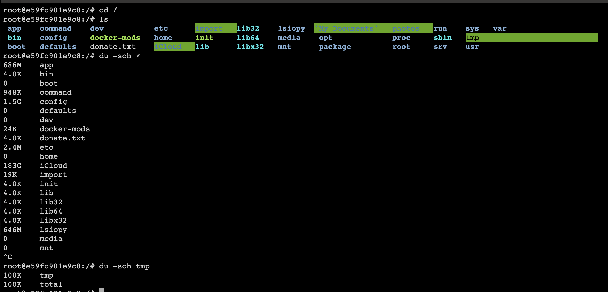

One thing you can do is going into your console(docker) and find out which directories are large/growing and not mapped:

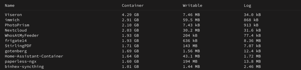

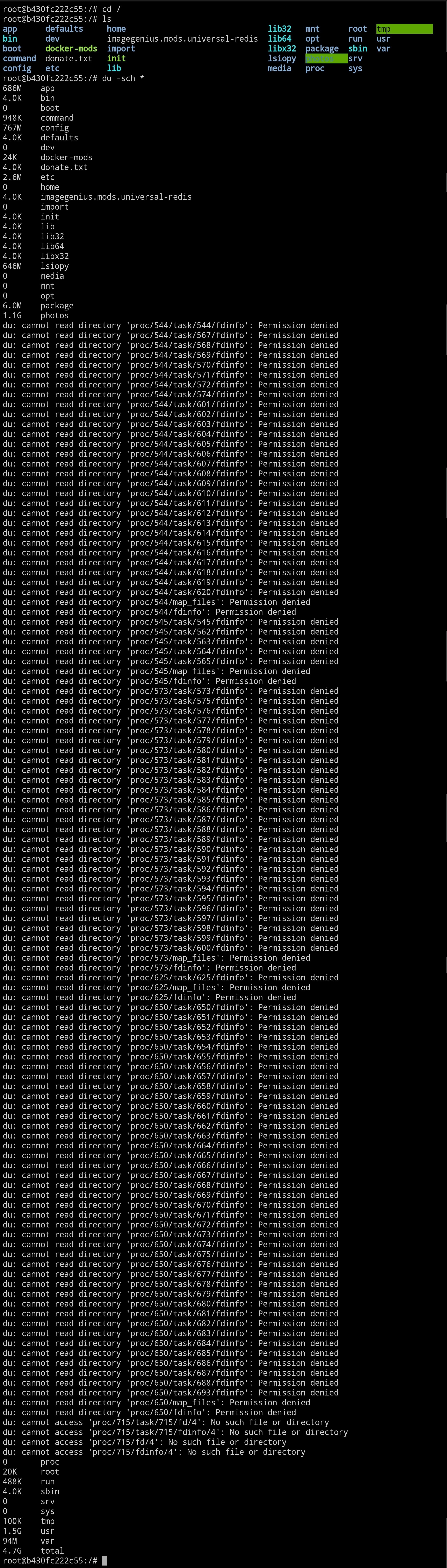

Sorry, that might be normal for /proc. I get that too....I just ctrl-C'd out of it because it was taking too long since I mapped a huge DIR into the docker.
 Here's the full readout for comparison. (You can ignore my mapped Dirs). I actually don't see anything egregious in your listing.
root@e59fc901e9c8:/# du -sch *
686M    app
4.0K    bin
0       boot
948K    command
1.5G    config
0       defaults
0       dev
24K     docker-mods
4.0K    donate.txt
2.4M    etc
0       home
183G    iCloud
19K     import
4.0K    init
4.0K    lib
4.0K    lib32
4.0K    lib64
4.0K    libx32
646M    lsiopy
0       media
0       mnt
1.8T    My Documents
0       opt
6.0M    package
198G    photos
du: cannot read directory 'proc/204/task/204/fdinfo': Permission denied
...[Omitted for brevity]
du: cannot access 'proc/599/fdinfo/4': No such file or directory
0       proc
20K     root
472K    run
4.0K    sbin
0       srv
0       sys
100K    tmp
1.5G    usr
14M     var
2.2T    total
