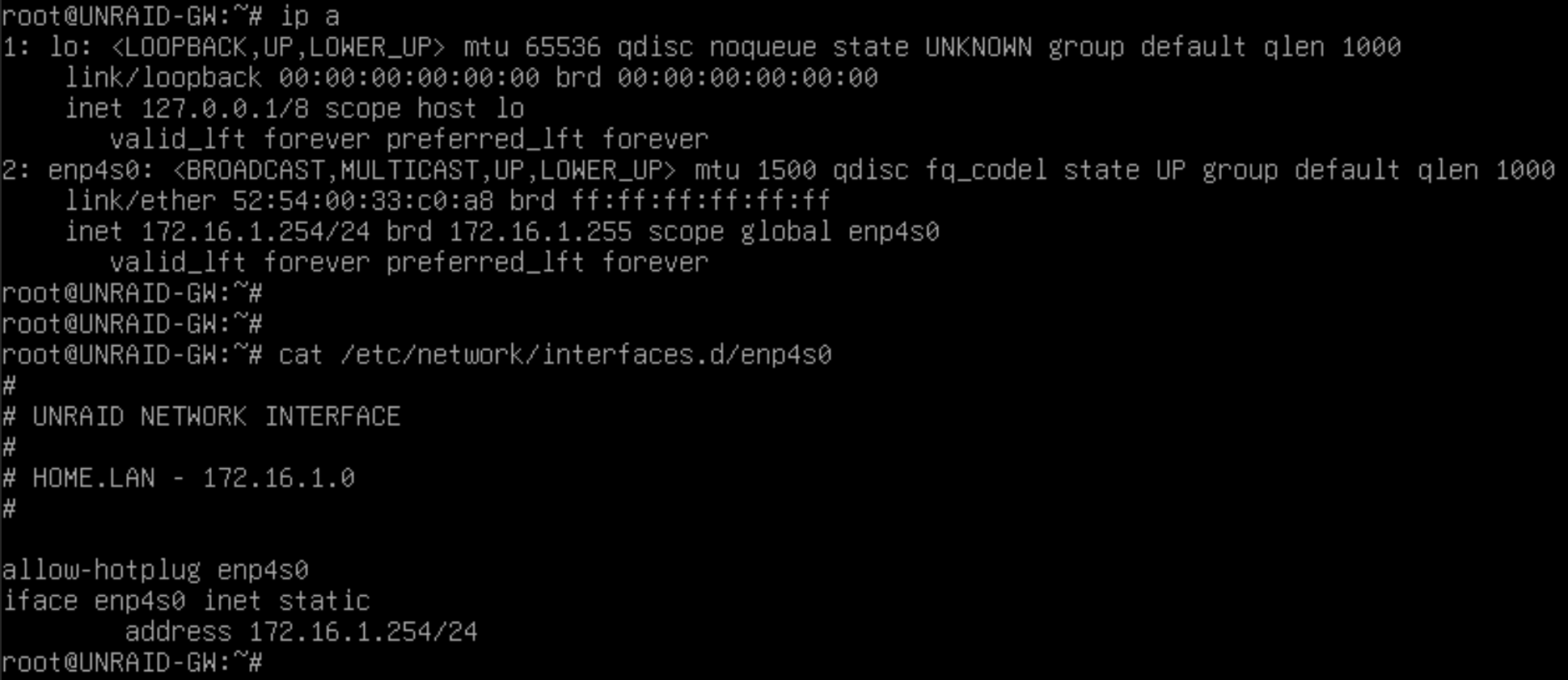

So now, I created one VM with exactly same config (Seabios / Q35-7.2 / virtio vdisk / network / etc.). The VM boots correctly but the network is not working. I can't ping from/to the VM. I tried the other network models (virtio / e1000 / etc.) but no changes. The VM (Debian 12) can see the type of nic (as 'ens1' or 'enp1s0') and I can reconfig it via /etc/network/interfaces.d/, then I reboot. The IP is showed by the VM. But still no ping...
Here's a screenshot:

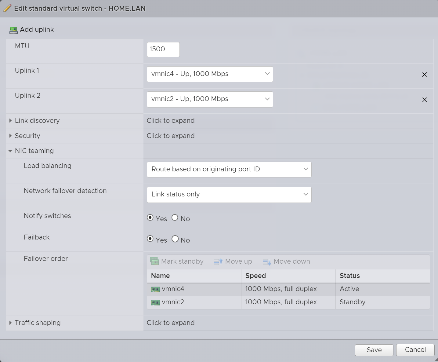

On the ESXi Host:
the nics are 2 cards with 2 ports
each port of each card is linked with the other port of the other card
on ESXi I created vSwitches with failover: 1 active port, and one in standby status
