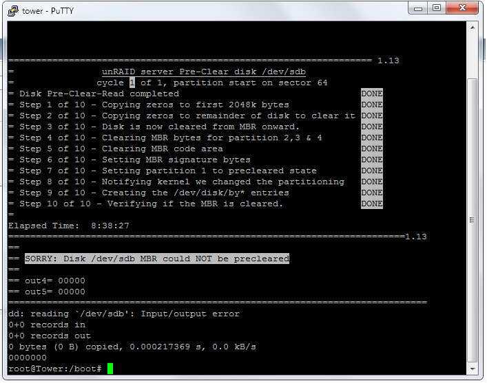

preclear consistently failing on a samsung f4 drive
so i've successfully precleared 3 western digital drives (2 EARS, 1 EADS) and had no hiccups whatsoever.
then i get to preclearing a samsung f4 drive (firmware updated) but consistently get the following error:
================================================================== 1.13
=                unRAID server Pre-Clear disk /dev/sdb
=              cycle 1 of 1, partition start on sector 64
= Disk Pre-Clear-Read completed                                DONE
= Step 1 of 10 - Copying zeros to first 2048k bytes            DONE
= Step 2 of 10 - Copying zeros to remainder of disk to clear it DONE
= Step 3 of 10 - Disk is now cleared from MBR onward.          DONE
= Step 4 of 10 - Clearing MBR bytes for partition 2,3 & 4      DONE
= Step 5 of 10 - Clearing MBR code area                        DONE
= Step 6 of 10 - Setting MBR signature bytes                    DONE
= Step 7 of 10 - Setting partition 1 to precleared state        DONE
= Step 8 of 10 - Notifying kernel we changed the partitioning  DONE
= Step 9 of 10 - Creating the /dev/disk/by* entries            DONE
= Step 10 of 10 - Verifying if the MBR is cleared.              DONE
Elapsed Time:  8:38:27
========================================================================1.13
== SORRY: Disk /dev/sdb MBR could NOT be precleared
== out4= 00000
== out5= 00000
dd: reading `/dev/sdb': Input/output error
0+0 records in
0+0 records out
0 bytes (0 B) copied, 0.000217369 s, 0.0 kB/s
0000000
root@Tower:/boot#
i've ran the preclear script on this drive 3 times now, on different sata ports and ensuring i use the -A switch.
it's pretty obvious the problem is an i/o error (they're all over the place on the syslog), but what could be the cause of this?
has anyone ran across this problem? any help would be appreciated.

i decided to run a clear on the drive using hdtune.
i was able to create a problem i'm sure happened with unraid.
the disk would get "stuck" and start reallocating sectors.
ran seatools, drive was bad. oh well, rma here i come!

Glad you found the drive was defective BEFORE loading all your data on it.
