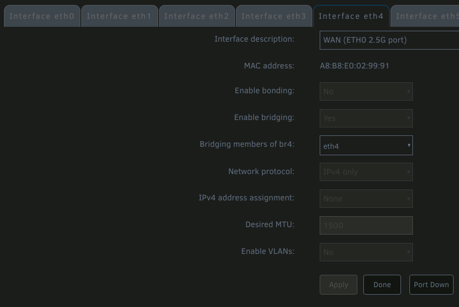

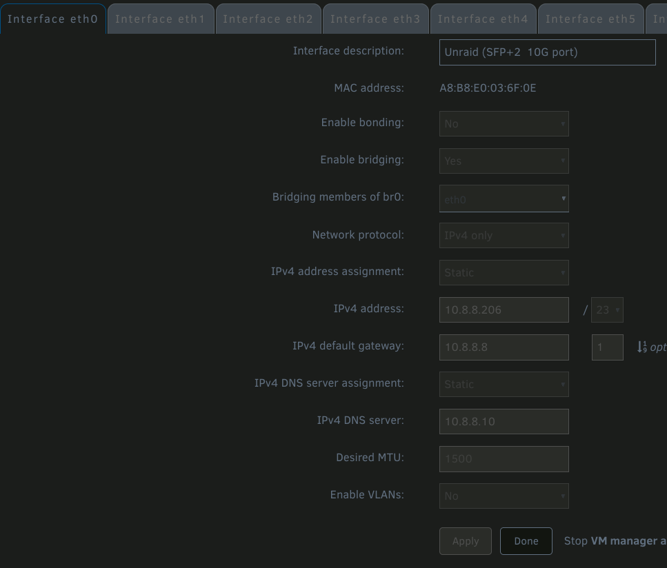

Run each bridged (no bonds). The bridge for the one Unraid is using (primary, eth0) gets assigned to LAN and the other to WAN, in OPNSENSE.
Ignore the description in my screenshots, the parts in braces describe the physical ports location/labels on my specific system/enclosure. In this axample above, I'm using one of two 10G ports and one of four 2.5G ports.
In my specific setup, I'm now assigning an additional 10G port as well, but that's not necessary. So I have Unraid running one 10G port and the LAN at large running a different 10G port. But I used to have them one and the same.

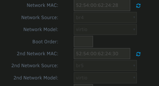

In the VM config, you assign the "br" bridges as two virtio devices (4 and 5 in my case, likely 1 and 2 in your case)
