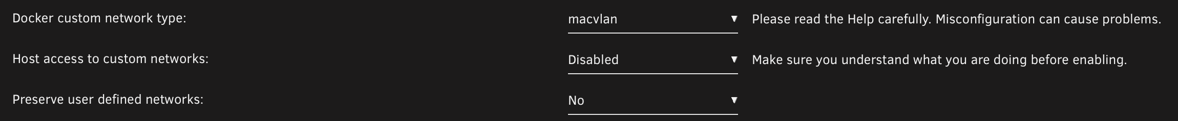

Do I want to enable host access to custom networks?
Both settings have warnings.
What would change by enabling host access to custom networks?
It depends, if you want your UnRaid server to use the PiHole then yes. I personally wouldnt recommend it, since it will be a Chicken Egg Problem. Although doable with static DNS Server. First DNS your pihole, second a external one.
Also VPN connections are a bit more "involved" with that setting enabled.
Ok. Thank you. I will keep it off and see what happens.
As far as I can tell, as my server is still under construction and I'm inexperienced, your suggestion succeeded in reporting a custom MAC address with the Pi-Hole IP without running into or noticing other impacts on my setup.
