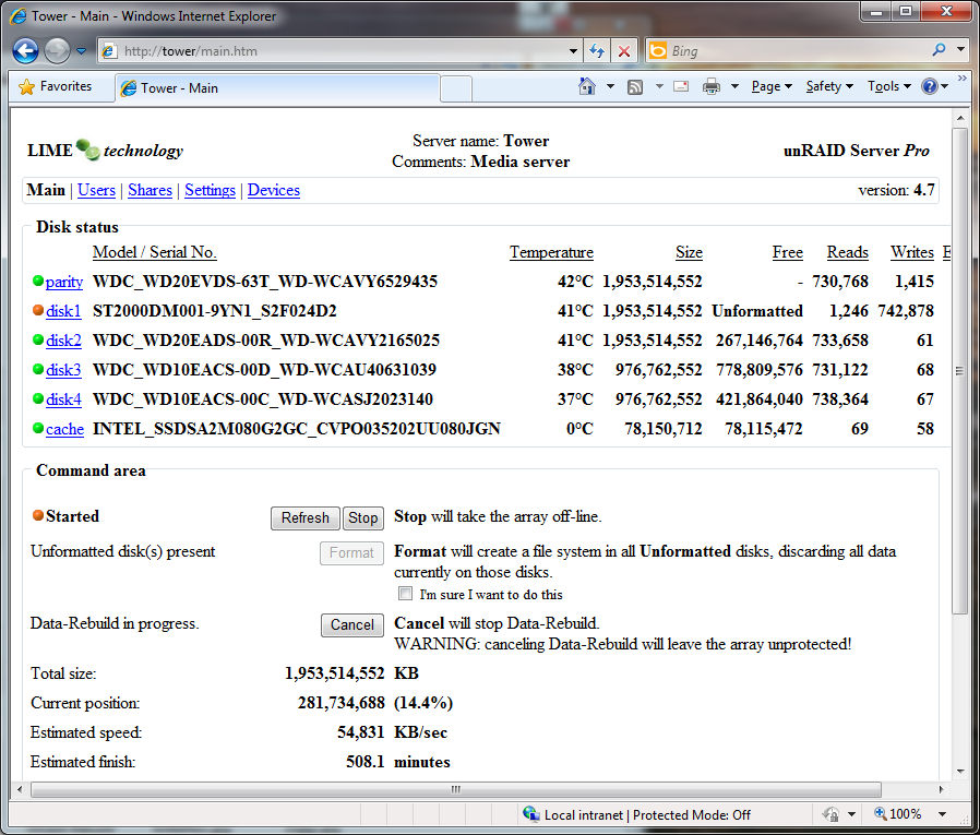

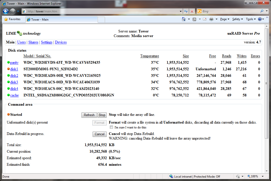

It shows it is writing to disk1 and reading all other drives. While trying to figure out how to do it, I accidentally started a parity synch, however I stopped it quickly, it wrote 1415 writes before I stopped it. Screen shots attached.
Just took this one, the 1415 writes to parity was when I started the array before and it started synching parity, I stopped it, then found that command that tells it disk1 needs to be synched and started the array again and it took off writing to disk1 and reading all others.
Probly lost some of it, but I believe the vast majority should be there right?....what commands will I need to run to fix the file system and salvage what I can?
I'm not sure of the exact commands. You likely have to create the partition and then run reiserfsck on the partition using something like the --scan-whole-partition switch to find "lost" files. There is a utility around here somewhere to create valid unraid partitions and the basic reiserfsck commands are described in the wiki.
