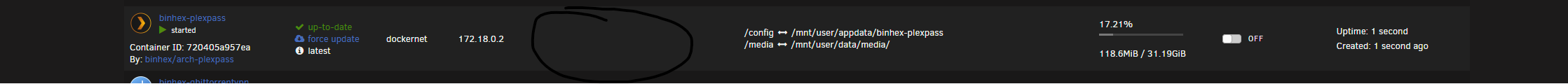

I created a custom docker network using the commands 'docker network create'. It worked however, when I set a docker to use that network (say Plex), it wont map to a 192.168.x.x address. In tutorials and guides, I see it gets mapped to a 192.168.x.x which is what I would expect. I'm also on 7.0 stable.
How can I have it map propperly?

So I was able to resolve my previous issue by creating a docker network using the following and specifying a subnet that didn't overlap with an existing one.
docker network create -d macvlan \
  --subnet=10.0.1.0/24 \
  --gateway=10.0.1.1 \
  -o parent=bond0 \
  dockernet
After setting a docker to use this network, I got another error when starting up the container...
Docker: Error response from daemon: failed to create the ipvlan port: device or resource busy
Update...
I followed the documentation here https://docs.unraid.net/unraid-os/release-notes/6.12.4/#fix-for-macvlan-call-traces and was able to get the private doicker network setup. I'm have further issues accessing the web gui of any container within that network. I'm going to make a separate post on that since the title to this one is misreprenting the issue. That, and I've had no reply.
