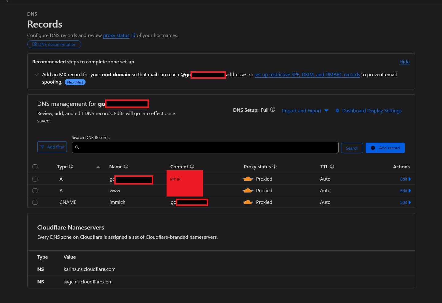

Cloudflare: - I do have a custom cert from cloudflare and saved on NPM.
Screenshot2025-02-02at22-26-19DNSRecordsgoldengamer.xyzJohmar57@gmail.comsAccountCloudflare.thumb.png.76495a2e4ca2ccdc981e8d18b344b8de.png

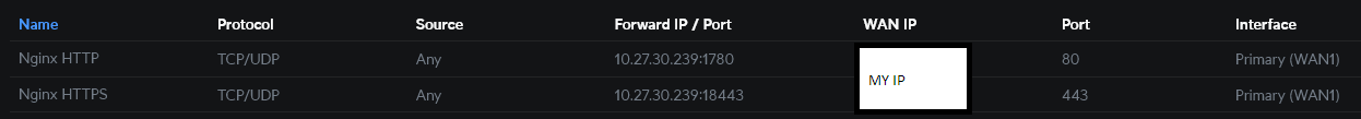

UDM-Pro
Port Forward:
Screenshot2025-02-04at20-45-18MadDreamMachine-UniFiNetwork.thumb.png.eb723e99d9a901e749144da3a70078e4.png

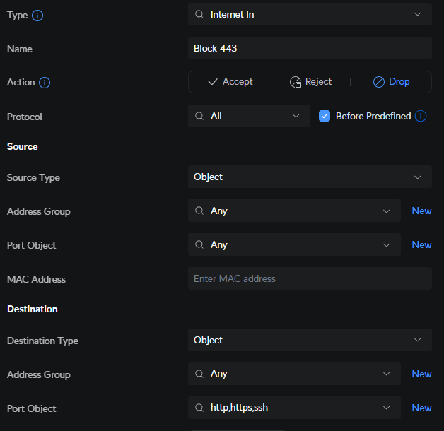

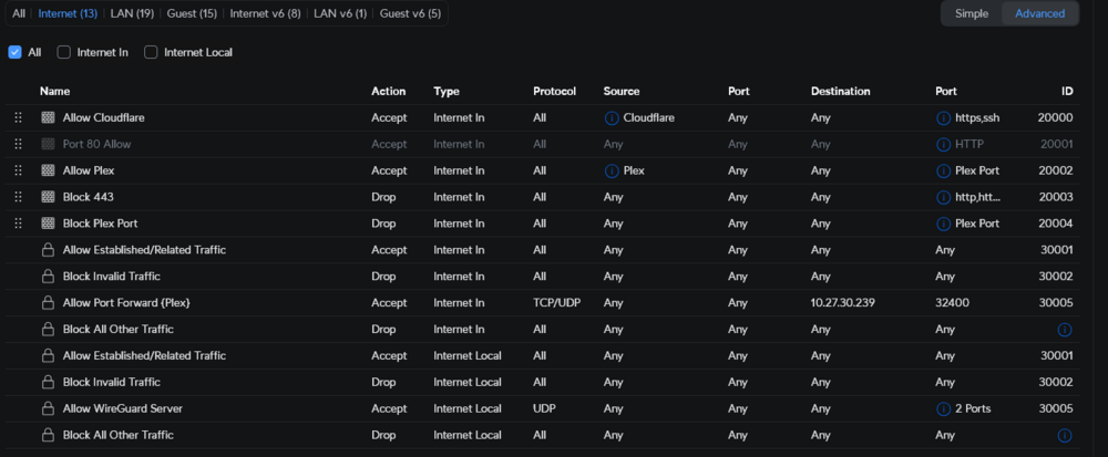

Firewall Rules:

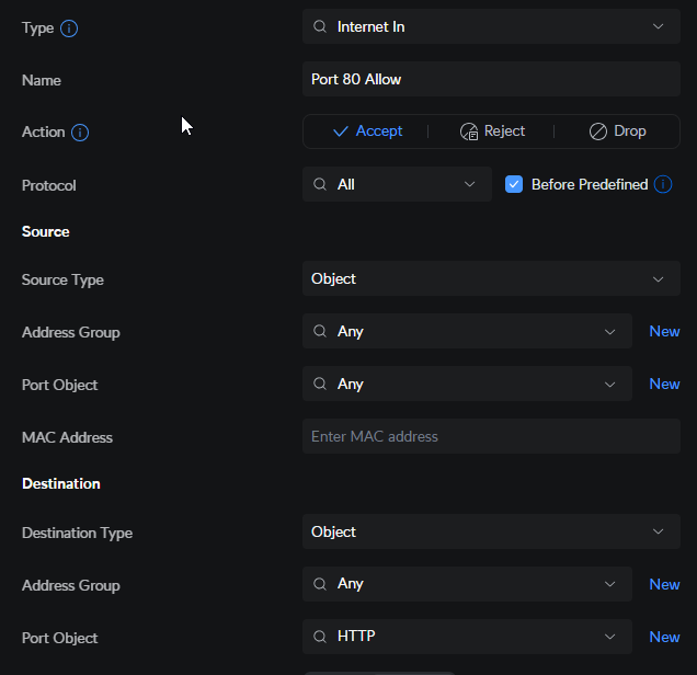

Yes I realize that Port 80 Allow is off right now in the picture because I'm not leaving it on while testing.
Screenshot2025-02-04at20-47-18MadDreamMachine-UniFiNetwork.thumb.png.2426c9f035c7e22be6b9b313a53d6690.png

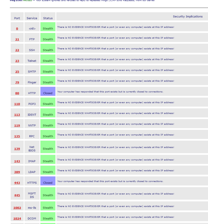

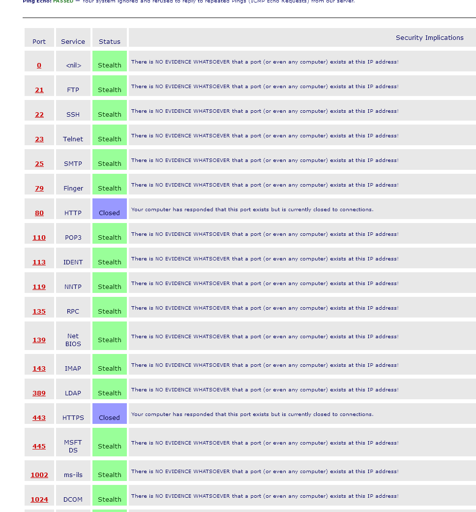

Shields Up Report:
I would expect 80 to be open with 443 closed only to Cloudflare
Screenshot2025-02-02at22-27-15GRCShieldsUP!CommonPortsProbe.thumb.png.07f1a4e337f97668e9664db2a5b88441.png

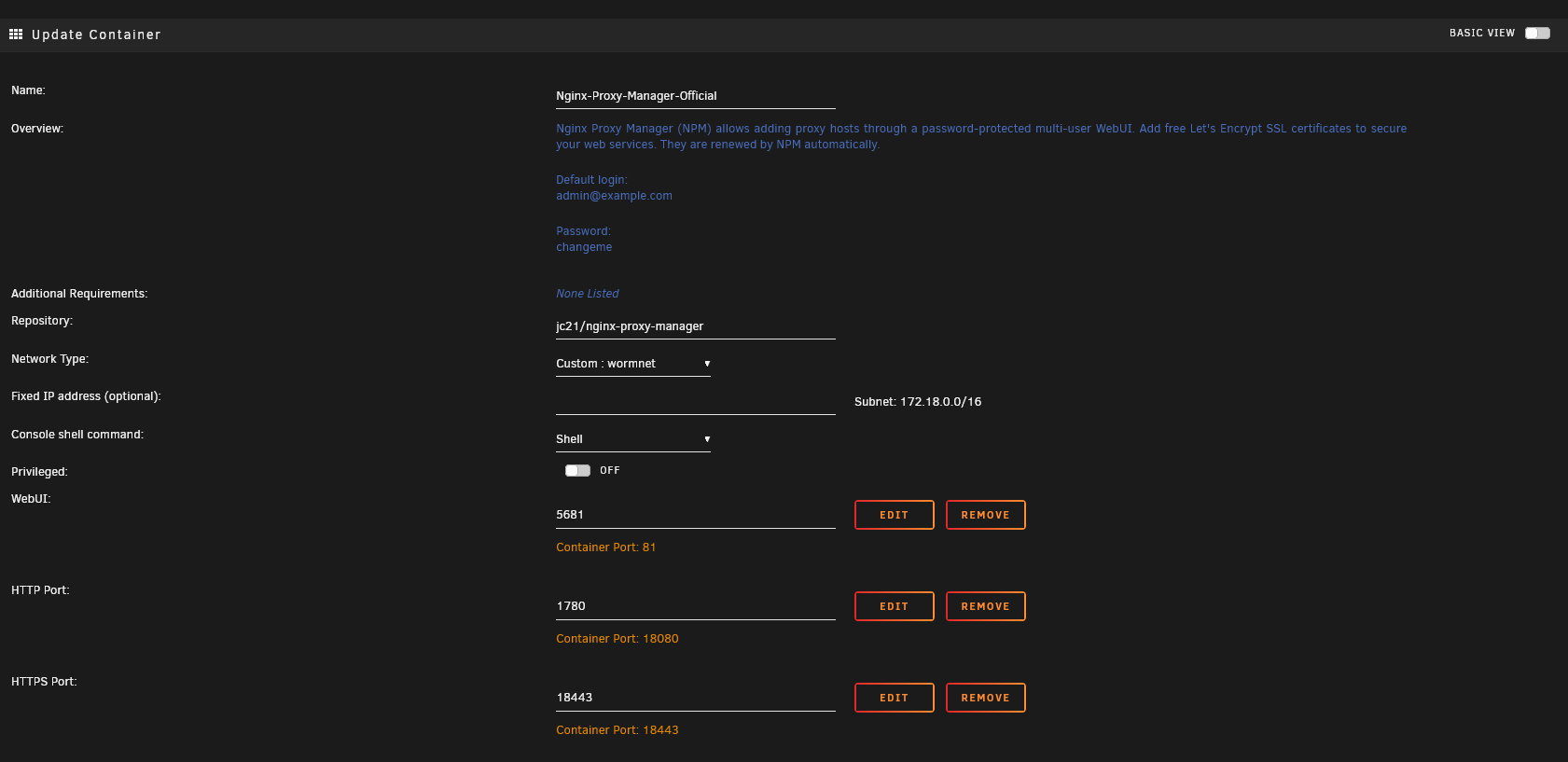

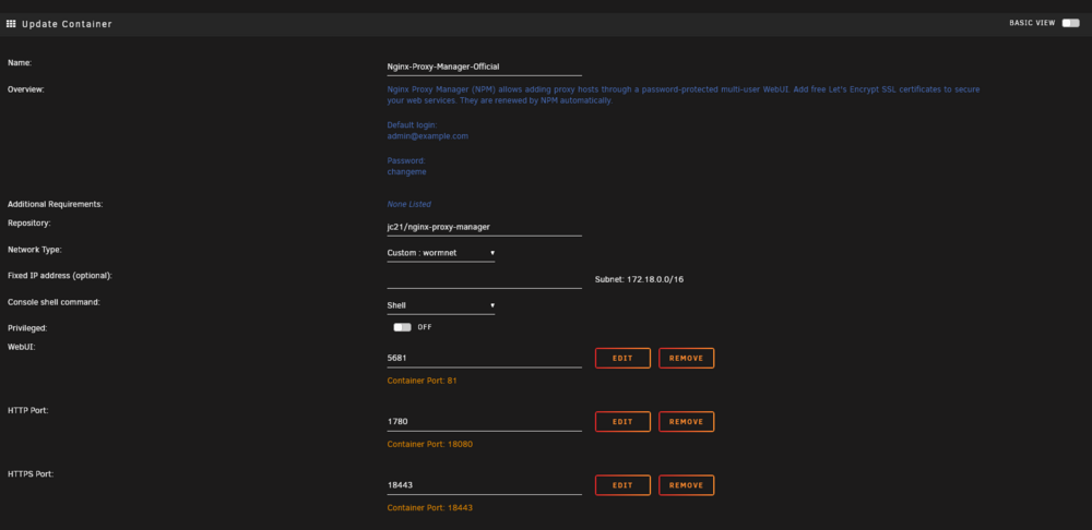

Unraid NPM Container:
Screenshot2025-02-02at22-25-52Madserver_UpdateContainer.thumb.png.26a13757ac15eebffad0ccf648ae48b2.png

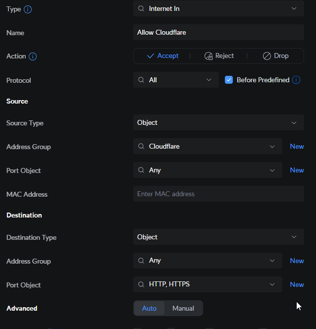

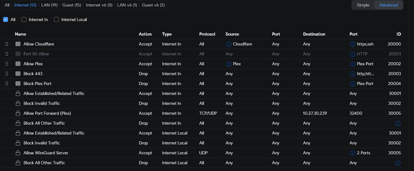

I only see https/ssh allowed and https blocked. If nginx is terminating SSL I seem to recall it has to also see http. You're forwarding but not letting it through the firewall. Also verify the ports you're forwarding to are right. They seem to be - do they work direct?
I hope this helps, here are the firewall rules for allow/block. As far as I understand it, in Unifi it runs top down, so you need Allow before the block to let the traffic move in the system.
So it should be Allow 80 and 443 from cloudflare, then allow 80 from anyone, then block 80, 443 and 22 from everyone as long as it doesnt conflict with the first two rules. Now I have removed the 80 from this block before and still no luck.
For anyone that stumbles across this and is just as confused as I was. I finally found the issue. For some reason the only change I ended up having to make was moving my Unraid GUI ports off of 80 and 443 then everything worked magically. Now I am on an IPV4 IP address so not sure why I had to do this as it states in the support page that only IPV6 is required to change ports.
If anyone has a reasoning for why. It would be great input to me for my own understanding!
