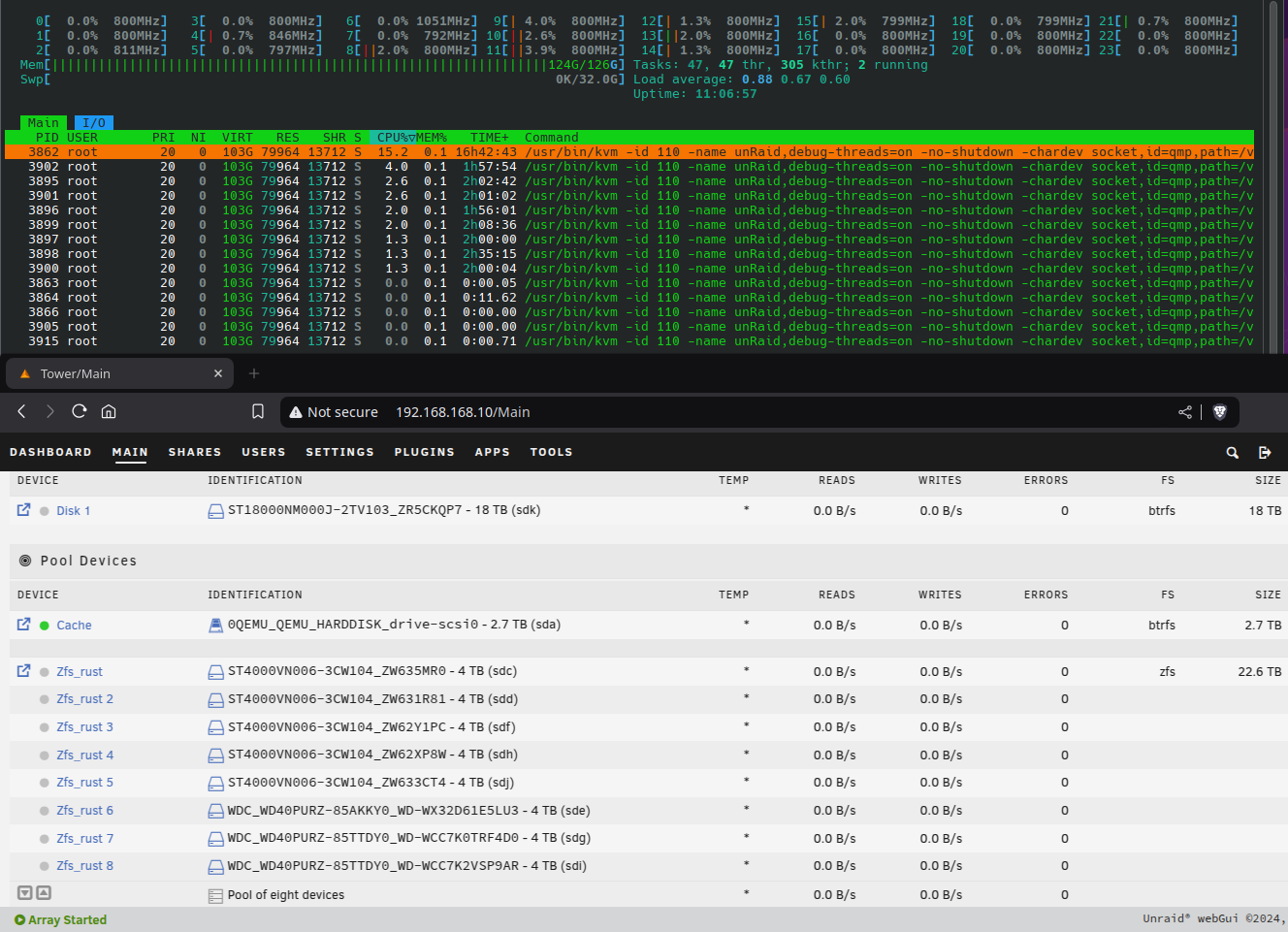

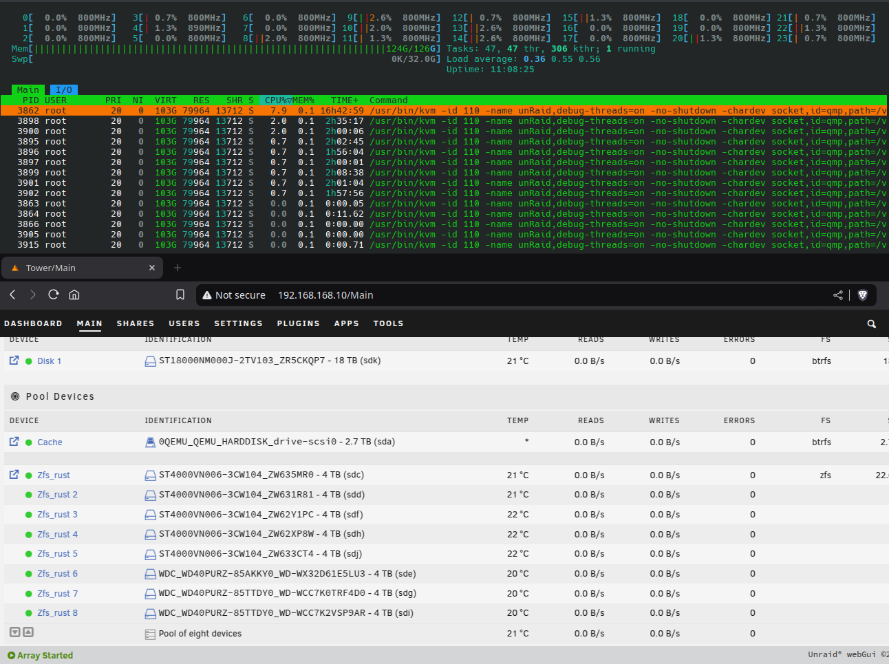

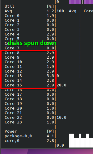

During this process, I’ve noticed strange host CPU usage when unRaid spins down the disks.
From my observations, unRaid seems to be very "nervous" by nature—it doesn’t sit still.

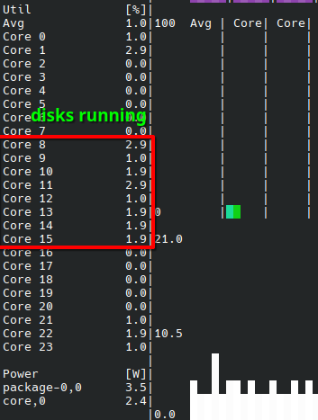

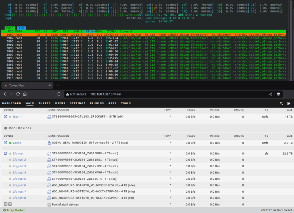

The images cpu_1, cpu_2, and affinity_spun_down show the host CPU fluctuations I’m referring to as "nervous." I don’t have Docker, VMs, or any plugins installed—it’s as bare-bones as possible at the moment.

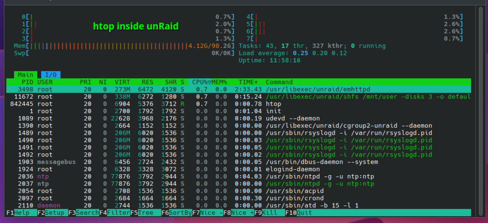

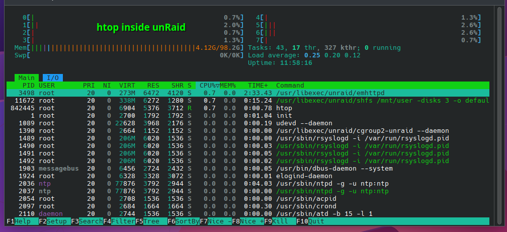

Here’s the catch... Compare the host CPU usage when the disks are spun down, again images cpu_1, cpu_2, and affinity_spun_down, versus the images cpu_3, cpu_4, and affinity_spun_up, which show lower host CPU usage when the disks are spun up. Say what ?
Why is unRaid using more host CPU when the disks are spun down? It doesn’t make any sense to me. And why is unRaid so "nervous"? Stay still, dammit! lol

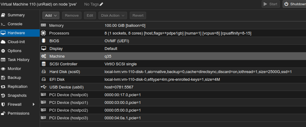

In all seriousness, this seems like a.. bug ?? ...and I’d like to ask the community for suggestions. I allocated 100GB of dedicated 1G HugePages to unRaid, and CPU affinity is set to 8-15 in Proxmox using "host" as the CPU setting. I passthrough the onboard 8 Port sata controller, an asm1166 6 port pcie card and a 1TB nvme that I will use for ZFS L2ARC, it's just not part of my zfs pool atm. I’m not using a Proxmox network bridge. My Proxmox server also functions as my router (OPNsense), so I’ve opted for an Intel X710-T2L to enable SR-IOV and use virtual network cards on all my VMs.

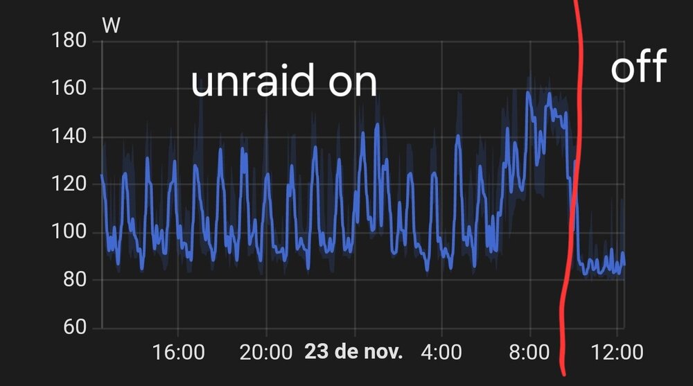

My Proxmox server suffers from the same symptom. When the Unraid VM is turned off, the entire cluster's consumption stays around 80W. When Unraid is running, consumption fluctuates between 80W and 120W. I've already tried several things to reduce it but nothing works.
Edited by Quejo
