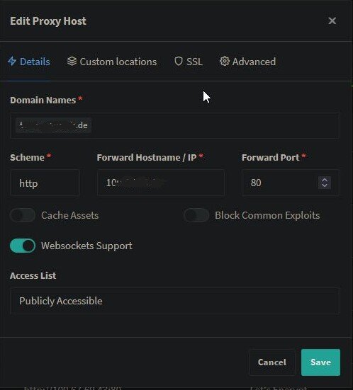

  • So i created the subdomains as DNS only at Cloudflare
  • configured Nginx (with custom IP to prevent port jazz) to 'force SSL' and 'use a DNS challenge' for the Cloudflare API token
  • successfully created the SLL certs
  • restarted Nginx, restarted unraid

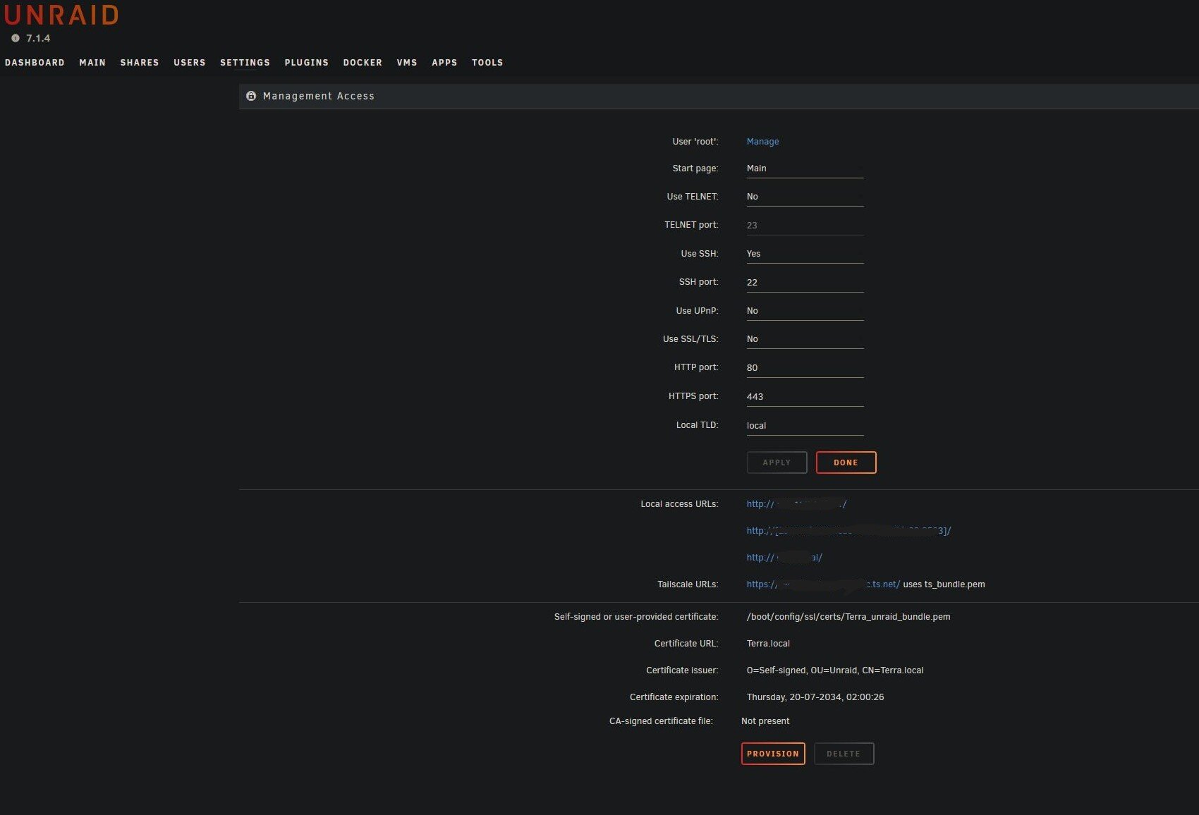

My problem:

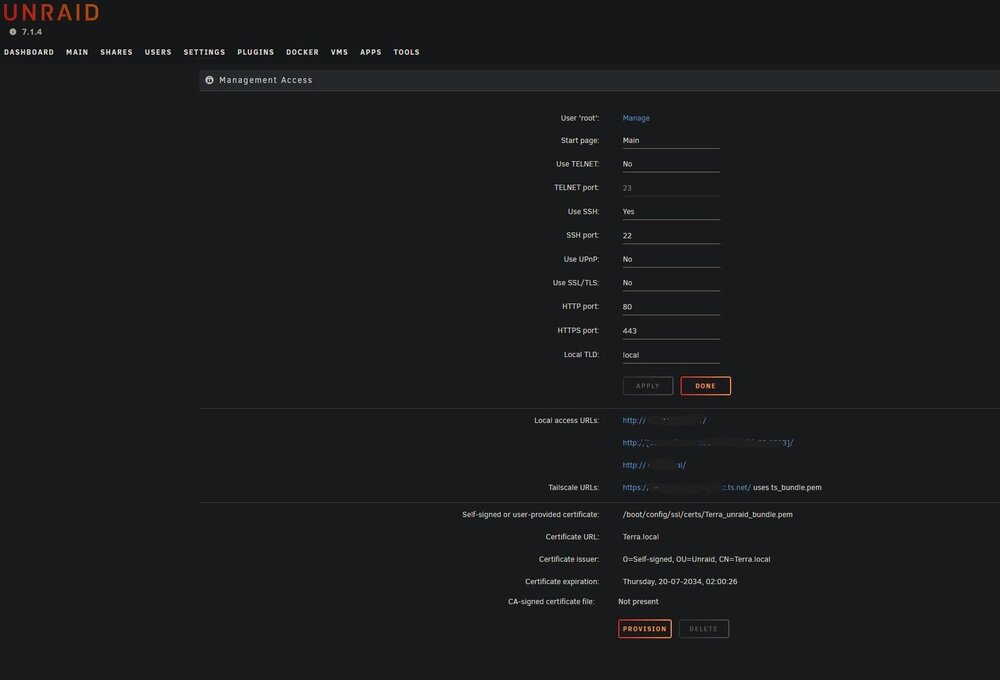

After deactivating HTTPS on the tailscale config site, the certs on my unraid machine did not disappear. Even after deleting them manually, the unraid server is still in full tailscale https mode. I can't remove the only https link in the MANGAMENT ACCESS tab that's still there from my tailscale era.
The subdomains at cloudflare (I'm using two unraid servers having the same issue) are correctly configured as DNS only, Nginx is configured properly, the SSL certificates are valid, but the browser says the subdomain connection is insecure/no SSL. When using the old tailscale domain, the connection is valid, although the cert was manually deleted and the tailscale config has https disabled. I hard refreshed the browser, the issue persists.
I'm out of ideas. How can i get rid of the old tailscale https and move to the correctly configured subdomain/tailscale IP path with the browser accepting the correctly created Nginx certificate and showing no validation issues? I can't see any mistake here.
