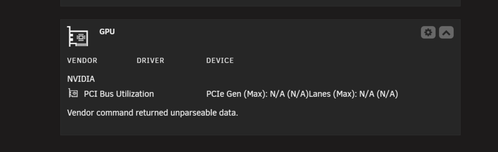

November 2, 20251 yr Hi all, I looked around about why this might happen and possible fixes. Can't figure where to start with this ... I need the collective knowlege of you fine people.Got a GTX1660, using Nvidia Drivers and a certain patch applied at first array start only. (Setup worked flawlessly for years, issue appeared ~ 6-8 months ago)All works fine for a good while, then randomly, my gpu is not found.It disapears from my Transcode GPU choices in Emby.GPU Statistics throws a "Vendor command returned unparseable data."nvivia-smi returns "No devices were found"Tools > System devicesI still got :IOMMU group 2:[8086:1901] 00:01.0 PCI bridge: Intel Corporation 6th-10th Gen Core Processor PCIe Controller (x16) (rev 07)[10de:2184] 01:00.0 VGA compatible controller: NVIDIA Corporation TU116 [GeForce GTX 1660] (rev a1)[10de:1aeb] 01:00.1 Audio device: NVIDIA Corporation TU116 High Definition Audio Controller (rev a1)[10de:1aec] 01:00.2 USB controller: NVIDIA Corporation TU116 USB 3.1 Host Controller (rev a1)Bus 003 Device 001 Port 3-0 ID 1d6b:0002 Linux Foundation 2.0 root hubBus 004 Device 001 Port 4-0 ID 1d6b:0003 Linux Foundation 3.0 root hub[10de:1aed] 01:00.3 Serial bus controller: NVIDIA Corporation TU116 USB Type-C UCSI Controller (rev a1)After a simple software reboot, everything comes back and work fine.I attached anonymized diagnostics untheran-diagnostics-20251101-2135.zip

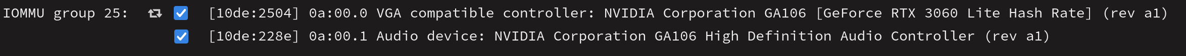

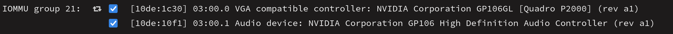

November 2, 20251 yr I am also having the exact same issue but my is happening more frequently about once a week. I am getting all of the same symptoms. The odd thing is it is only happening with my 3060 used for Ollama, My p2000 for encoding and other random tasks does not every do it. This started happening about a month ago or so. Both video cards are always still visible in devices but I am unable to use the 3060 when this happens. I did follow the an old SpaceInvader video for the very old AMD bug and the script did work for my card and it did come back after the sleep cycle was completed. Not sure if that helps or not. raidered-diagnostics-20251101-2052.zip
