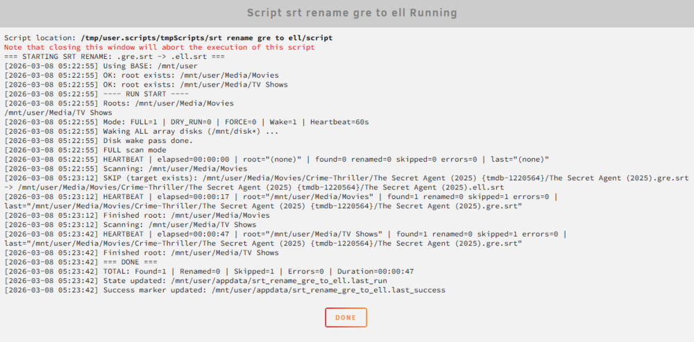

Recommended first run: Set Script Arguments to --dry-run and check the log at the path defined in LOG.
📋 What gets logged
Each run produces entries like:
[2025-03-08 14:00:01] ---- RUN START ----
[2025-03-08 14:00:01] Mode: FULL=1 | DRY_RUN=0 | FORCE=0 | Wake=1 | Heartbeat=60s
[2025-03-08 14:01:03] Renamed: /mnt/user/Media/Movies/Foo (2020)/Foo.gre.srt -> Foo.ell.srt
[2025-03-08 14:02:00] HEARTBEAT | elapsed=00:02:00 | found=145 renamed=12 skipped=3 errors=0
[2025-03-08 14:05:22] === DONE ===
[2025-03-08 14:05:22] TOTAL: Found=892 | Renamed=47 | Skipped=5 | Errors=0 | Duration=00:05:21
