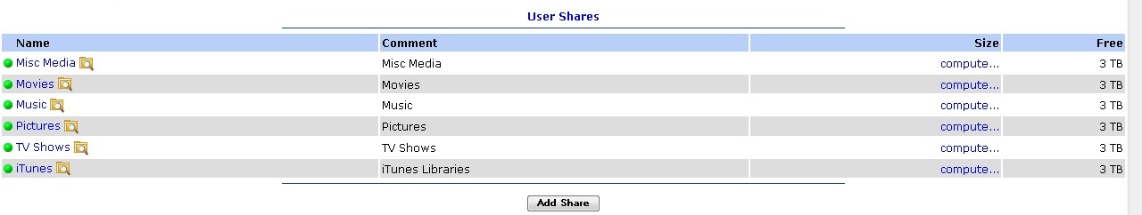

I must be an idiot or something because I'm having horrendous problems getting a new disk installed.  After receiving a bunch of help and finally getting the drive added to the array, unRAID refuses to use the new disk.
I have these shares:
  • Movies
  • TV Shows
  • Music
  • iTunes
  • Misc Media
  • Pictures
The shares that get used the most are TV Shows and Movies
Both shares are set to Split Level 2 and High Water.  Neither share uses Min. Free Space, nor do I use any Include or Exclude.  According to the Wiki, the High Water uses a cut off of 60GB on each disk before moving to the next disk.  My two old drives have 37.7GB and 56.1GB of free space.  The new drive is listed as having 3TB of free space.
But every time I try and copy something into the share Movies or TV Shows, it starts putting it on the drive with 56GB of free space and not the one with 3TB.
What am I doing wrong?

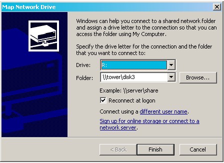

Excuse my ignorance, but how do I create the shares on a specific disk?
Since I know you're using Windows Explorer.  Map the disk share to your network, and then create the top level folder...ie "Movies"

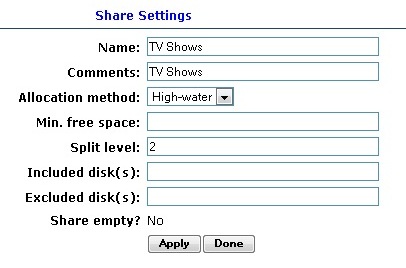

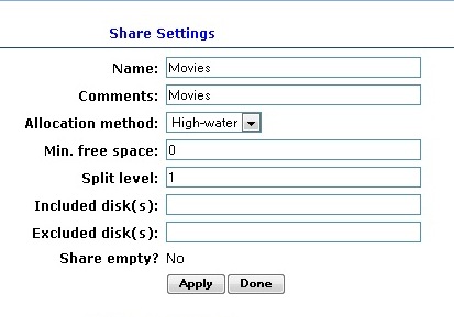

then it is time to post specific screen shots of your share settings AND more importantly, the directory hierarchy you are attempting to copy to under Movies and TV Shows..
It sounds as if you are attempting to copy to a level 3 directory.  (and it only exists on an existing drive, so it will never use the new drive)

You are awesome!  I went to \\tower\disk3 and created all 6 shares.  Grabbed a movie from my desktop, navigated to \\tower, dropped it into the Movies user share and viola' it's now copying to the drive with 3TB of free space.  Thank you so much.

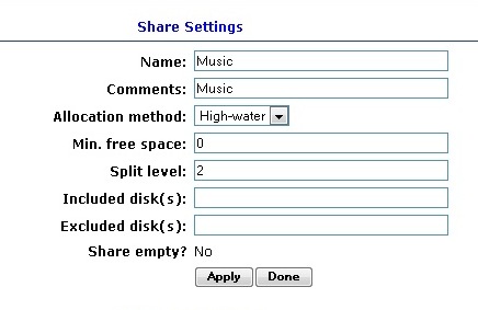

Set it to your desired level in the UI, Min. Free Space
http://lime-technology.com/wiki/index.php/Un-Official_UnRAID_Manual#Min._Free_Space
<Set to "0" in your Shares 2.jpg in your post>

Hopefully this helps.  I think I have things correct as far as split-level goes.  If I'm reading this right, the Moves share should keep each individual movie together on the same drive.
-Movies
--Movie Name
---Movie.m2ts
The TV Show share should keep each season together
Which share should I use?  I don't have one top level share like they do in the picture where is says "Media".  For me the shares "Movies", "TV Shows", "Music", etc are the top level.
Set the free space the same for every share. This will keep the disks that free, if it is allowed by the split level. Remember, split level over-rides all other settings as far as when to choose a different disk.
You Music share should use split level = 1 to keep each artist together.
