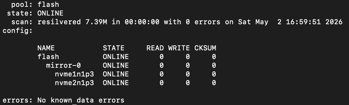

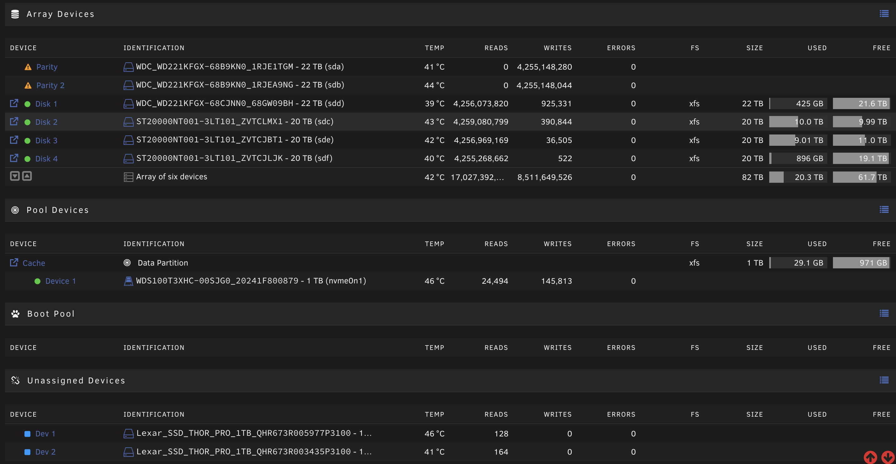

Prior to 7.3.0 stable I was running rc.1. I had moved to internal boot and TPM licensing. I installed 2 new matching 1Tb NVMe specifically for this purpose. I used the included tool to setup a mirrored 128 gig partition for boot. I then created a second btrfs partition using the remaining space. After updating to stable, the boot pool list is empty and the drives show as unassigned.
zpool status below:
Screenshot of Main tab:

Solved by mlaurie
I have figured it out.
In 7.3.0 rc.1 I created a pool named mirrored_pool using the remaining space on the boot drives. Apparently in 7.3.0 stable this became a reserved name which wreaked havok.
ssh root@servername/ip
cd /boot/config/pools
rm mirrored_pool.cfg
Back in your UnRAID gui.
Stop the array
Create a new pool with 2 slots. I chose server name_mirrored_pool
assign the drives.
Everything appears to have come back. Looks like the entire issue is that I just so happened to use a reserved name for the pool that wasn't reserved when I made the pool.
