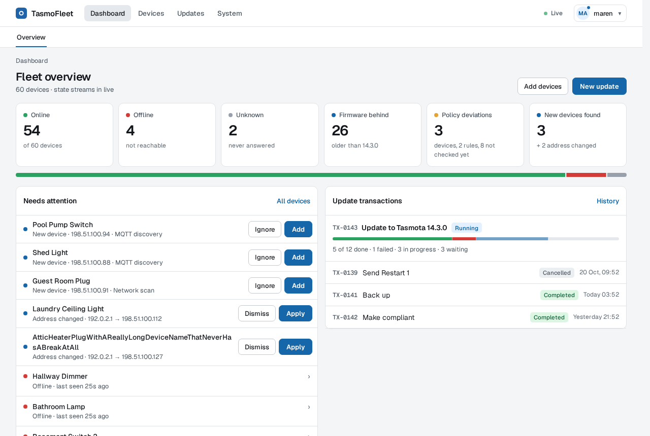

Dashboard (simulated devices)

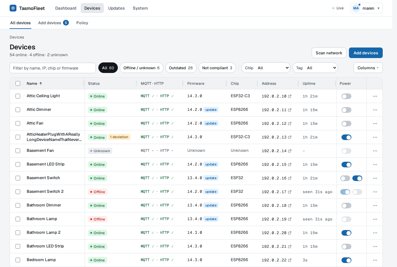

Device list (simulated devices)
