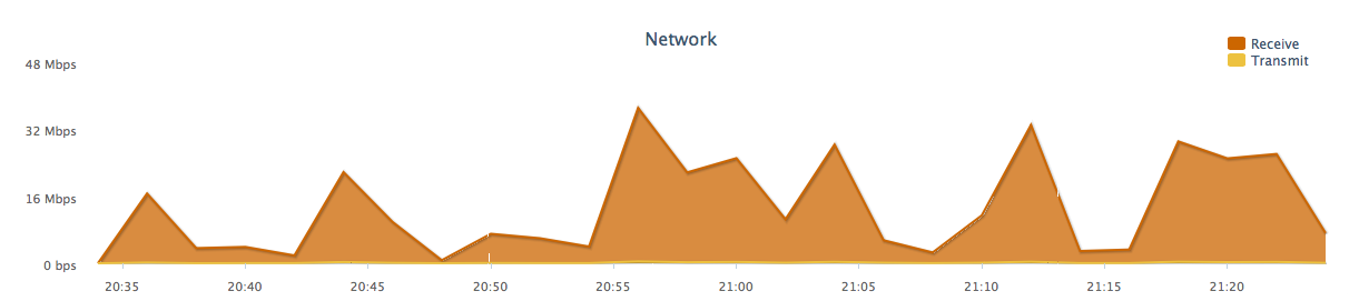

August 5, 201214 yr Hi, Newbie here so go easy please! Wanting to fill up my new server with around 6TB of data - once this 6TB is added I'll be adding a 1TB cache drive. All is great until we're around 20GB into the transfer then things start slowing down. My transfer speeds to a brand new array are erratic. My peak is 55-60MB/s, but the lowest can be as low as 2-300KB/s. I transferred 22GB worth of MKV files (so lots of large ones is what I mean) at the peak rate, but then the transfer speed dropped down to the lowest. It's currently hovering between 600k and 2MB/s. See screenshot for what I mean... My hardware is as follows: unRAID Server Pro v5 rc5-8168 Asus P8H77-V LE, BIOS 0237 Intel i3 2120 3.3ghz 8GB RAM TX750W Corsair PSU 1x Supermicro SAS-AOC-SASLP-MV8 2x 3tb drives, 1x 1.5tb and 1x 1tb drives. All precleared successfully (reports attached for what it's worth). What have I done before posting? - I pre-cleared all drives on 2 passes. - I've switched from Unraid rc5 to rc5-8168 without any noticable difference (currently running rc5-8168). - Used two different gigabit switches (identical results) - Swapped all cables several times (identical results) - searched the forums - fiddled around with MTU jumbo frames (identical results, back at default now) Output of ethtool eth0 is: Supported ports: [ TP ] Supported link modes: 10baseT/Half 10baseT/Full 100baseT/Half 100baseT/Full 1000baseT/Full Supports auto-negotiation: Yes Advertised link modes: 10baseT/Half 10baseT/Full 100baseT/Half 100baseT/Full 1000baseT/Full Advertised pause frame use: Symmetric Receive-only Advertised auto-negotiation: Yes Speed: 1000Mb/s Duplex: Full Port: Twisted Pair PHYAD: 0 Transceiver: internal Auto-negotiation: on MDI-X: Unknown Supports Wake-on: pumbg Wake-on: g Current message level: 0x00000033 (51) Link detected: yes Output from ifconfig is: eth0 Link encap:Ethernet HWaddr c8:60:00:9b:55:64 inet addr:10.0.0.2 Bcast:10.0.0.255 Mask:255.255.255.0 UP BROADCAST RUNNING MULTICAST MTU:1500 Metric:1 RX packets:597591 errors:0 dropped:0 overruns:0 frame:0 TX packets:158244 errors:0 dropped:0 overruns:0 carrier:0 collisions:0 txqueuelen:1000 RX bytes:897302441 (855.7 MiB) TX bytes:11382227 (10.8 MiB) Interrupt:43 Base address:0x2000 lo Link encap:Local Loopback inet addr:127.0.0.1 Mask:255.0.0.0 UP LOOPBACK RUNNING MTU:16436 Metric:1 RX packets:8 errors:0 dropped:0 overruns:0 frame:0 TX packets:8 errors:0 dropped:0 overruns:0 carrier:0 collisions:0 txqueuelen:0 RX bytes:560 (560.0 B) TX bytes:560 (560.0 B) I've not yet completed the initial parity sync (through sheer impatience!). Would this resolve the issue most likely? Transfers being done over gigabit ethernet from a Windows 7 machine. Read transfer speeds are in excess of 80MBs so I don't suspect network hardware at fault here... Any help please? My gut feeling is that it's related to that initial parity sync? Please tell me I'm right!! syslog.txt preclear_reports.zip

August 5, 201214 yr Author just an update - have transferred several more files since earlier, one MKV file was 32GB in size. all was going fine until it hit the 22GB mark, transferred at 30MB/s, then suddenly like it hit a wall BAM - down to a 2-300KB/s. Parity sync is still ongoing but I'm curious as to whether this is normal or not...
August 6, 201214 yr Author FYI - parity sync finished this morning. so far am 824GB into my 2.5TB transfer and have seen steady 30-50MB/s write speeds. don't want to count my chickens yet but it looks like waiting for the parity sync was the answer.
