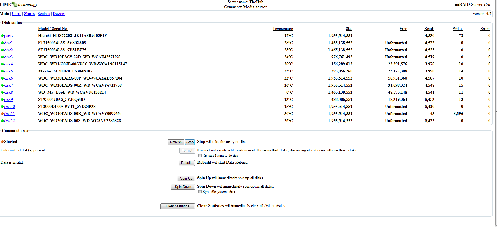

When I went to the webgui to start the array this is what I got... multiple disks now saying unformatted when in fact they work just fine.
It was running a parity sync, but I stopped it as I'm guessing it would only lead to another corrupt disk since I now have six unformatted disks instead of one.
Hopefully I'm not F^&*ed
OK, what has probably happened is that unRAID has changed the partition on all the disks to match whatever the setting is on the config page. Not all is lost, it's fairly easy to fix.
Joe L. has created a utility called unraid_partition_disk.sh as he already mentioned in a previous post. Use this and change the partition on the unformatted disks except for disk11. It's not formatted because it's blank.
Here are posts describing it.
http://lime-technology.com/forum/index.php?topic=15385.msg144822#msg144822
http://lime-technology.com/forum/index.php?topic=5072.msg47122#msg47122
Basically, I would do this. Click on each disk that isn't formatted on the main page. The screeen will say if it's MBR unaligned or MBR 4k Aligned. It would even be better if you can recall if they should be one way or the other. They are all 2T drives so I'm guessing you started using the 4k aligned setting at some point and now the new flash has set them back to an unaligned partition. At any rate, you want to change it to the opposite. Use the following commands to change it.
If unaligned - unraid_partition_disk.sh -A -p /dev/sdX
if 4k aligned - unraid_partition_disk.sh -p /dev/sdX
The X is replaced with the devices, ie on your devices page you'll see a sda, sdb, sdc etc for each disk.
If you want more confidence in this, then read through those threads because they go through reading the start of the disks to confirm where the partition should start.
The good news is that it appears that the data rebuild had started and was working. Look at the disk reads and writes and you'll see what I mean. It was reading the other disks and writing to 11 as it rebuilt it. The bad news is that it was working on the wrong data since the partitions are messed up. So, fix the partitions and then try the rebuild again. It says hit the button to rebuild the disk so it seems to have acknowledged that the rebuild on disk11 has failed. that means you should be able to just let it go from here on out. Read the main page before starting the array each time and if it's not saying the right thing don't start the array.

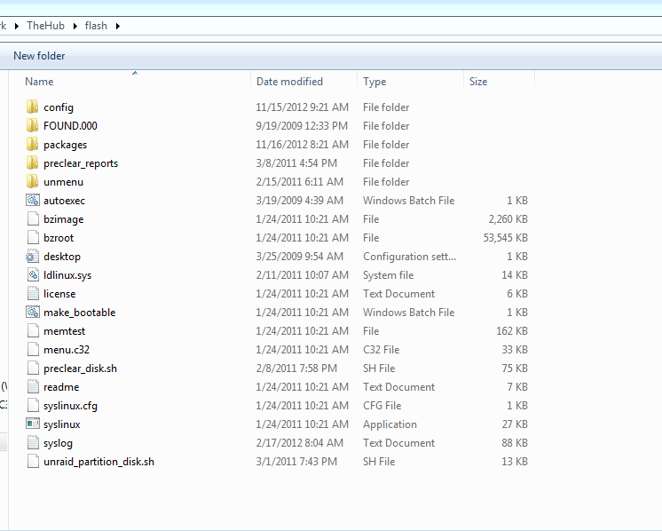

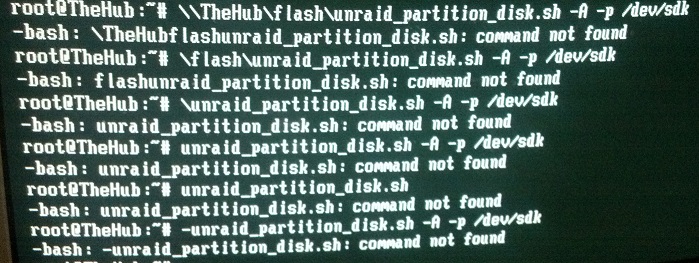

So all my disks that claim to be unformatted are unaligned.  So when I went to run the script it's telling me command not found.  I placed the .ch file into the flash directory as his instructions specify.  What am I doing wrong?
The flash drive is at /boot on the server. In other words, do a cd /boot first before running it or use /boot/unraid_partition.sh to run it.
The flash drive is at /boot on the server. In other words, do a cd /flash first before running it or use /flash/unraid_partition.sh to run it.
No...  From windows it is known as \\tower\flash
In linux it is mounted at /boot
so....
cd /boot
then
Or type
/boot/unraid_partition_disk.sh -A -p /dev/sdX
Crap, I thought /boot and then typed /flash. It'd be nice it was named the same on both.
