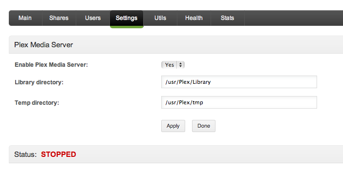

I'm very much a newbie to unraid, and I have had plex working, but for some reason now it can't seem to get it running. When I look at settings on the web gui all i can see is the screen shot attached

You need to have it store your library in a location different from where you have it in that screen shot. Since you don't have a cache drive you'll have to store it on the array. Where you have your library location set now is in RAM and your whole library will be lost upon a reboot. The other thing storing it in RAM, and possibly what is leading you it continually crashing, is that a Plex library takes up a lot of storage. If it's stored in RAM that is going to use up all your RAM and will cause other applications to close as Plex requests more and more RAM to store your library. For instance my Plex library is 3.5GB.
