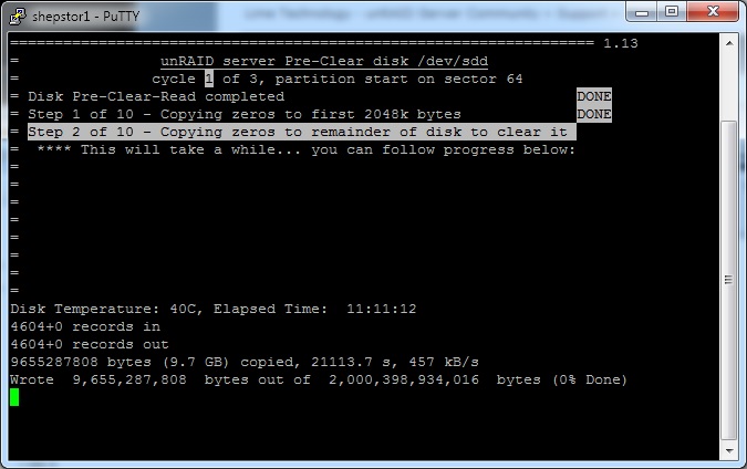

The preclear phase 1 read speed is fine, anywhere from 100 to 150MB per second.
Write speed though is horrible, just 500KB per second.
First I thought it was because I was doing multiple preclears in parallel, but I rebooted the server and did just one and I still get the same performance.
Screenshot attached of the preclear_disk.sh status.
So I looked in the syslog and I see the following coming out about once a second, I have to think this is either contributing or point to the root cause. However it's been a while since I used linux and other than it looks like I have a problem I don't know what it's telling me.
Any suggestions would be appreciated. Thanks.

Well, after doing more research I found the thread about issues with the current kernel when using more than 4Gig ram, so I used the 4G boot option on unRaid and am now writing in the preclear at ~140Mb/s.
I have marked this issue solved.
