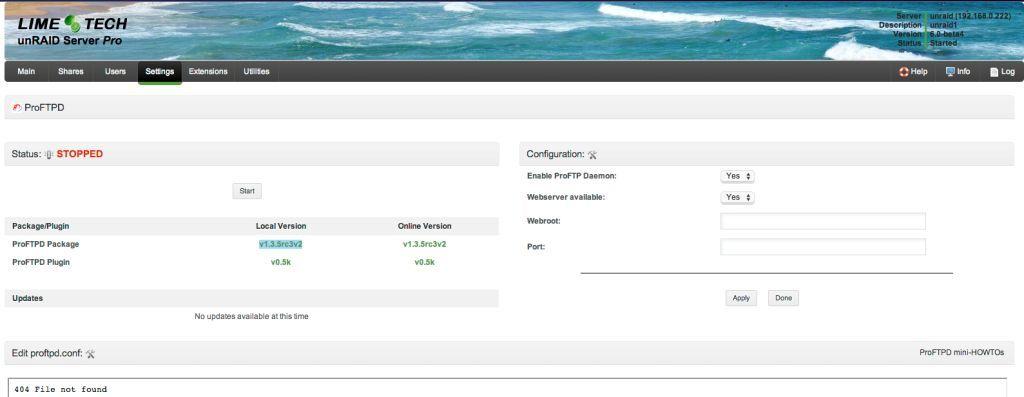

I am running 6.0 BETA 4, and I am trying to get Proftpd installed.  The problem I have in that I have tried many times to install, and now I would like to clean up and try again.  I have tried both ways, that I know of, to install.  I added the file to the plughins directory and restarted.  I also tried copying the TGZ files to /boot/packages and running it that way.  So now I have proftpd files all over the place, and I 1st need to clean up and start fresh, any ideas?
I have the proftpd.conf file in the /etc directory, and I also have the GCC addon installed, so I can complie if I need to.
Any and all help is appreciated.  I have the GUI showing thev1.3.5rc3v2 in installed, but it will not start.
