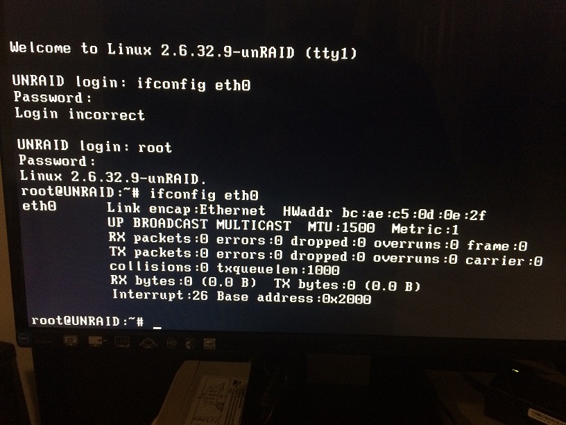

I ran another ethernet cable over to the unraid and that didn't help either.  By far I am not a Linux expert, so bare with me.  I ran an ifconfig eth0  See attachment for the results...
I just checked the network lights on the back of the motherboard (ASUS M4A785-M) and I don't see either of the lights by the ethernet cable port coming on at all.  Guessing the onboard ethernet maybe died?
Well, I have no explanation for it but I did the old clear the cmos and that did the trick.
