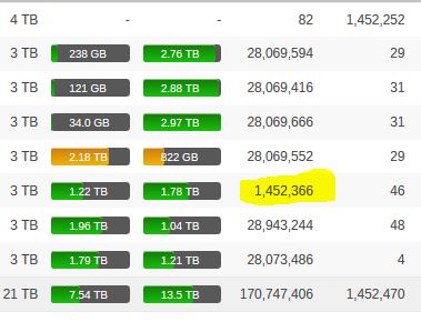

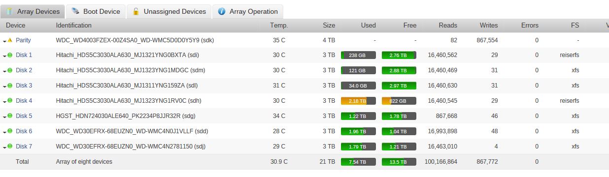

Anyway, I seem to have the hardware troubles cleared, but still getting an odd behavior. I am rebuilding parity (after doing a 'New Config') onto a new 4tb drive(all data drives are 3tb). Speeds are running about 5 MB/s where i usually see about 100MB/s.  Disk 5 is a 7200rpm HGST NAS and is showing only about 5% of the reads as all the other drives, but is showing no errors on smart reports. The parity rebuild says it will take about 8 days, which is terrible.

What i am seeing now is different. there is no change at all in the speed, it stays right at 5.3MB for 2 days now. Its so frustrating to watch!
I added an updated screenshot. It just shows how much of a difference there is between drives.
