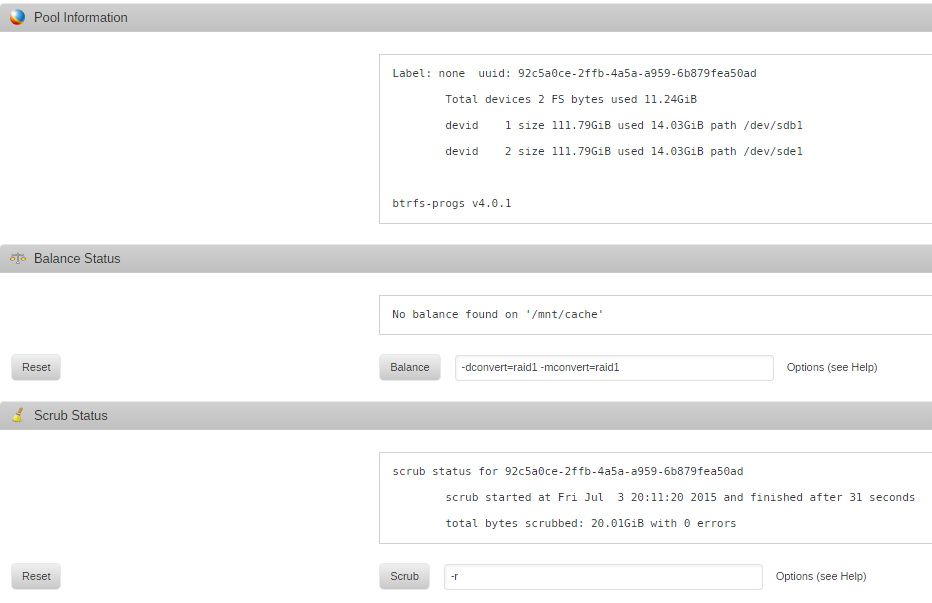

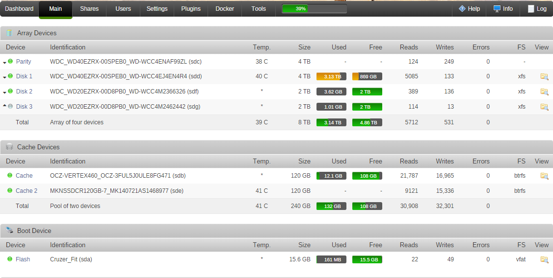

July 4, 201511 yr Author I have added the second cache drive, rebooted machine, gone to the first cache device's page and run the 'balance' and the 'scrub' commands. Still, only the first device looks like it's being used in the cache pool (at least what the GUI seems to me to indicate). Is there something I'm doing wrong here? Please see attached screen captures. Ari
July 13, 201511 yr Author Again, I'm not sure the second cache drive has been added properly to unRAID. Please see the images above from the web UI, but here's the command line output: root@Server:~# df -aTh Filesystem Type Size Used Avail Use% Mounted on tmpfs tmpfs 128M 3.2M 125M 3% /var/log proc proc 0 0 0 - /proc sysfs sysfs 0 0 0 - /sys /dev/sda1 vfat 15G 146M 15G 1% /boot /dev/md1 xfs 3.7T 2.9T 813G 79% /mnt/disk1 /dev/md2 xfs 1.9T 17G 1.9T 1% /mnt/disk2 /dev/md3 xfs 1.9T 33M 1.9T 1% /mnt/disk3 /dev/sde1 btrfs 112G 11G 101G 10% /mnt/cache shfs fuse.shfs 7.3T 2.9T 4.5T 40% /mnt/user0 shfs fuse.shfs 7.4T 2.9T 4.6T 39% /mnt/user /dev/loop0 btrfs 10G 1.3G 7.0G 16% /var/lib/docker I only see the one cache mounted. Am I missing something here, or is only one cache drive being used? How do I fix this? Thank you for any help, Ari
July 13, 201511 yr I have no experience myself here, so hopefully someone else will correct me, but I think what you are showing above looks right. You have set up a Cache Pool, not a Cache drive, so you would have 120GB total in a RAID1 setup. I believe for the pool, it reports all Cache usage and numbers on the first line only, because they aren't separate logical drives here any more, they are a single pool. The numbers all look right.
