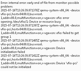

Here is the error I am getting.
but I have to 7870s and I would like to give one to two of my VMs.

Sorry for the multiple posts, as I said I am still learning KVM and where everything is.  Here is what the log file says on the second VM when I try to start it.
2015-07-16 14:43:40.206+0000: starting up libvirt version: 1.2.15, qemu version: 2.3.0
Domain id=40 is tainted: high-privileges
Domain id=40 is tainted: custom-argv
Domain id=40 is tainted: host-cpu
char device redirected to /dev/pts/1 (label charserial0)
2015-07-16T14:43:41.403077Z qemu-system-x86_64: -device vfio-pci,host=03:00.0,bus=pcie.0,multifunction=on,x-vga=on: vfio: error opening /dev/vfio/1: Device or resource busy
2015-07-16T14:43:41.403102Z qemu-system-x86_64: -device vfio-pci,host=03:00.0,bus=pcie.0,multifunction=on,x-vga=on: vfio: failed to get group 1
2015-07-16T14:43:41.403126Z qemu-system-x86_64: -device vfio-pci,host=03:00.0,bus=pcie.0,multifunction=on,x-vga=on: Device initialization failed
2015-07-16T14:43:41.403141Z qemu-system-x86_64: -device vfio-pci,host=03:00.0,bus=pcie.0,multifunction=on,x-vga=on: Device 'vfio-pci' could not be initialized
2015-07-16 14:43:41.845+0000: shutting down
