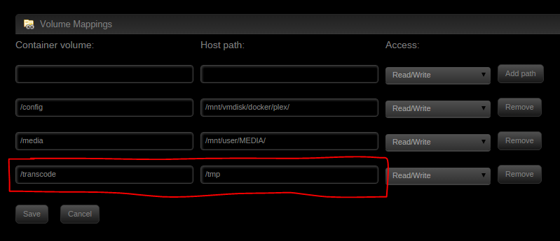

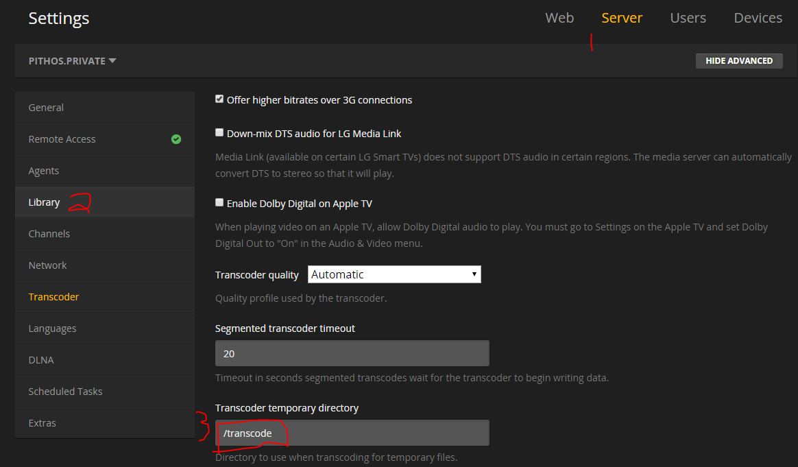

I would try changing the transcoder directory to unRAID's memory if you have not already. Somewhere there is a post from JonP about this but I cannot find it so I am going from memory.
1. Go to your docker page and edit your plex app
2. See picture 1 and add that your your plex app settings
3. turn on plex and then go to setting -> server and change "Transcoder temporary directory" to /transcode (Picture 2)
4. Save changes and see if that fixes the problem.
It probably started happening when I upgraded to Unraid 6 stable from Unraid 5.  I will try the transcode to RAM and let you know.  Thanks
Moving transcode to RAM didnt help my trap divide error.
