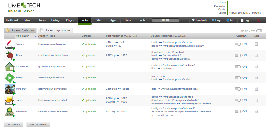

Using version 1.6.8 GUI started reporting information incorrectly.  Is there a way to reset without rebooting?  I believe it is related to the following that is showing up in my log:

Screen shots attached, thanks

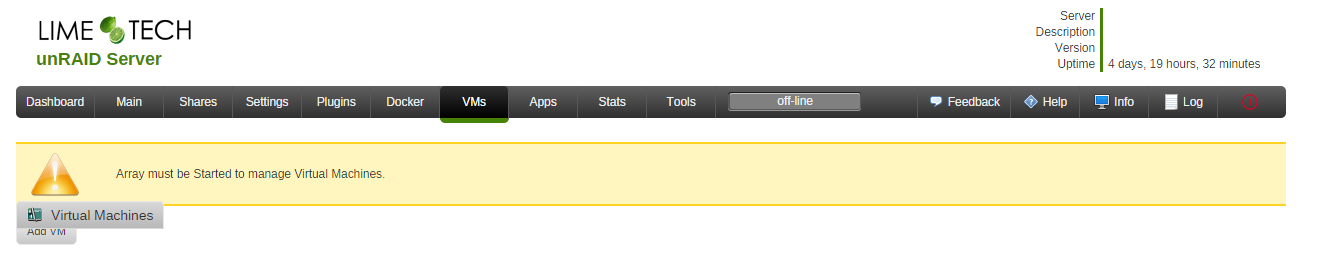

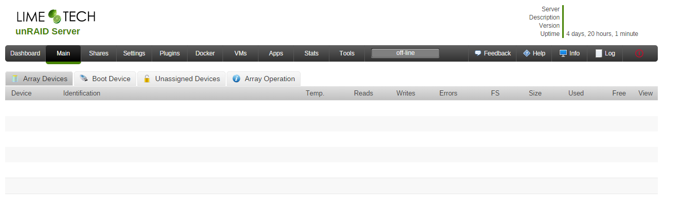

I removed the unassigned disk plugin and the GUI started responding again.  Then noticed that my dual 240 g cache drives were showing as only a couple of gig in space left as opposed to the 178 g that is typically free.  In a few minutes the space was gone and am now back to nothing showing on the GUI and an indication that the array is down.  I stopped all dockers and VMs and can still access the shares and data on my disks.  On the appdata share which resides on the cache drives I can see some of the folders but no data is being shown.
