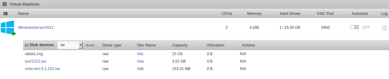

When I click on the VPC remote, I can log in but get the error message:
Boot failed: Not a bootable disk
Could not read from CDROM (code 004)
Connected to OEMU
This is my first vm set up.
I am between "Creating Your Windows VM page 44 and Loading the VirIO Drivers During Installation.
Suggestions?
Thanks in advance,
Bill
After searching for a solution, I found that one had to remake the iso file. So I went back to the install DVD and did the
'>>  dd if=/dev/cdrom of=/tmp/cdimg1.iso' thing to create a new iso file. Then the file was copied to the tower/ISO directory. Next I went into the xml file and  updated the source file. Finally I ran the VPC and it is now wanting to install Windows Server instead of getting a boot failed error.
