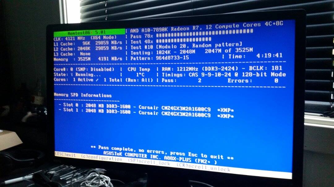

Number one step should be to make sure your RAM is fine, so run Memtest from the boot menu, several passes.
It's 2 passses and 82% on third, seems fine so far. Any other suggestions?
How many passes should I go for? Atleast the server isn't shutting down during this process
That's probably plenty for the memory.  If nothing else turns up, there's a better Memtest86 out there, not included here, sometimes finds issues this one doesn't.

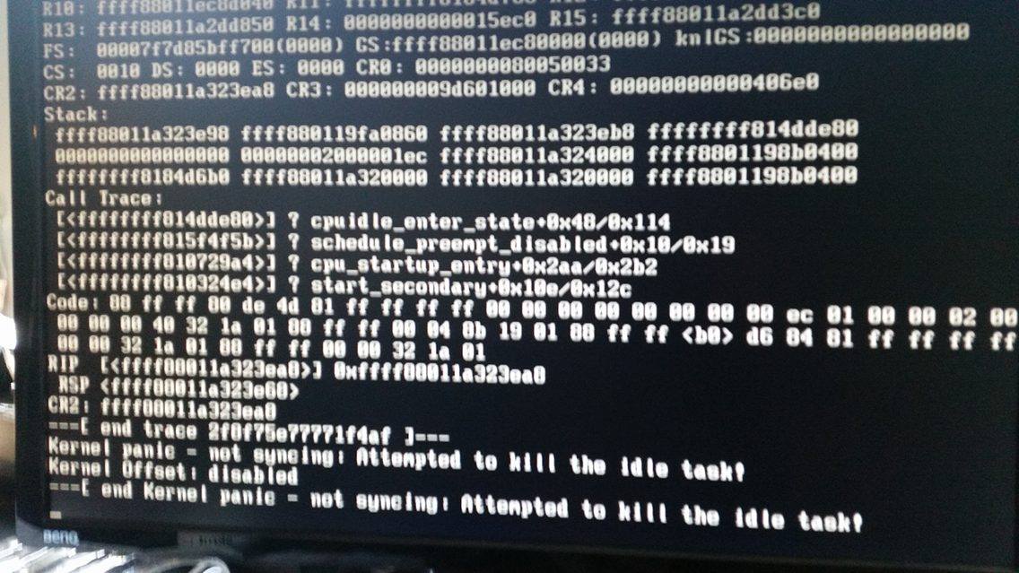

This is the picture when my CPU was overheating, so I dont think thats the problem now
On my screen now I keep getting this error
"grep: /etc/sensors.d/sensors.conf: No such file or directory"
