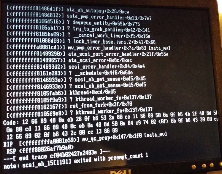

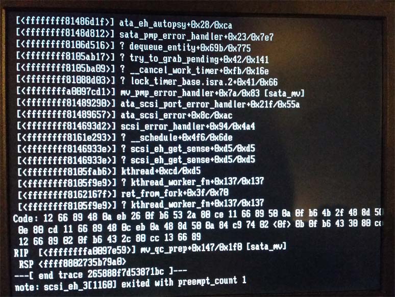

It does not get far enough to dump an error file to the flash, the MV8 bios's show the detection of all drives as normal. The point that the issue happens is just after it appears unraid goes through each drive. I have a video of the problem and a screen shot of the final error with the second screen shot with the cards moved down a slot.

Wow...after digging for hours, finally ended up being a drive in the array that detects fine, sounds fine, but the onboard drive controller causes something in either the controller driver or something deeper that caused the hard error. I have never seen a drive cause that much havoc on a system without showing symptoms first. The problem had me worried my backplane, motherboard/mem/proc that was going or something crazy like a bad sata cable.
With how many drives I have in the array, the easiest thing to do was pull half the drives, attempt boot, pull half of those, attempt boot....finally found it. In case it matters, it was a Seagate Barracude 3TB ST3000DM001 from 2013.

Sooo...researching sata_mv...it is a "rare bug" that I'm dancing around...From the sata_mv.c documentation...https://github.com/yandex/smart/blob/master/drivers/ata/sata_mv.c
44  * 80x1-B2 errata PCI#11:
45  *
46  * Users of the 6041/6081 Rev.B2 chips (current is C0)
47  * should be careful to insert those cards only onto PCI-X bus #0,
48  * and only in device slots 0..7, not higher.  The chips may not
49  * work correctly otherwise  (note: this is a pretty rare condition).
So now the question is how do I tell if I have Rev B2 chips or C0 chips...I have the Revision 3 version of the cards, and can't see anything on the chips with those designations. The latest bios is 1.0b and they've all been updated. I'll have to check if the cards are able to be on bus #0....I'm thinking they are all on bus 3 from the startup drive checks.

I just didn't run the last slots of each controller and it did work ok.
I've since moved the array to an entirely new mb/proc/mem/raid controller and didn't have to dance around it for too much longer.
